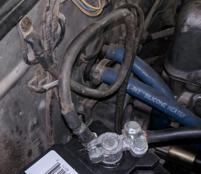

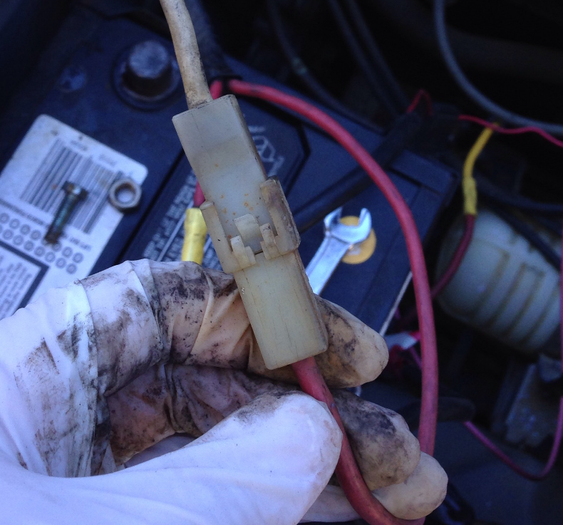

I don't see the other ground wire for the EFI system.  It could be attached somewhere else but it came from the factory with a plastic connector, to a pigtail at the battery negative post.  Somebody has monkeyed with yours, that battery cable to the firewall is way overkill.

  On 12/21/2017 at 10:52 PM, S30Driver said:
Yes,  you are right Cliff.    The circled EFI ground in your picture.
  On 12/21/2017 at 10:36 PM, S30Driver said:
If it were mine,  i'd be cleaning & brightening up that important ground on the intake manifold.    In the pix,  looks like it has not been touched.
  On 12/21/2017 at 10:58 PM, S30Driver said:
This one under the philips screw.
I cannot say how grateful I am for everyone's help. That was it. I cleaned that ground and it fired right up after getting all the air out of the fuel lines.
