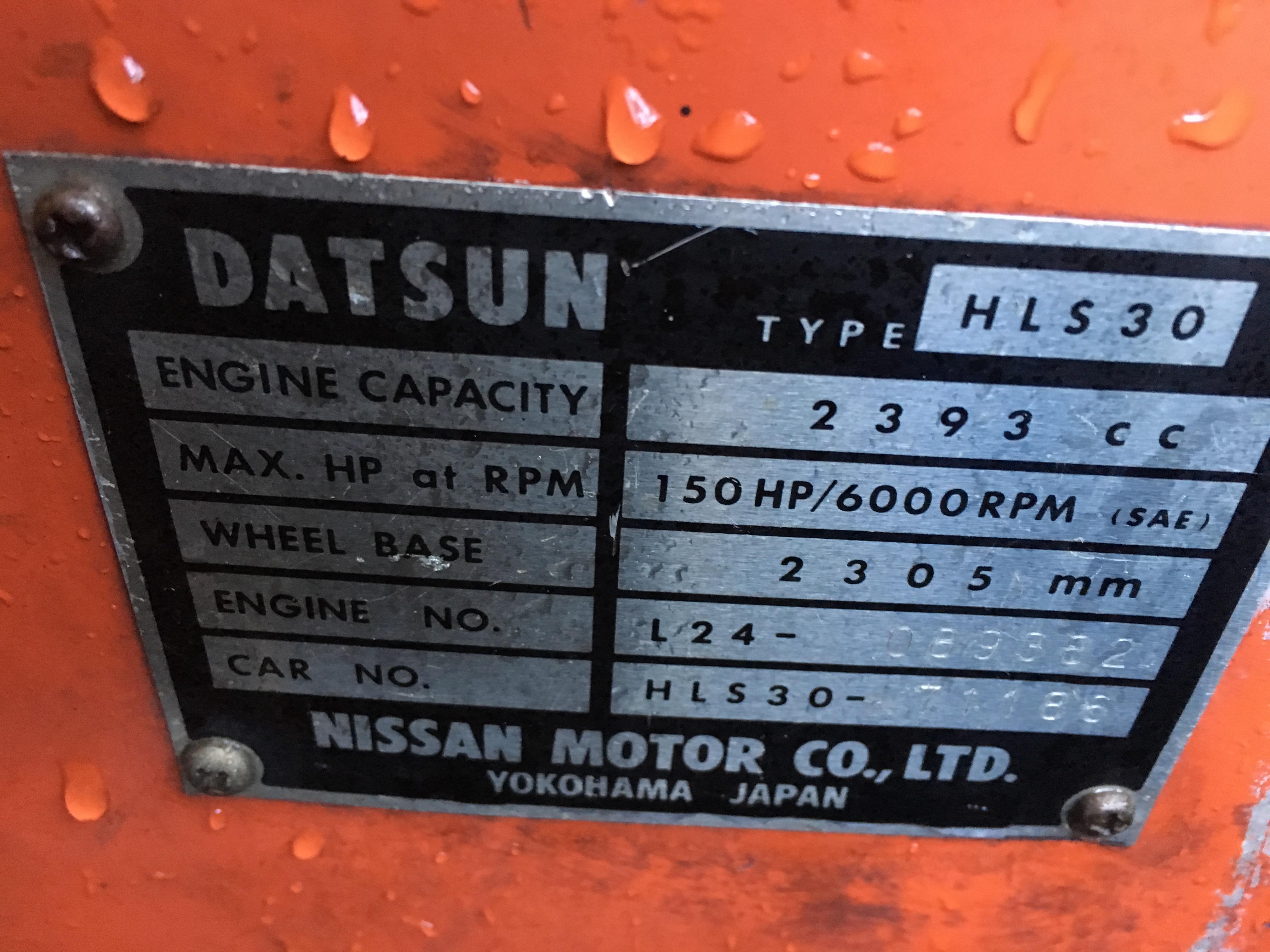

December 22, 20177 yr comment_538146 Post up the engine serial number from the tag in the engine bay. Maybe somebody out here has it. That greasy diff in your picture is an R180. You can use the same propeller shaft (Nissan called the half-shafts driveshafts and the driveshaft a propeller shaft) if you change transmissons. The throwout bearing collar must match the pressure plate. Not the transmission, or car. (sorry site) Best to take some measurements before installing. There's a bunch about it on this forum. Link to comment https://www.classiczcars.com/forums/topic/59215-372-datsun-240-z/?&page=2#findComment-538146 Share on other sites More sharing options...

December 22, 20177 yr Author comment_538153 089832 Link to comment https://www.classiczcars.com/forums/topic/59215-372-datsun-240-z/?&page=2#findComment-538153 Share on other sites More sharing options...
