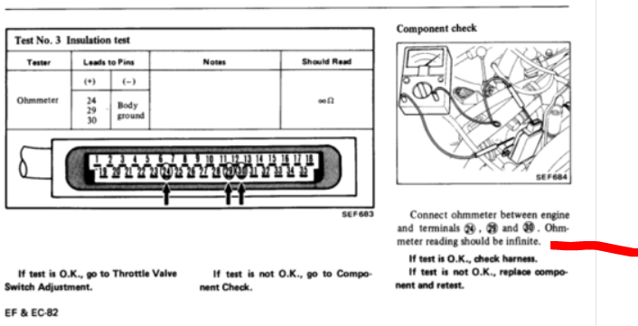

Zed Head Posted January 5, 2018 Share #49 Posted January 5, 2018 45 minutes ago, DC871F said: So if the TVS does not pass the insulation test, I'll at least need to replace. Would this cause my issue? Hard to say. It just means that one of the contacts is shorted to ground. It might just be a trail of dirt or a bent contact. You could probably take the cover off and clean it up and get it back in order. There's not much to them. Link to comment Share on other sites More sharing options...

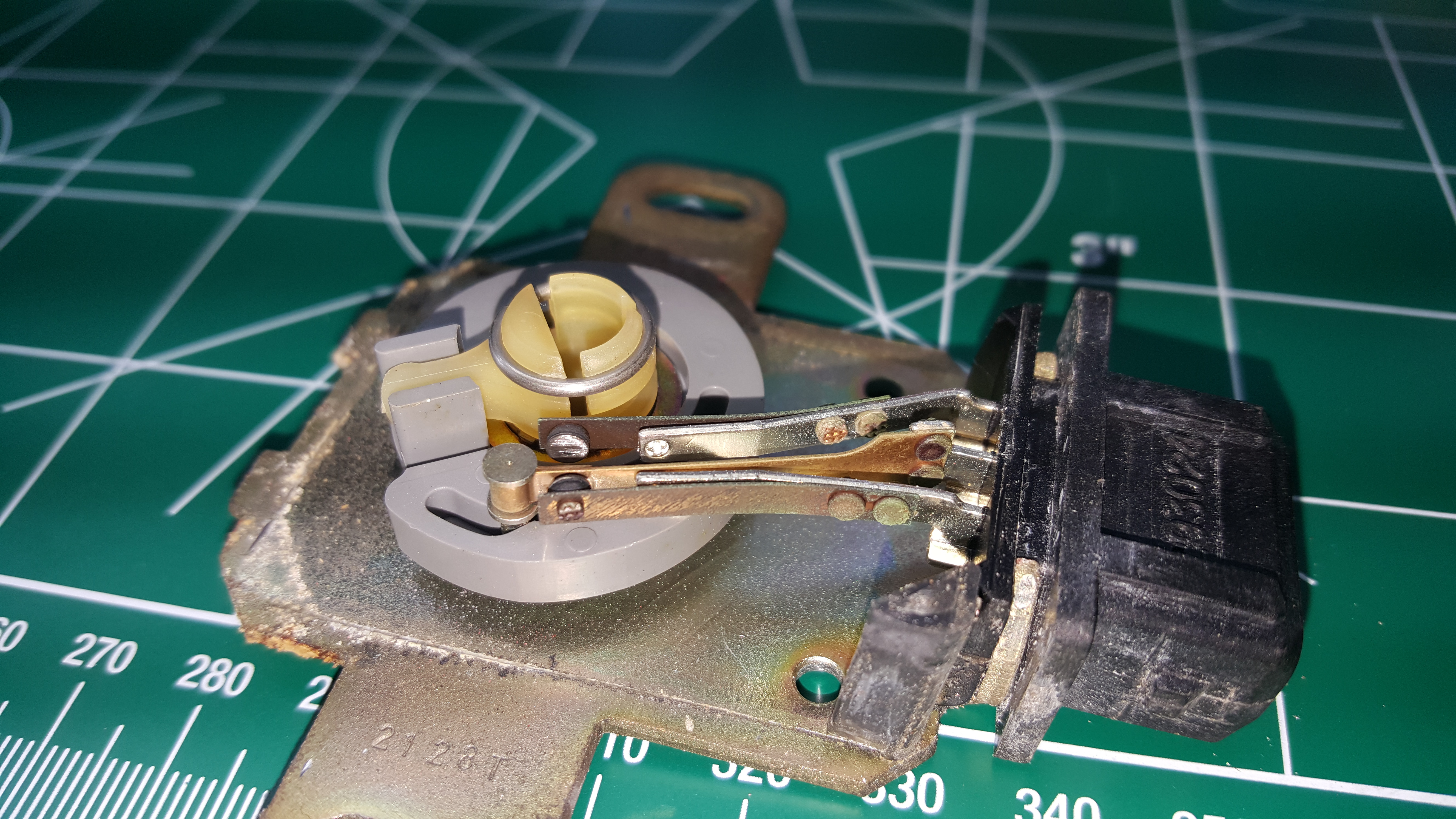

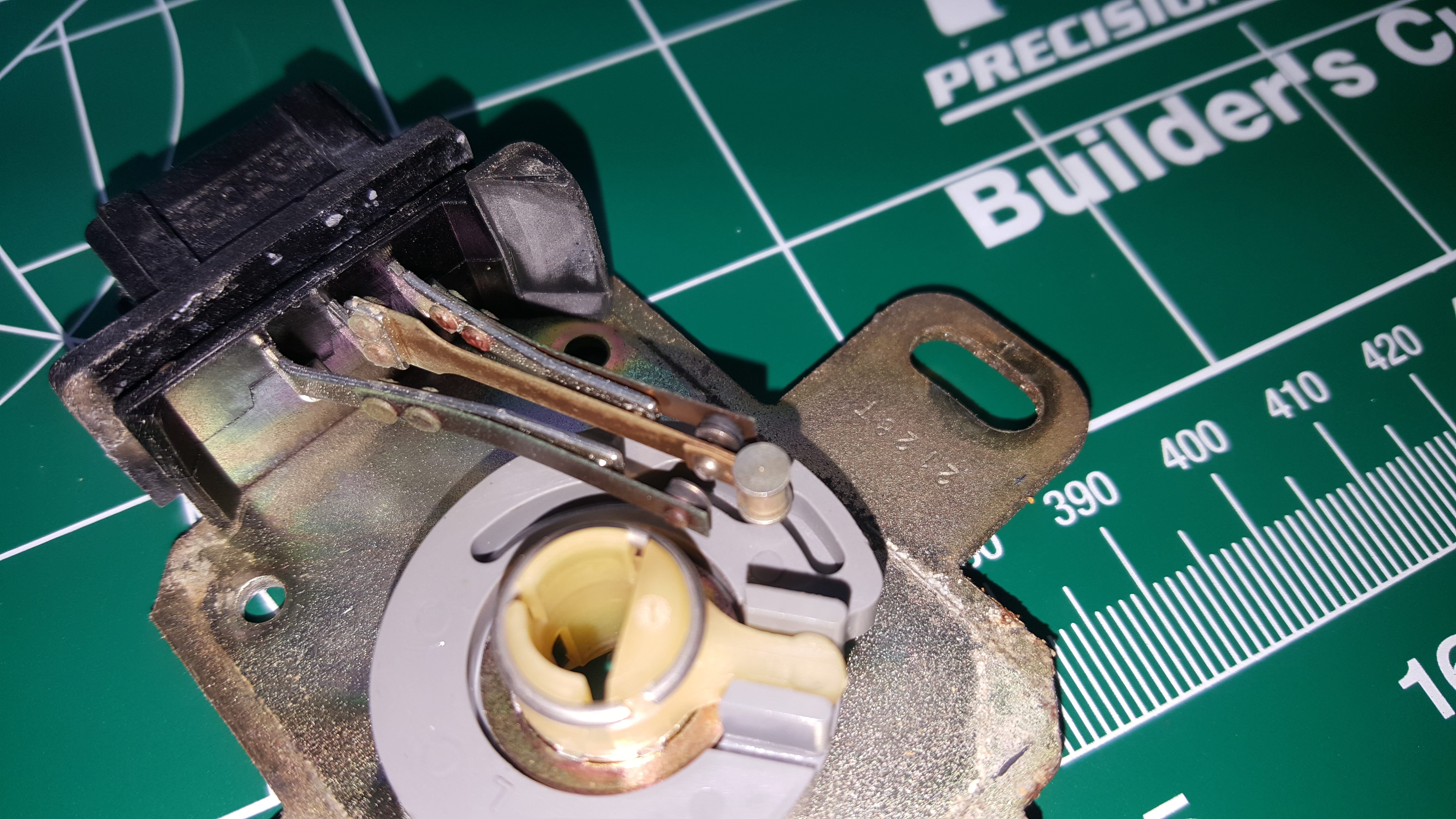

DC871F Posted January 5, 2018 Author Share #54 Posted January 5, 2018 (edited) TVS clean, no defects I could see. Filed the contacts, cleaned, reinstalled. Still cant get it to pass the insulator test on p.82, whatever that test means. Maybe theres a short in the 3 prong plug, but it looks intact. Just for future reference for anybody else. You have to drill the 2 small pop rivets to get the cover off. Edited January 5, 2018 by DC871F Link to comment Share on other sites More sharing options...
Zed Head Posted January 5, 2018 Share #55 Posted January 5, 2018 To be sure, can you describe how you did the test or show a picture? With the TVS off of the engine you'd have to connect one of your leads to the mounting plate, since that would be the path to ground. With everything installed you can run that test at the ECU connector by placing the negative lead on a good ground point then testing each of the three pins. And, to be very sure, you want no reading on your meter, like it's waiting for you to do something, or a very very high one, in ohms. If you had a test light it wouldn't light, or a test beeper it wouldn't beep. Link to comment Share on other sites More sharing options...
DC871F Posted January 6, 2018 Author Share #56 Posted January 6, 2018 I did the test with it on the car. It just showed an open on all three terminals, not "0", or a large resistance reading. The ground I used was good. Re-installed TVS, took car out and drove it about 90 miles. There is definitely a "sweet" spot on the accelerator peddle, about 75-80% full throttle to where the car will accelerate smoothly. Also, I think the fuel consumption is way high, but that will have to wait till tomorrow to confirm how much gas it used, it may be the fuel sender lying to me. I will go out tomorrow and do the insulator test through the ECU plug, since last time I did all 3 tests with the TVS disconnected. Link to comment Share on other sites More sharing options...
Zed Head Posted January 6, 2018 Share #57 Posted January 6, 2018 35 minutes ago, DC871F said: I did the test with it on the car. It just showed an open on all three terminals, I will go out tomorrow and do the insulator test through the ECU plug, since last time I did all 3 tests with the TVS disconnected. That's a "pass". Open circuit (infinite resistance) to ground, on all three. I'm guessing that your ECU connector test is going to be a "pass" also. The clamp on the return line might not work if the pump is struggling. The gauge will tell. Everything about the EFI electronics revolves around a controlled and predetermined fuel pressure. The ECU programming is based on it. Link to comment Share on other sites More sharing options...
DC871F Posted January 6, 2018 Author Share #58 Posted January 6, 2018 14 hours ago, Zed Head said: That's a "pass". Open circuit (infinite resistance) to ground, on all three. I'm guessing that your ECU connector test is going to be a "pass" also. The clamp on the return line might not work if the pump is struggling. The gauge will tell. Everything about the EFI electronics revolves around a controlled and predetermined fuel pressure. The ECU programming is based on it. Hey you're right. I was stuck in the frame of trying to read ground. Link to comment Share on other sites More sharing options...
