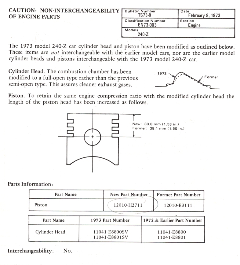

Thanks to @Lumens, I was able to scan the 1973 TSB Nissan Publication.
An interesting TSB on the E88 head change for Feb 1973 shows a larger combustion chamber where the piston extends into.
The compression height of the piston is longer so that the piston's deck height is greater by 0.7mm.  If you need more "squish" on a 240z with E31 or early E88, seek out these pistons!

In doing so I had the block bored out and fitted with .040 pistons. P/N 12010-H2716.
Not sure now if these are going to extend above the block deck.
I am also not sure what they mean by 'these items are not interchangeable.

The 1973 pistons go higher above the block (deck height) which causes them to protrude further up into the chambers. They can collide with a head that is not open enough. A thicker head gasket may help.

I plan to put my numbers matching L24 back in the car. This I think will help to sell it.
If you are concerned, you can always shave the pistons .010 inches or so. The crush on the stock head gasket is about .055 inches, so clearance should be adequate......I would think C/R should be bumped.....not the head lol......that's a good thing!

What I meant as far as measure is to install a piston in the block on the crankshaft and measure the ‘pop out’ of the block. I would be surprised if any additional thickness of HG would be necessary .
