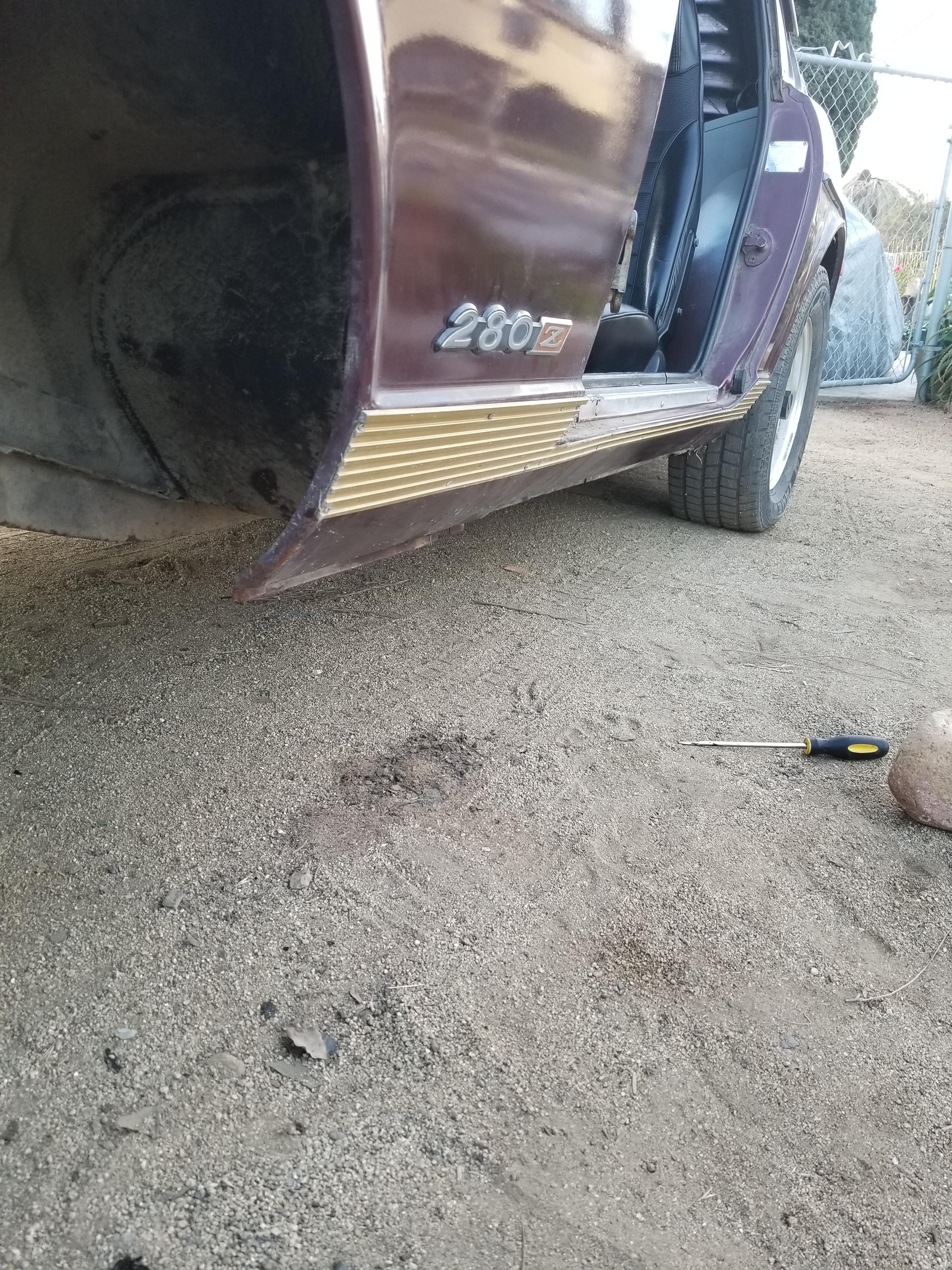

Posted January 3, 20187 yr comment_538878 Hey guys so I'm removing my fenders but this gold plate I can't seem to find a way to take it off without breaking it anyone know How? Is it screw on or more like a "be careful use a credit card" type of thing? Link to comment https://www.classiczcars.com/forums/topic/59293-fender-removal/ Share on other sites More sharing options...
January 3, 20187 yr comment_538883 Heat with hair dryer loosen glue perhaps. Link to comment https://www.classiczcars.com/forums/topic/59293-fender-removal/#findComment-538883 Share on other sites More sharing options...
January 3, 20187 yr comment_538921 Can you see pins on the inside of the fender? If not most likely glued on. Heat and a putty knife or maybe some fishing line should do it. Link to comment https://www.classiczcars.com/forums/topic/59293-fender-removal/#findComment-538921 Share on other sites More sharing options...
