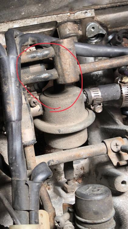

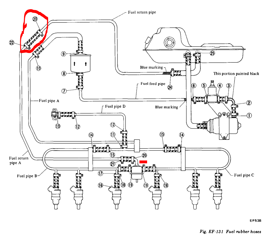

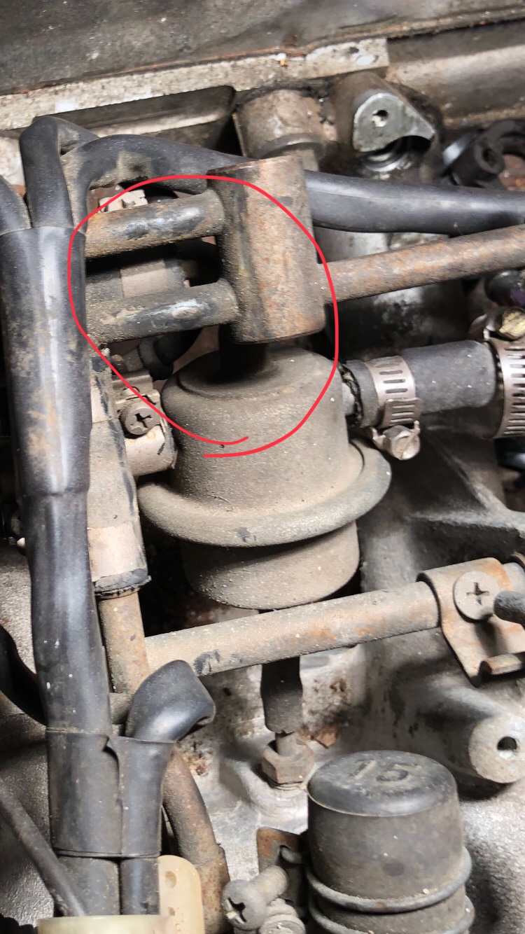

February 9, 20187 yr comment_541921 Looking at your photo, I can't see the return line from the FPR. It should be in the red circle under the hose going to the valve cover. The return line has a 90 degree bend towards the front, so I would expect to see the second clamp. Im wondering if it is connected correctly. If it is, follow it through to the hose next to the filter. Disconect it there and test the pressure again. To test the pressure. Remove the little spade terminal wire on the starter motor so you can turn the key to start position to run the pump, but not crank the engine. Don't need to crank the engine to test the FPR. Like already mentioned, it should be reading around 36 psi. 55 is way too much and will flood the engine. The ECU is expecting 36 psi and won't compensate for high pressure. The 77 model had the two inlets (in blue circles) and the outlet (red circle) with a 90 degree bend. The 78 version had one inlet on the back side of the FPR. It's clear youhave the 77. Link to comment https://www.classiczcars.com/forums/topic/59296-bringing-a-1977-z-back-life/?&page=10#findComment-541921 Share on other sites More sharing options...
February 9, 20187 yr Author comment_541923 EuroDat, Great explanation, I will check that as soon as I get back. I checked my other photos and I just can’t see under that hose covering that connection. One note was after I had all that pressure when I tested the rail I could later hear gurgling back near the fuel tank. It sounded like fuel slowing returning to the tank. This was several minutes later. I’d think it would have occurred almost immediately. Might be indicative of a small blockage in three. Sent from my iPhone using Tapatalk Link to comment https://www.classiczcars.com/forums/topic/59296-bringing-a-1977-z-back-life/?&page=10#findComment-541923 Share on other sites More sharing options...
February 9, 20187 yr Author comment_541925 Here’s a photo I took before removing the fuel rail. I can see what your are talking about. Sent from my iPhone using Tapatalk Link to comment https://www.classiczcars.com/forums/topic/59296-bringing-a-1977-z-back-life/?&page=10#findComment-541925 Share on other sites More sharing options...

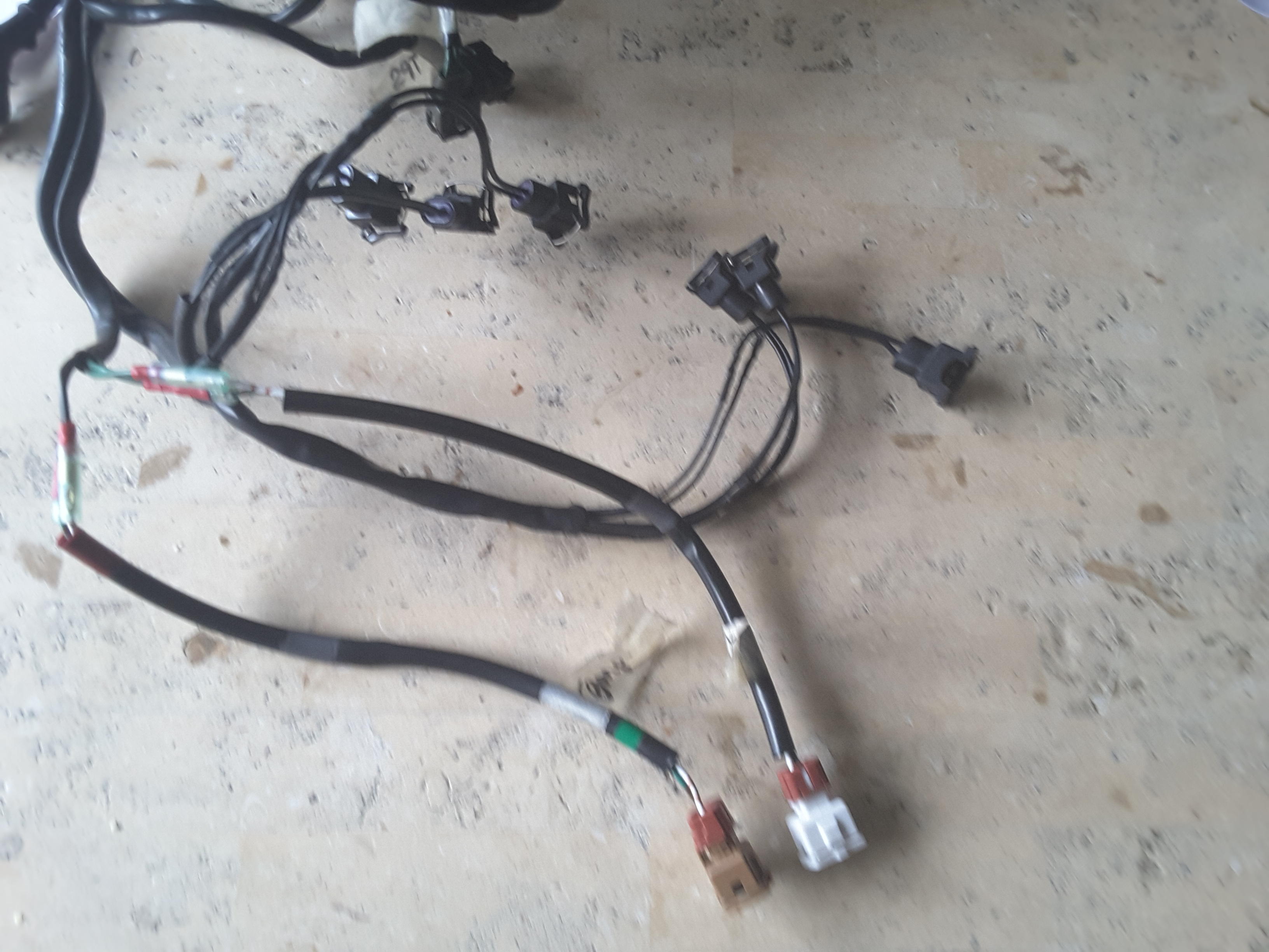

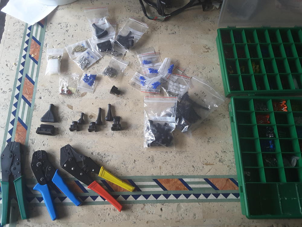

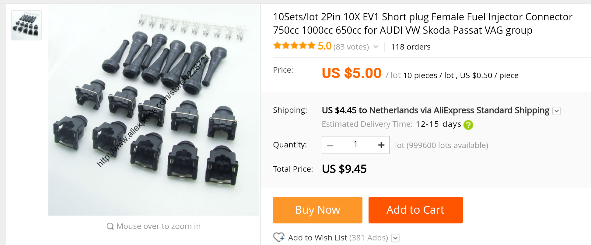

February 10, 20187 yr comment_541958 Just to add my 2 cents on these connectors. I have repaired a couple of 280Z and a couple of european bosch variants which are basic the same thing. A LOT of these ebay sellers are just flipping stuff you can get from aliexpress. Clues like the brown insulator plugs point towards a lot of aliexpress stuff. Not saying they are bad quality, just cheaper when sourced directly. I have original Nissan, original Bosch, Aliexpress and a couple from ebay. I can not say one is better than the other. In the first photo is a mix from bosch (with blue tyco insulators) and stuff from aliexpress, note the brown insulators. Second photo is a typical kit from aliexpress. The harness (spare) in the last photo has the purple ebay connectors with the extra wire and nissan harness on the temperature sensors which are a bugger to remove from the sensor. Link to comment https://www.classiczcars.com/forums/topic/59296-bringing-a-1977-z-back-life/?&page=10#findComment-541958 Share on other sites More sharing options...
