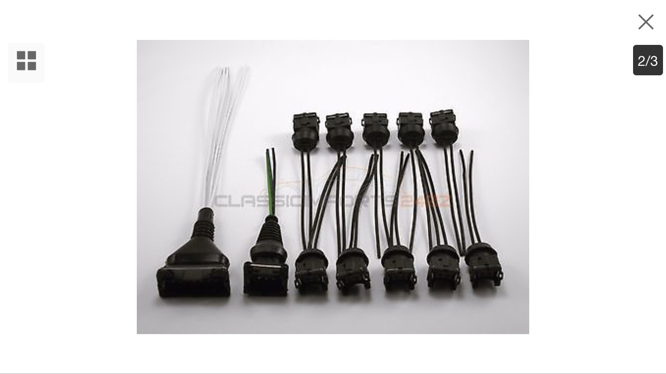

February 10, 20187 yr Author comment_541968 I went ahead and pulled the trigger on a set on eBay from Classic Imports 240z seller. He’s got great reviews and seems to deal on classic Z parts. https://m.ebay.com/itm/Fuel-Injector-AFM-TPS-Wiring-Harness-Connector-Kit-for-Datsun-280z-Nissan-280zx/152245949681?fits=Model%3A280Z&hash=item237290d4f1:g:MwsAAOSwhQhY2B2GSent from my iPhone using Tapatalk Link to comment https://www.classiczcars.com/forums/topic/59296-bringing-a-1977-z-back-life/?&page=11#findComment-541968 Share on other sites More sharing options...

February 10, 20187 yr Author comment_541980 Zed Head, Agreed, I don’t think the connectors are the reason it’s not starting but I do know mine are bad. They are cracked and will not stay on the injectors. They pull off with not effort and will not lock in. They need to be replaced. Since I’m running through the FSM continuity checks and already found a problem it’s seems prudent to make sure the connections are solid. I don’t think it’s too outside the box. I know I need to test the AFM, I know the tank is shot and I plan on addressing those items as soon as I return. Sent from my iPhone using Tapatalk Link to comment https://www.classiczcars.com/forums/topic/59296-bringing-a-1977-z-back-life/?&page=11#findComment-541980 Share on other sites More sharing options...

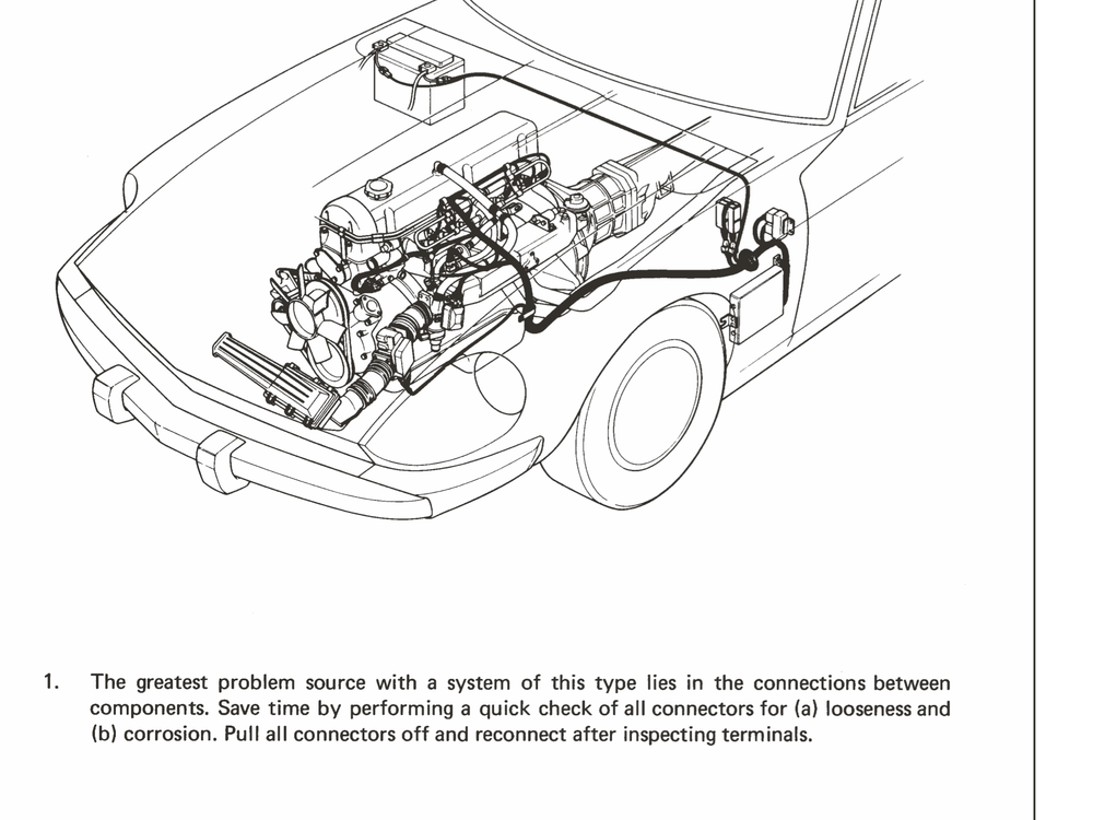

February 15, 20187 yr Author comment_542407 Thanks for the link to the EFI Theory and Troubleshooting guide. Ive been reading it from begining to end,. I learned a lot and its given me a logical path forward. I head back to Memphis to work on the car this weekend. First step in the troubleshooting section says that the greatest source of problems with the injection system is the connections. Like I said before mine are in terrible shape. While I know Zed Head mentioned that i need to focus on isolating the probelm step by step, I feel not addressing the wiring/connections will lead me down some rabbit holes. i.e. thinking i have a bad component vs a bad connection. Also, something I have forgotten to mention until researching starting issues online that I wanted to ask you pros if you think it could be another clue to my issue. When I turn the ignition key to the “on” position I get no lights in the car. I mean no dash lights. I think I'm suppsed to see the red “brake” light and the red oil pressure light and possibly a buzzer. I could be wrong, I dont know what I'm suppsed to see becasue i see not lights at all. Thanks. Link to comment https://www.classiczcars.com/forums/topic/59296-bringing-a-1977-z-back-life/?&page=11#findComment-542407 Share on other sites More sharing options...
