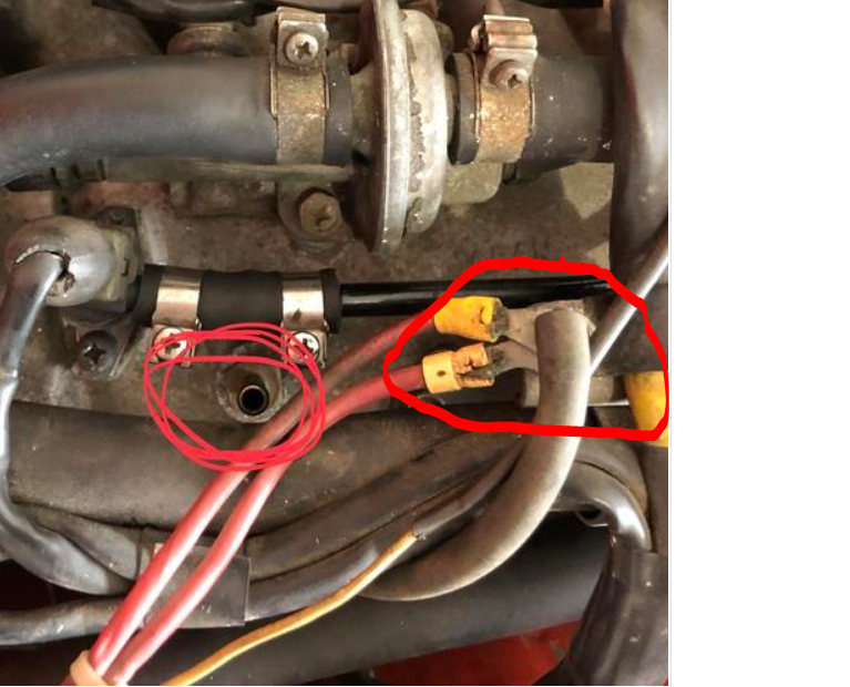

February 22, 20187 yr comment_543038 9 minutes ago, Av8ferg said: Okay, absorbing all the advice. ZH, tested voltage to the battery fuse link and got 12.7v. Fuel injection power relay tested good right out of the FSM. The bad news is I cracked the board when crimping it back into the metal cover. It’s still tests good but might need replacing now that I have compromised it. I’m going to find the power wire and see if Inget continuity now. While rummaging around looking for wiring problems I found this on the passenger side above the fuse box. Are these two barrel connecteors supposed to be connected to something? Finally can I test power to the injector plugs themselves. I’ve read I should be getting 12v on them, but I’m getting nothing. Disconnected the starter had my assistant turn key to the start position and then tested the voltage from one pin of the injector connector and other to a ground. Nothing.... Power to the injector plugs runs through the relay. So if the relay is good and there's power to the relay plug you should have power at the injector plugs. Only on one side though, if all of them are disconnected. If they are connected then you might see power on both pins, through backfeeding from the other injectors. You should see power when the key is at On. You're testing the right way with one probe on ground and the other on the pin. I'd probe all of the pins at the relay plug and see if there's power there with the key On. Link to comment https://www.classiczcars.com/forums/topic/59296-bringing-a-1977-z-back-life/?&page=14#findComment-543038 Share on other sites More sharing options...

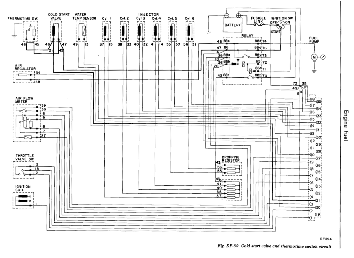

February 22, 20187 yr comment_543039 Here's a wiring diagram. Check your dropping resistors also. That's where the power goes right after it leaves the relays. You never what someone might have unplugged in the past. Link to comment https://www.classiczcars.com/forums/topic/59296-bringing-a-1977-z-back-life/?&page=14#findComment-543039 Share on other sites More sharing options...

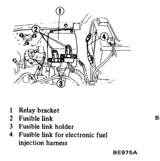

February 22, 20187 yr comment_543044 25 minutes ago, Av8ferg said: Tested both plugs that go to the Fuel Injection Power Relay. Only one showed voltage and that was pin 70 which goes to the positive battery terminal thrrough the fuse link on the positive terminal. I got 12.7v. No voltage on any other pin in the plugs. Is that with the key On? That's a good test of your EFI fusible link. You should have had power at 73 also. I think that fusible link is the Ign fusible link. It powers your ignition switch. Looks like you either have no power to the switch or the to 73 is broken. Here's a link to a bigger diagram. This progress, although it probably doesn't feel like it. The diagram might be hard to follow. But it shows that 73 gets its power through a path that goes through a couple of connectors, and also branches off to the ignition relay. But it starts at the fusible link. Might be that your Ign fusible link is blown and the source of many of your problems. Recheck the fusible links. ( p.s. Even with carbs you need the Ign link ). http://www.classiczcars.com/files/category/1-wiring-diagrams/ Link to comment https://www.classiczcars.com/forums/topic/59296-bringing-a-1977-z-back-life/?&page=14#findComment-543044 Share on other sites More sharing options...
