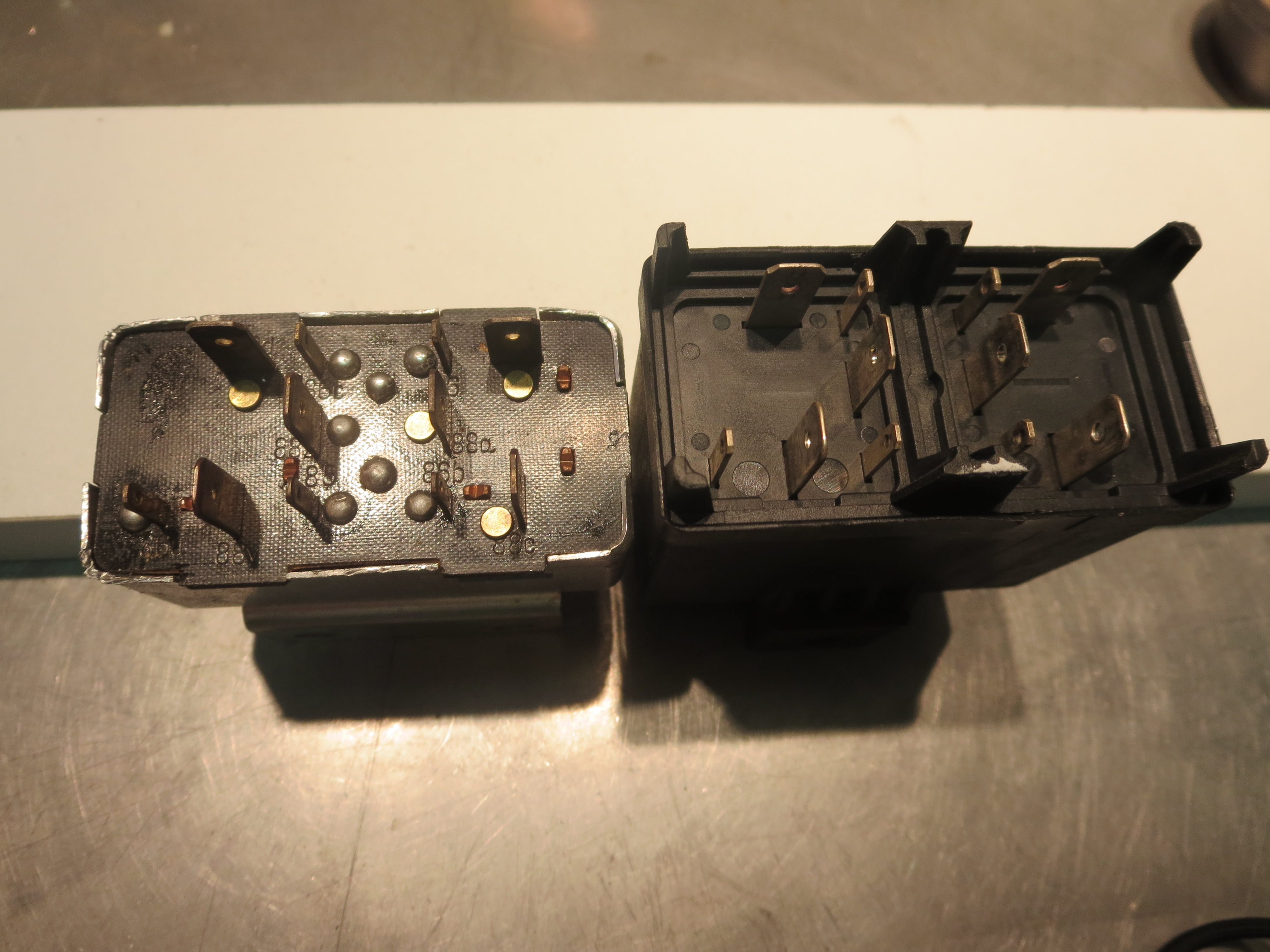

Dave WM Posted February 23, 2018 Share #169 Posted February 23, 2018 yea kinda trashed. Link to comment Share on other sites More sharing options...

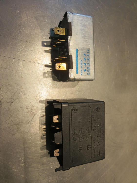

EuroDat Posted February 23, 2018 Share #170 Posted February 23, 2018 When you are looking for a fuel injection relay try for the bosch type 0 332 514 120. Used on porsche, volvo, mercedss etc. It is the same thing, but made in germany. Link to comment Share on other sites More sharing options...
EuroDat Posted February 23, 2018 Share #171 Posted February 23, 2018 https://www.ebay.com/p/Fuel-Injection-Combination-Relay-Inj-Combi-Relay-Bosch-0-332-514-120/77006951 Link to comment Share on other sites More sharing options...
Av8ferg Posted February 23, 2018 Author Share #172 Posted February 23, 2018 Awesome you just saved me about $50 ? Link to comment Share on other sites More sharing options...

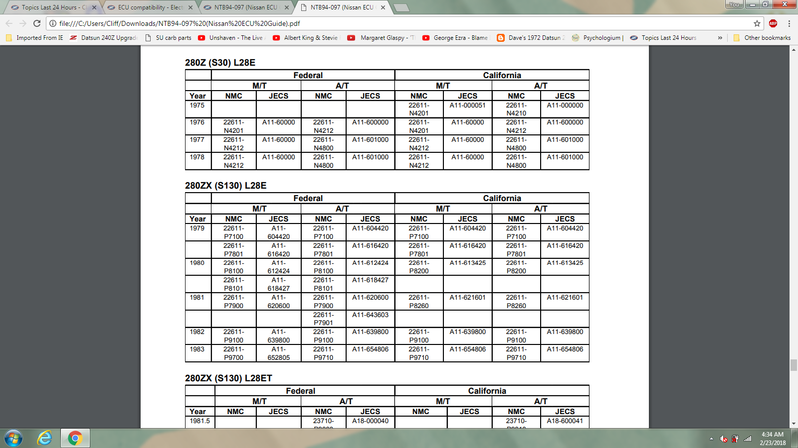

Av8ferg Posted February 23, 2018 Author Share #173 Posted February 23, 2018 ECU question while I wait for my new relay. I have a box of parts that came off a 78. One of the extra parts is an ECU. Can you put a 78 ECU on a 77? I have to dig more in the FSM to confirm my findings once the new relay is in but I’m becoming suspicious of the ECU. Here are pics of the ECU part numbers. Green parts label is from the 78. Link to comment Share on other sites More sharing options...
siteunseen Posted February 23, 2018 Share #174 Posted February 23, 2018 here's something Zed Head put up. he'll be able to help more. Looks like the pink sticker is for an automatic? Link to comment Share on other sites More sharing options...
Av8ferg Posted February 23, 2018 Author Share #175 Posted February 23, 2018 Huh...my car is a 5 speed. The one with the pink sticker came out of my car. I don’t know the history of this car; anything could have happened over the past 40yrs. I know someone parked it in 1999 after it was repossessed and it hasn’t been registered or titled since. Something stopped this car from running and no one put the time in to figure it out. It’s my mystery now. Everyday Carbs sounds good, but I’m committed to figuring out this problem. I wish I had more time but life is busy. Link to comment Share on other sites More sharing options...
Av8ferg Posted February 23, 2018 Author Share #176 Posted February 23, 2018 Cliff thanks...I’m looking forward to ZH’s reposnse. Could this be my smoking gun. 1 Link to comment Share on other sites More sharing options...

Av8ferg Posted February 23, 2018 Author Share #178 Posted February 23, 2018 Looking through forums I’m getting mixed information on ECU compatibility. This one states you cannot put an automatic ECU on a manual car but that you can put a manual ECU on an automatic car. ? http://www.zcar.com/forum/10-70-83-tech-discussion-forum/3738-needed-ecu-76-280z-manual-trans.html Link to comment Share on other sites More sharing options...
Zed Head Posted February 23, 2018 Share #179 Posted February 23, 2018 Pretty sure I've used both of those ECU numbers on my car with no problems. 1976 4 speed coupe. I've collected several over the years and run them for a while to be sure that they work. I have a spare behind the driver's seat, ever since one failed on a test drive. But the ECU is at the end of the line for injector power. So until you confirm power to the injectors, you won't know what the ECU is doing. The relay controls power to the injectors, and the ECU lets it pass through. Link to comment Share on other sites More sharing options...
Av8ferg Posted February 23, 2018 Author Share #180 Posted February 23, 2018 ZH, would you recommend using my other ECU off the 78 since I have it on hand. Sent from my iPhone using Tapatalk Link to comment Share on other sites More sharing options...
