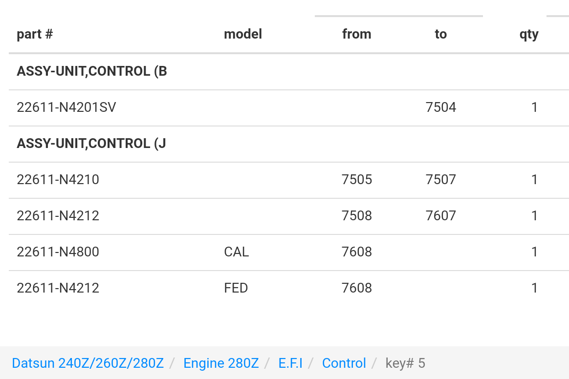

The A11 600 000 is the manual version and the 601 is automatc version. Nissan don't mention any difference between the auto or the manual in their part numbers. Unfortunatly they didn't mark the ECU with their number, so tracing the ecu to their part number is not easy if at all.
No csv seems strange. An auto is no easier to start when its cold so why would they delete it?
The very early 280Z up to April 75 had a Bosch unit (B, after that they are all JECS (J
I thought they were interchangable up to August 77.
The units after August 77 don't have the terminal 20 for fuel injection relay. They changed the relay to a two separate relay system in the engine bay and used the oil sensor to activate it. The switch in the AFM is no longer used. I think I posted a photo of ghe two AFM's earlier in this thread.

Here's an old thread.  Found it on Google and it's one of those vague memories.   Looks like CO had some firm thoughts on it.   Nissan developed an analyzer that plugged in to the ECU connector.  In 78 they did identify  AFM pins that had no function though, so don't know why they couldn't add a comment about those pins if they were for the analyzer.

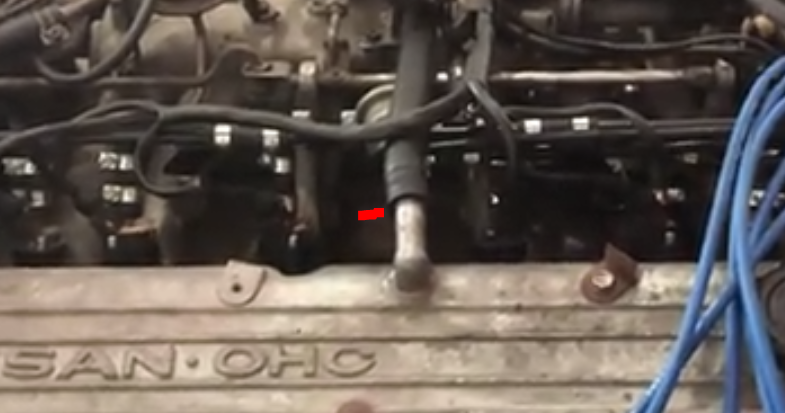

I hooked a bucket and fuel can to take the place of my fuel tank and tried to start the car.   No luck.  Fuel pressure hit around 35 psi but no turn over.  It’s odd, I’m getting what appears to be some back flow through the hose coming off the valve cover and get a hiss sound from the engine when this happens about once every revolution or so.  It also has a slight burnt smell.

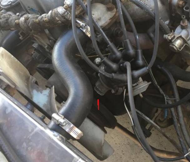

I don’t know what it could be?  I can’t figure out why the car is not getting ignition either.  I’ve tested the coil and the spark at the plugs.  All that seems to be working.  The only thing I can think of is the timing is way off.
Here is a link to a video I just posted.  I’d love you hear everyone’s opinion.

It does sound like the timing might be advanced.  There are two lines on the adjustment plate that might get it close if you don't have a timing light.  You can also compare the edge of the reluctor "star" wheel with the metal strip on the pickup coil and see where the damper pulley mark is.
You said that you can hear air hissing thorough a hose and it looks like your PCV hose might be loose.  All of the hoses need to be connected.  The crankcase is connected to the intake manifold and will cause a vacuum leak if it's not sealed.
