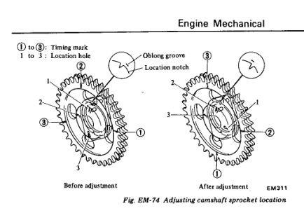

March 25, 20187 yr comment_545593 I'd try a couple more times. That's harder than it seems. #2 lobe needs to come up and the straight line should at least be in the sprocket notch. Link to comment https://www.classiczcars.com/forums/topic/59296-bringing-a-1977-z-back-life/?&page=18#findComment-545593 Share on other sites More sharing options...
March 25, 20187 yr comment_545594 Oh and your rotor is at 5 and #1 will be 8 o'clock. You are really close. You may need to advance the sprocket to a higher number? Link to comment https://www.classiczcars.com/forums/topic/59296-bringing-a-1977-z-back-life/?&page=18#findComment-545594 Share on other sites More sharing options...
March 25, 20187 yr comment_545595 There is not really a "180 off". There is off though. It could be any number of degrees. But it doesn't matter much if you can get the plug wires in to holes that allow them to spark at the right time. Which I think that you had, because you measured timing with a timing light. On the other hand, there is rotor positioning. If the rotor is on the right electrode but late or early you could get spark jumping to the wrong electrode. But it does look your cam timing is pretty far advanced. Somebody has moved the sprocket to the #2 or #3 hole. If you don't want to set lash or measure it at least grab each rocker arm and see if it's loose. Link to comment https://www.classiczcars.com/forums/topic/59296-bringing-a-1977-z-back-life/?&page=18#findComment-545595 Share on other sites More sharing options...
March 25, 20187 yr comment_545596 I think that his is already on a higher number. It's way beyond "after adjustment" and adjustment is to higher numbers. Link to comment https://www.classiczcars.com/forums/topic/59296-bringing-a-1977-z-back-life/?&page=18#findComment-545596 Share on other sites More sharing options...
