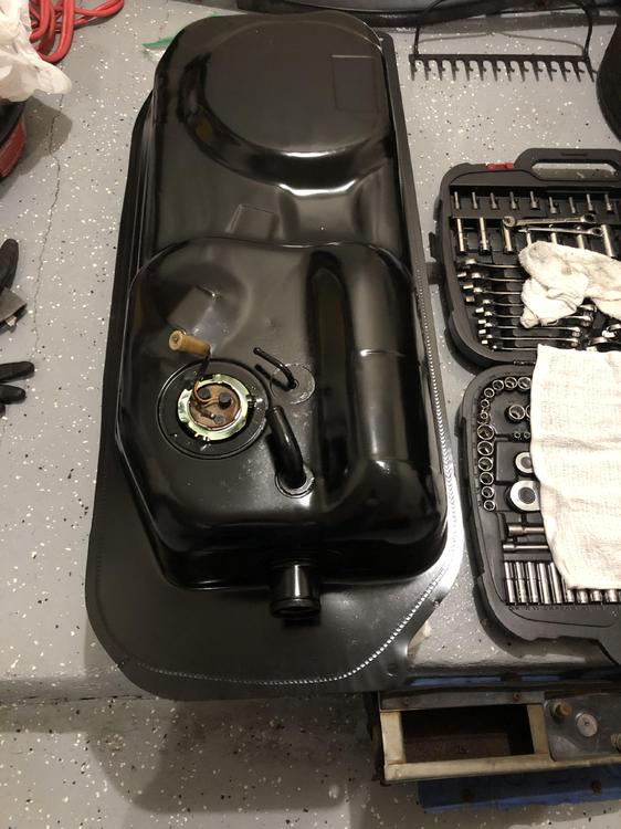

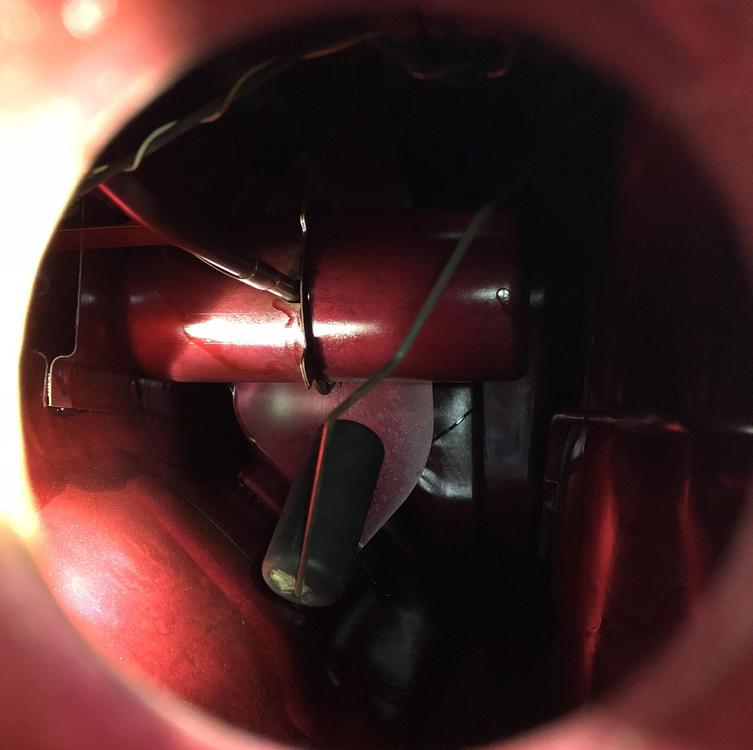

So the tank didn't cost me extra $$ but its been a hassle.  It took three tries for them to get it right. First time they didn’t repaint the outside and just did a primer, so I said please finish the job.  2nd time I went to pick it up the filler pipe was still rusty inside and they lost the drain plug.  3rd time I went to pick it up and shined a flash light inside they missed a 4”x4” spot in the tank on the top.  They then reboiled and stripped it all one more time and then rebaked the coating, and now it looks like new.   This porcess took about 5 weeks because they’d “finish” the job and I would have to wait to get back to TN.  See pics.  I dont have the before pics because my iphone went tits up and I hadn't synced it...hint sync your phone every 2 weeks.  My phone was only 4 months old,   Needless to say the tank was really bad inside.

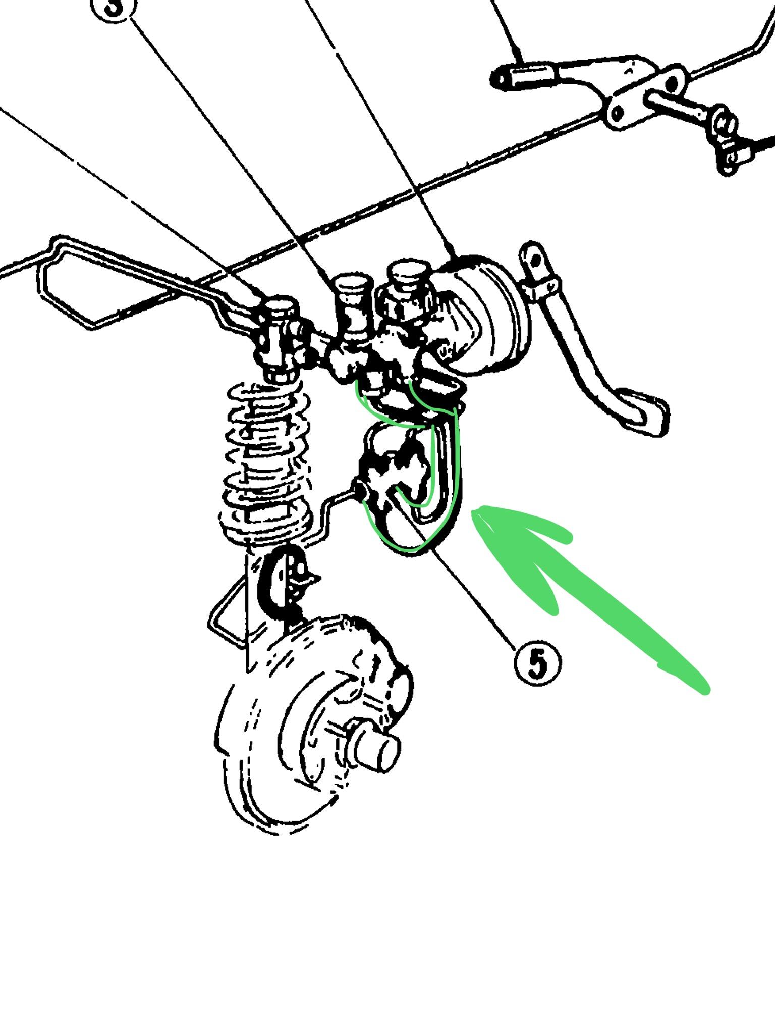

I need a favor.  I forgot to mention the when I pulled my brake master cylinder there were no lines connected to it.  I appears the PO forgot to put them back in and I never noticed it because they connect under the master cylinder.  I’m sure its next to impossible to order these two specific lines individually so I was think a flex line possibly.  Since I’m now headed back to NC I cant measure the lengh I need.
I measured mine by running a piece of electrical wire along the lines.
The line going from the front mastre cylinder to rear underdside of brake switch is 300mm.
The other line going from the rear of the master cylinder to the front underside of the switch is 310mm. These measurements are give or take a couple of mm and the bends are fairly tight going to the switch.
I would look for a shop that can make two straight sections and when back home bend them to suit. If you gl with flexables, make surd they are not to close to the exhaust and limit their movement.
After all it is your brakes.

Tank looks good!
You say they baked it to cure the liner?  I learned, after a lot of reading, to not put fuel in until the smell of the Red-Kote is completely gone.
It will sit in a hot garage for 5 days.  Hopefully that will suffice. Break....break
