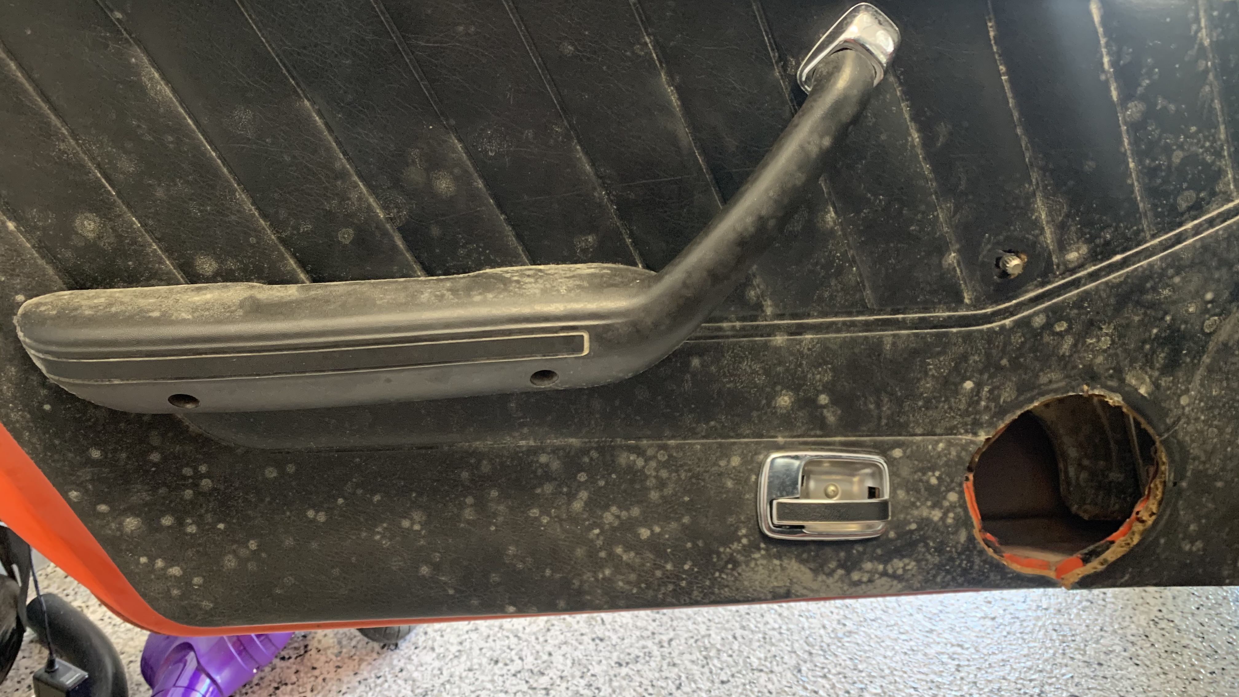

April 28, 20213 yr Author comment_620693 Update.... My Z is finally home, tucked in my garage. Quite a journey getting her here. With a busy job, home construction delays, COVID, push back from my wife and logistical challenges it finally made it home. Thanks for all the help from the members of this forum. Now it’s time to get my hands dirty and make it ready to run like it was meant to be. Today is interior mold removal day. If my wife sees that mold it’s game over, she’s push it out and set it ablaze! Where is was stored had a serious mold issue and the interior has a light blanket of mold everywhere. I took these pics today. Link to comment https://www.classiczcars.com/forums/topic/59296-bringing-a-1977-z-back-life/?&page=32#findComment-620693 Share on other sites More sharing options...

April 28, 20213 yr Author comment_620720 It’s cleaned up. Mold all gone. I replaced the clutch master today and bleed the system. If you don’t need a chiropractor you will after replacing that master. It was a nightmare getting under the dash to hook it up but this time I decided to unscrew the shaft from the bracket that connects to the pedal vs taking the pin out. I have no rear brakes but took it for a spin around the block anyway....watch out granny!!!!. Runs like crap. Lots of work ahead. Tomorrow, I’m repacking the front bearings, installing new rotors, calipers and brake pads. She doesn’t need my password just needs to unlock my phone and open Tapatalk. She has no interest though....Sent from my iPhone using Tapatalk Link to comment https://www.classiczcars.com/forums/topic/59296-bringing-a-1977-z-back-life/?&page=32#findComment-620720 Share on other sites More sharing options...
