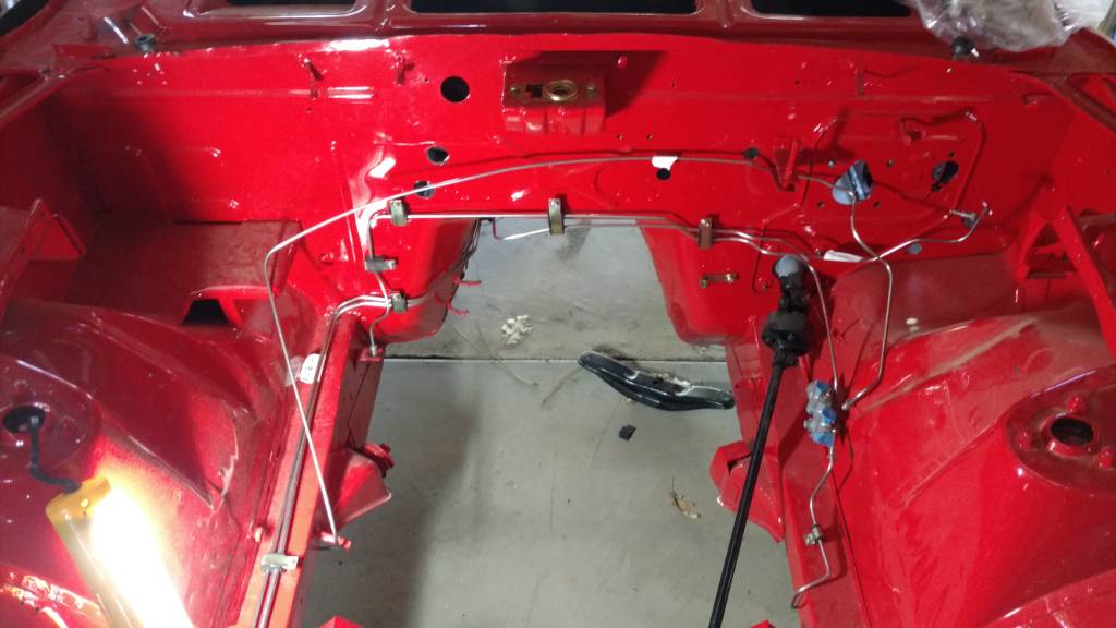

I found they where not exact, but fit well enough to work (I did have to bend in one spot).

Most of the lines look correct but the brake line going under the tunnel looks like it stopped about 3 inches too soon before it made the bend to the rear.  Then the one running to the right front tire looks way off (which naturally is the line I need the most of course).  One line looks like it is touching your steering shaft?
The fuel line and the clutch lines look exact.
