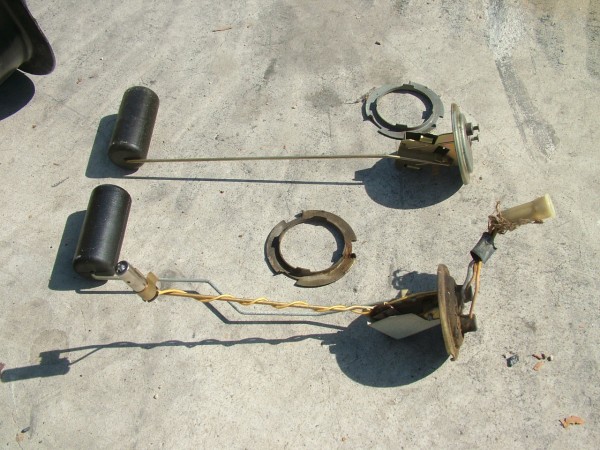

I am a bit puzzled. Did anybody ever replace the capacitor thingy on a 76´ 280z fuel tank sending unit? Is there any replacement part? My whole sending unit it pristine, just the darn capacitor is completely rusted (guess it was in old petrol too long...) and there is virtually NO junkyard with parts here. Can I salvage an ebay unit for the capacitor?
See image stolen from Hybridz for reference, need the small metal tube, everything else is in perfect condition

That sensor isn't a capacitor, It's an RTD. They push the current from the fuel warning lamp through it and it heats up. If it heats up enough, the resistance drops and the current gets high enough that it makes the filament on the warning lamp glow.
The trick is... When it's immersed in fuel, it won't heat up enough for that to happen. But when the fuel level is low enough and that sensor is hanging in vapor (and not immersed in liquid fuel), it heats up enough to pass higher current. High enough to light the lamp on the dash.
@Dave WM did some analysis and came up with the above.

in series with the bulb, cold (in liquid gas, current flows, but heat generated  is dissipated by liquid) resistance is high, out of liquid the current flowing creates heat, as it heats up the resistance of the sender drops, allowing more current to flow, in series with the bulb. as the resistance continues to drop the light begins to glow.
Always seemed odd to me to have something like this in a gas tank when it gets low enough to be out of liquid gas and if gas fumes.
the FSM details a test process, but it is somewhat flawed in that it has you check it with a multimeter in the resistance setting. with so low test current there is very little heat generated so the change in value is not significant when in liquid (water for the test) or air. A better test would be to hook up a 12v batter and light bulb of the type used in the indicator. In series, this would flow enough current to make the test valid.
