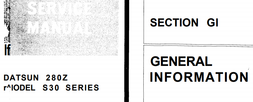

Indeed it does.  The 1975 FSM wasn't available for quite a while, the 76 was a proxy.  Nice that we have a correct copy on CZCC.  I think that mine came from xenonzcar.
The 75 FSM looks like it was typed out using a home-made typewriter.  The worst quality text.  Maye some sort of translation machine.

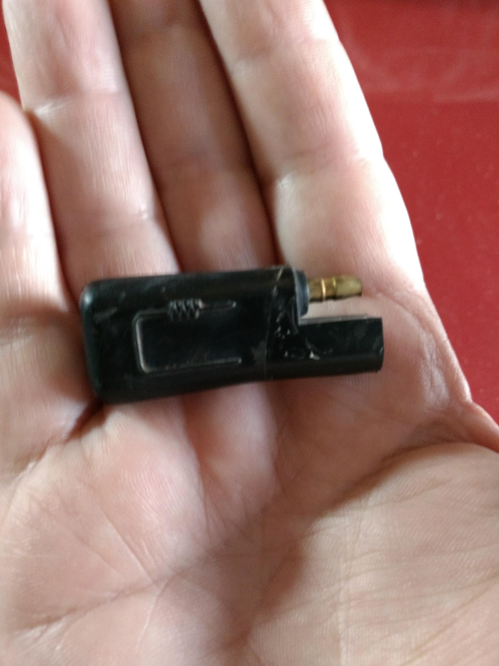

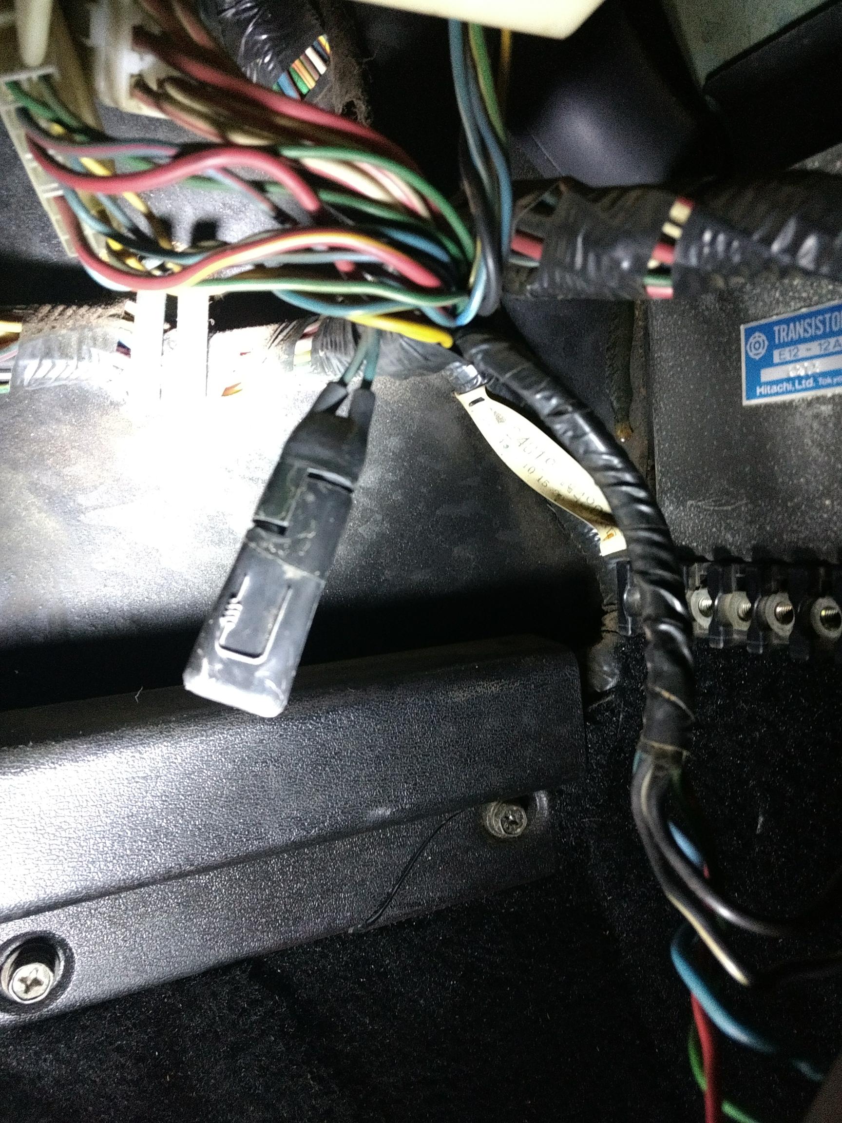

Im not sure where it is exactly on a 75, but on the 77 it's very close to the TIU. Easy to reach and check. You could mistake it for a end plug or end cap to protect the wires.
It has blue wires.
I hope Im not sending you on a wild gose chase. I have never seen it on a early 75.
I snapped a couple of photo's of my 77
The 74 FSM has a picture of the resistor that is the same as in the 75 FSM. I did a brief search to see if I could find the old part number. So far, no luck.
On the other hand, I did buy a bunch of 2.2K Ohm resistors about a year or so ago. They are stashed away in my garage somewhere...

You probably left the blue wire disconnected in the engine bay.  You should have a wire from the coil negative to the C terminal on the HEI, which you do because it works, and a blue wire to either the C terminal or the coil negative (since they're connected anyway) that runs in to the harness.  It ends up back at that resistor, which is connected to the tach.  It just lets the tach "see" what's happening at the coil.
Welp, I'm a dummy. I didn't have the blue wire hooked to the coil. It works great now. Perfect response. Now just to figure out this temp sensor. I bought a new one today. Hope it works.
