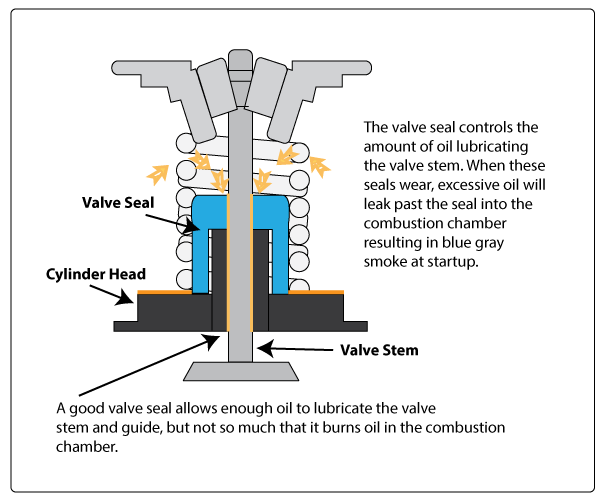

From your description, the first thing that comes to mind is valve stem seals. They are little rubber seals around the valve stems that limit the amount of oil passing through to the valve guide to a minimum. If the become old, they harden and break and allow oil to run down the stem and throught the valve guide to the inlet valve. The inlet valve is mostly under vacuum and causes the blue smoke problem after a period of coasting and the acceleration.
A simple test would be to coast down a hill with no throttle and at the bottom of the hill a short burst of full throttle or hard acceleration. You should see a plume of grey blue smoke. That is a good indication.
Why the test: When coasting, high vacuum pulls in more oil then normal, but a closed throttle doen't give it enough fuel air to burn the oil. When you give it full throttle, the fuel air mixture then burns the oil creating excessive smoke for some seconds.
A compression test will tell you more about the overall condition of the engine.

 @RedwingMy description of a stumble is a MOMENTARY loss of power. Normally caused by one or more cylinders BRIEFLY misfiring. You can feel it as well as hear it. If it's severe enough under heavy acceleration you'll feel yourself pitch slightly forward and then back. An exhaust backfire has no feel to it. It's just noise.Have you noticed RedBird running worse, my suspicion is the backfire is just that, backfire. The new muffler may take some getting used to. As for the smoke, it probably needs valve guide seals. It's possible the smoke has been there all along and gradually getting worse (normal) but you noticed it when the backfire started. What do you think?

 When Chas says "coast down the hill" he means, in gear using the engine to slow you down.
Well, that is what I do approaching the corner.  Then heavy acceleration to get going after turning.  Then is when I see the blue - blue/gray smoke.  Which he said a good thing.  Hunh?
9 minutes ago, Redwing said:
Hi Jai.
Yes, if you have enough revs and no throttle. There should be enough vacuum to pull in oil and not burn it. Then drive further a little harder than normal.
Is it a good sign. The seals are not expensive and people use the ford units with succes. Getting them fitted could be costly or someone close by that is hangy with cars could do it.
