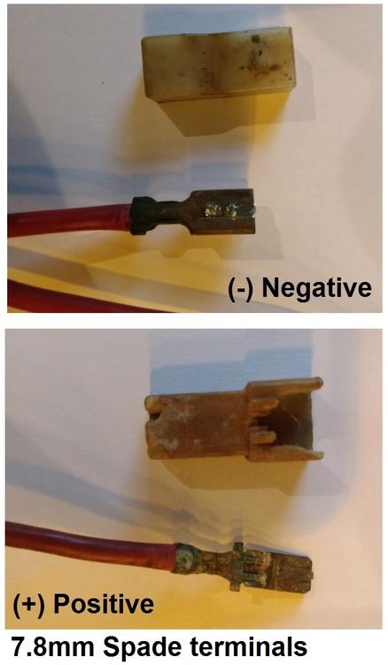

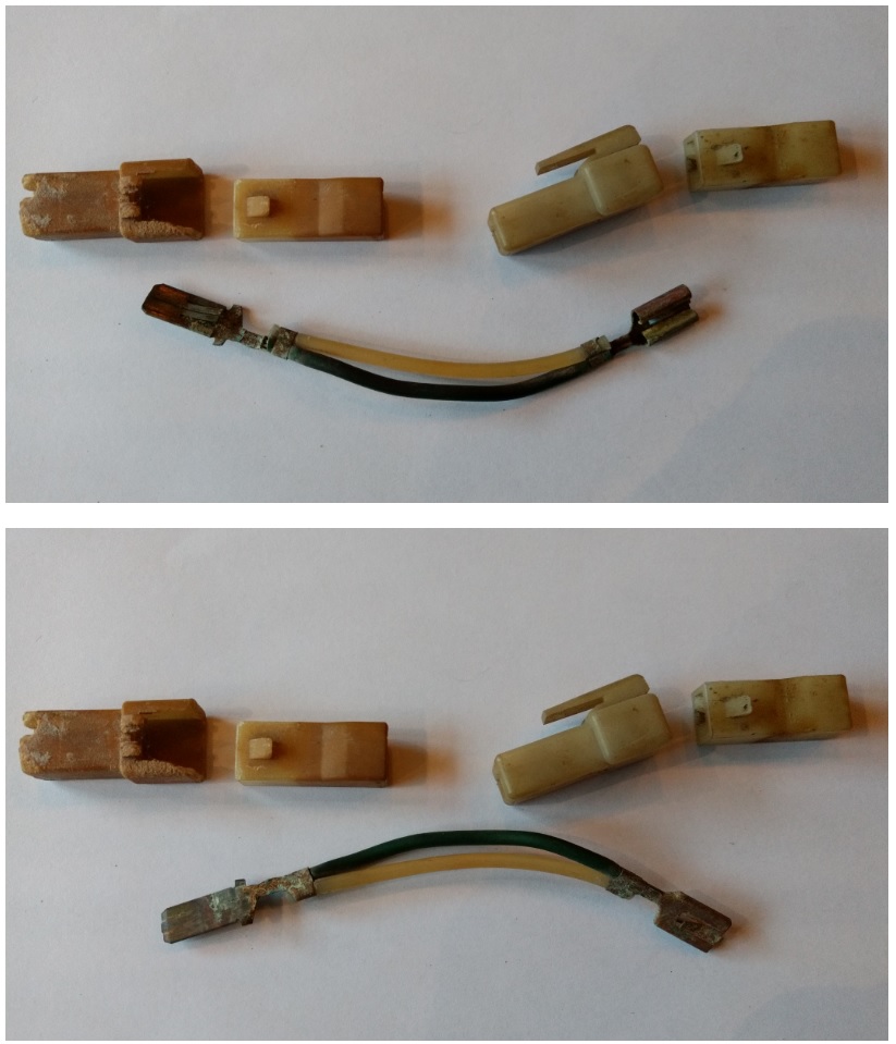

Corrosion in the terminals is a big problem and can cause voltage drop in the ECU power supply. A lot of weird issues in the ECU because the ECU does’t like low voltage. See photo's of corroded terminals.

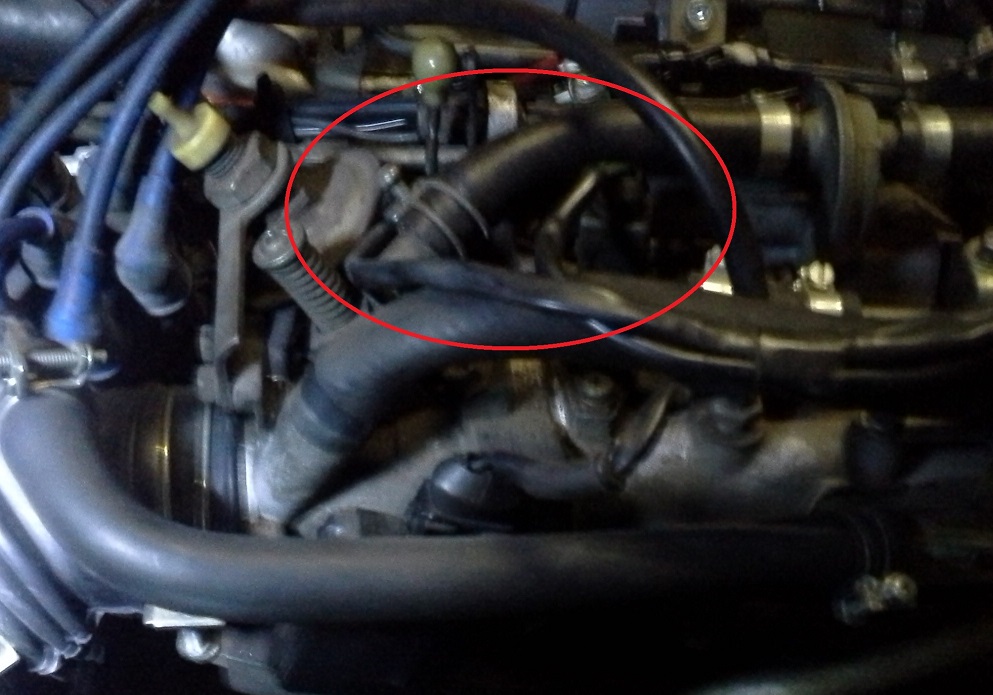

A yoghurt cup test is a simple leak test you can do on the inlet manifold. Basically you remove the rubber hose between the AFM and the Throttle body. Block the hole in the throttle body with a “Yoghurt cup”. I use a plastic sheet over the open end and a Tye-rap to seal it off. After you have done that I remove the hose that goes to the AAR and blow into the manifold there (See photo for location). Even with your lungs you should feel pressure build up. My 77 holds pressure for about 15-20 seconds or more before its gone.

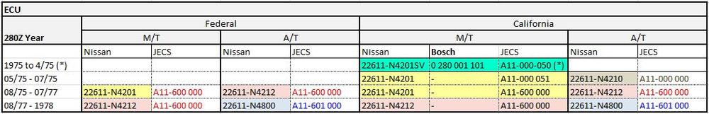

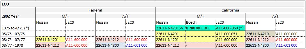

Can you have a look on the ECU. You should see a number beginning with A11-xxx-xxx. Since we don’t know for certain what the PO did, you could have an ECU that doesn’t match your harness pin layout. There are a lot of different ECU’s out there and not all will work in your car.
