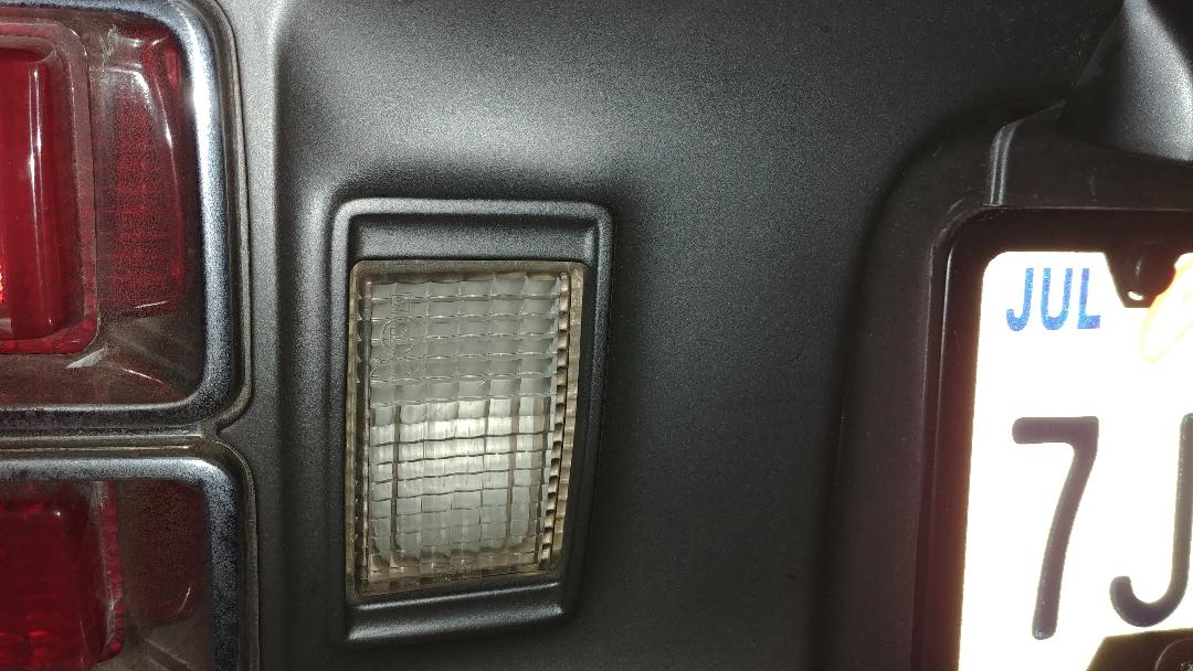

I was working on this at the end of last season. I tried all the previously mentioned over the counter options and wasn't satisfied, so I took matters into my own hands.
I found something better. Something that nobody else has tried before.
Something that doesn't light-up when the light hits it at the right (wrong?) angle like all the previous suggestions.
so, are you going to finish, or what?LOL
What? You guys want more detail than that?
OK, here's my evaluation of the original paint:
  1. It is a flat surface finish.
  2. It is a single layer of paint and is not clear coated on top. Meaning the flat finish comes from the one and only layer, not from a flat clear spray on top of a color coat.
  3. Looking under magnification, the original paint is a metallic flaked finish. There are sparkly bits present in the original coating.
  4. Even though it is a "metallic" paint, the flakes are very small and the density of the flakes is not very high. In other words, even though it's "metallic", it's just slightly.
  5. The reflective bits in the original finish do not "light up" the whole surface when light is reflected at any angle off the material. In other words, you can't angle the light to any position where the light reflects off a whole layer of metallic bits instead of the top paint surface.
That last point may require a little explanation... I'm not paint guy, but from my investigations, it seems there are two ways to get a painted surface to reflect a lot of light. The first is reflection off a glossy top surface. The second is off a reflective layer (of shiny metallic bits for example) under the surface.
Using the extreme case of a mirror as an example: You can get a light reflection off the smooth top surface of glass. You can also get a second reflection off the silvered layer beneath. You could spray the mirror with flat clear coat on top and break up the top surface, but you would still get a reflection from the silvered layer beneath. Might be blurry, but that thing would light up in the sun if you get the angle just right.
So back to metallic paints... My analysis is that if the reflective bits are too populous, too large, the wrong color, the wrong shape, or all just happen to lay out in the same position, they will make the paint light up at a certain angle even if the surface is a dull flat. In other words, they will look great straight on, but at an angle you will light up the reflective flakes.
An accurate substitution for the original paint would not only be the correct color and would be slightly metallic, but would NOT light up at any light angle.
IMHO, all of the previously tried paints either were the wrong base color, or had problems with the reflective bits lighting up at a certain reflection angle.

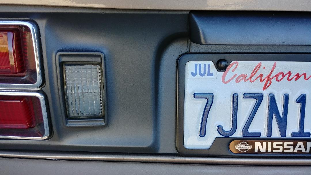

Are the panels the same color thru the years, 70-78? If so SEM makes a paint in rattle cans that looks real close if not identical to that gray panel color. Like CO said, it has a slight metallic look to it. I'll post a pic of the can later. I have it and applied it. Looks great! But you'll have to get their clear to put on it as well because the "gray color" is a flat finish. I'll post pics of the painted panel for you as well, as soon as I can.

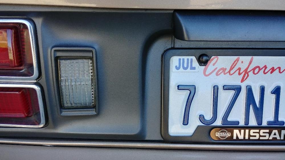

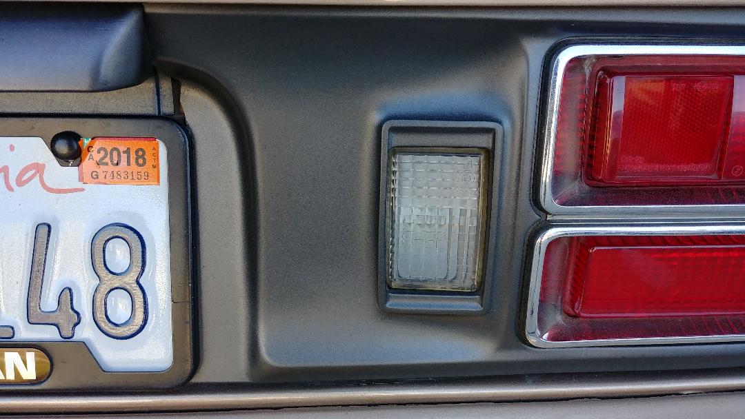

Here ya go. If you want more pics let me know. As you can see it is the "mat" looking finish that was original to the car. This is what I used to get there. I did 2 coats of gray and 1 of clear. May not be the best pic of the panel. I'll attempt a better one later.
Edited by rcb280z
