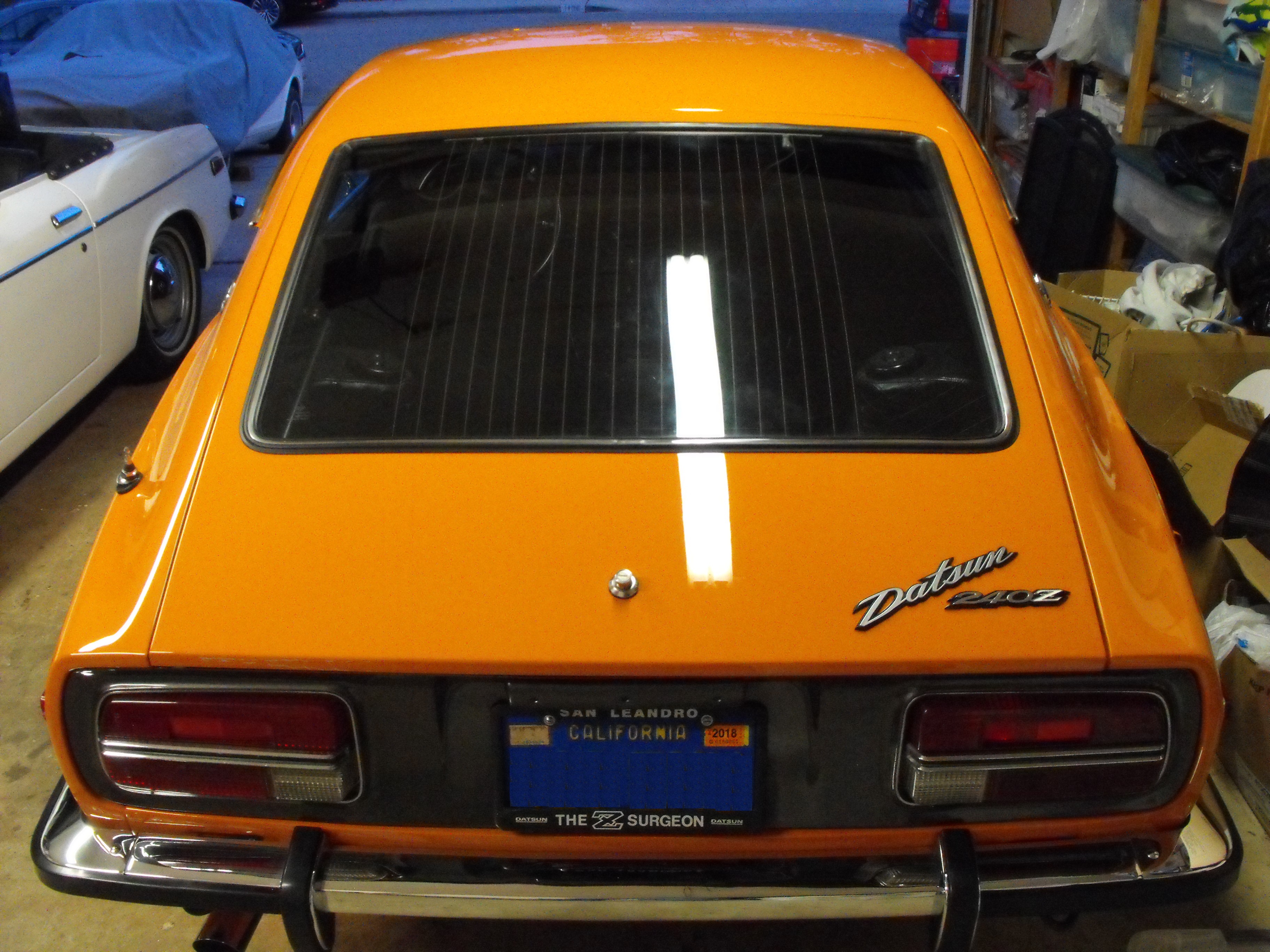

January 24, 20187 yr comment_540614 Do you guys think there's a difference in the 240 & 280s color? I was thinking the 280s are more of blackish color but I'm color dumb. My 280's faded all to hell. Link to comment https://www.classiczcars.com/forums/topic/59405-taillight-panel-paint/?&page=2#findComment-540614 Share on other sites More sharing options...
January 24, 20187 yr comment_540619 7 minutes ago, siteunseen said: Do you guys think there's a difference in the 240 & 280s color? That's what I was thinking but no one responded that very question I posted. Link to comment https://www.classiczcars.com/forums/topic/59405-taillight-panel-paint/?&page=2#findComment-540619 Share on other sites More sharing options...
January 24, 20187 yr comment_540620 Looks the same here though. At least the color does. Edited January 24, 20187 yr by rcb280z Link to comment https://www.classiczcars.com/forums/topic/59405-taillight-panel-paint/?&page=2#findComment-540620 Share on other sites More sharing options...

January 24, 20187 yr comment_540694 I think everyone is overthinking the correct hubcap, grill, and tail light surround color and how to match it. I purchases a rattle can of paint from Les at Classic Datsun Motorsports and it is almost a perfect match of color, texture, and low gloss as compared to the original. I have a set of NOS D-caps, and a NOS grill which are the exact same color. When compared to a set of D-caps I restored with new chrome and paint from Les, judges could apparently not tell any difference. If you really want to get into the weeds, the edge where paint and chrome meet on NOS D-caps is what I call a soft edge with no tape line. Good paint suppliers have a rope like product used to mask this edge and create this soft paint edge. attached is a picture of a NOS D-cap on the left beside my restored D-cap on the right. Just my thoughts! Dan Link to comment https://www.classiczcars.com/forums/topic/59405-taillight-panel-paint/?&page=2#findComment-540694 Share on other sites More sharing options...
