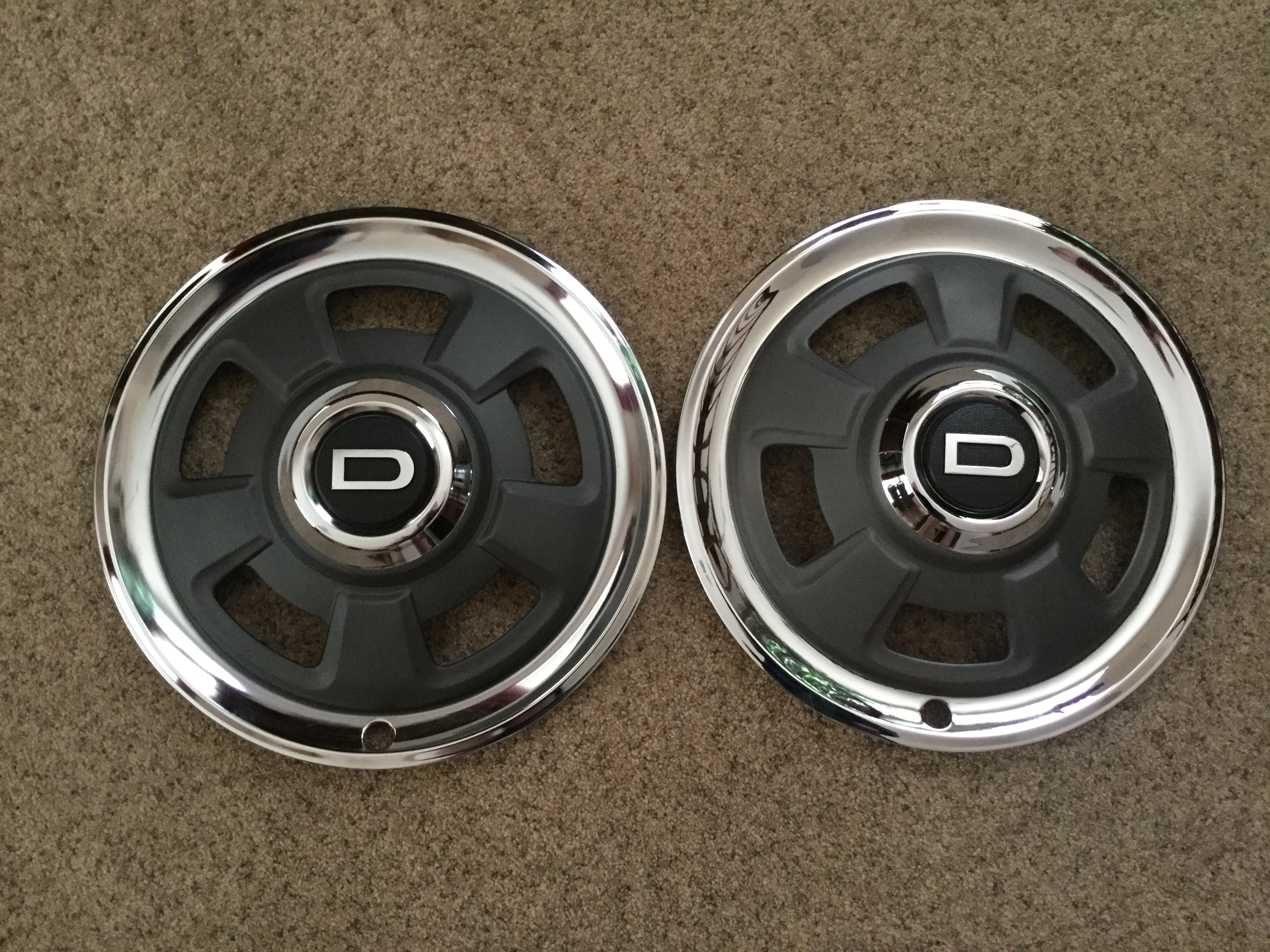

I think everyone is overthinking the correct hubcap, grill, and tail light surround color and how to match it.
I purchases a rattle can of paint from Les at Classic Datsun Motorsports and it is almost a perfect match
of color, texture, and low gloss as compared to the original.
I have a set of NOS D-caps, and a NOS grill which are the exact same color.  When compared to a set of
D-caps I restored with new chrome and paint from Les, judges could apparently not tell any difference.
If you really want to get into the weeds, the edge where paint and chrome meet on NOS D-caps is what I call
a soft edge with no tape line.  Good paint suppliers have a rope like product used to mask this edge and
create this soft paint edge.
attached is a picture of a NOS D-cap on the left beside my restored D-cap on the right.
Just my thoughts!
Dan

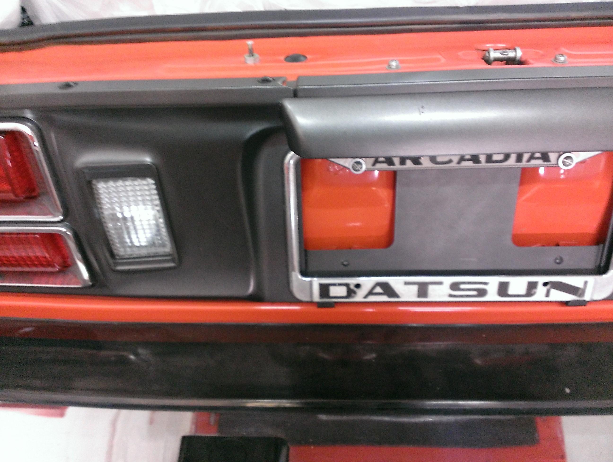

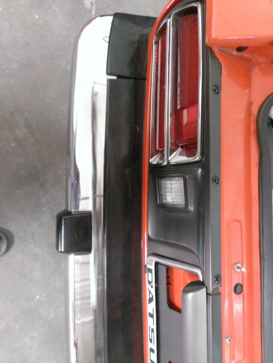

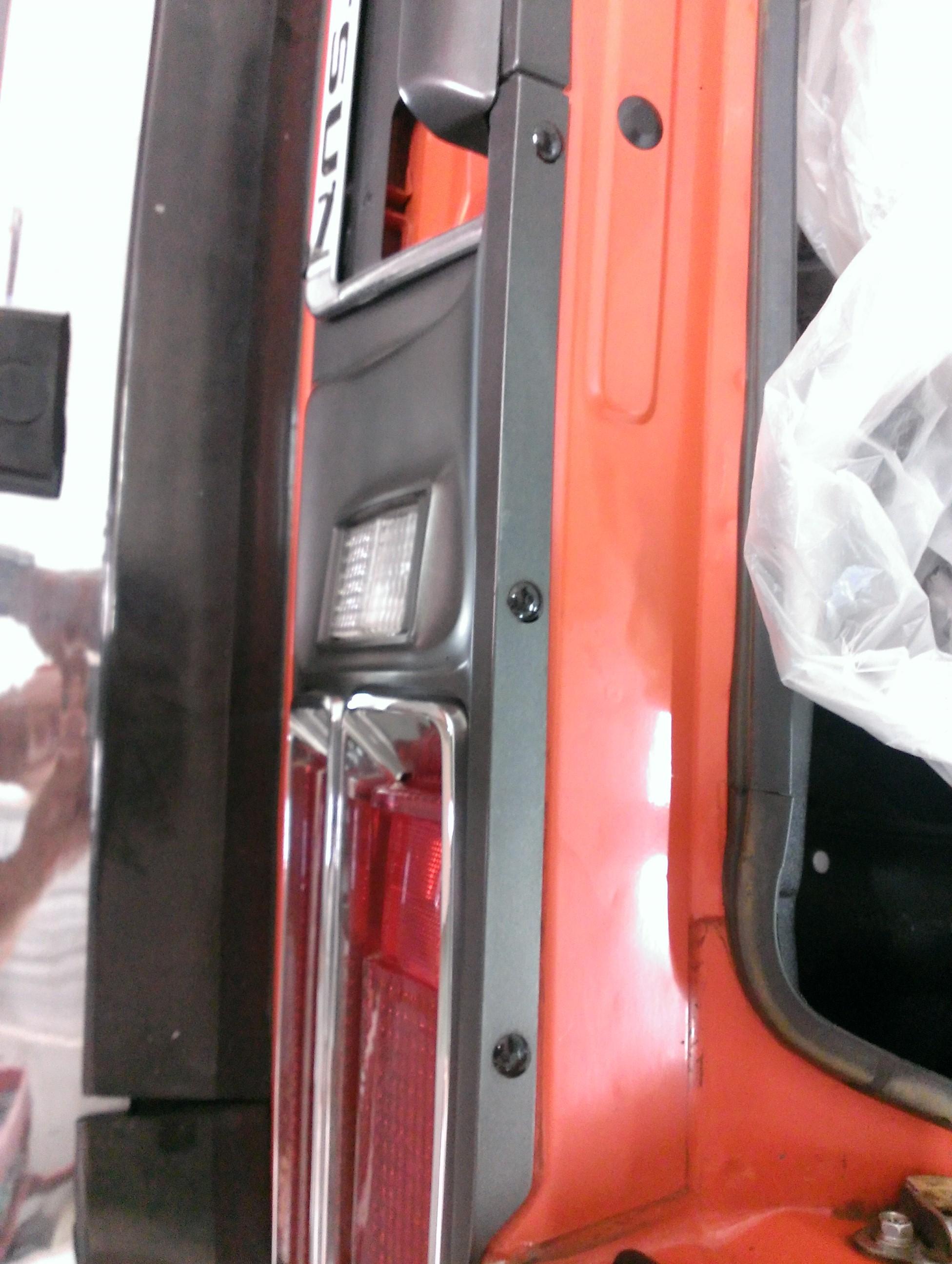

We had a 1975 280Z "Museum Car" in the shop for a few weeks a few years ago (4500 original miles, then kept in an auto museum in PA - shipped from the museum to our shop...).  The color was actually much lighter than I thought the original color would be (it shows a tad darker in these pics than IRL- the top of the license plate light actually shows the color best - that's not merely "light flare").  Here are some crappy pics I took of it:
