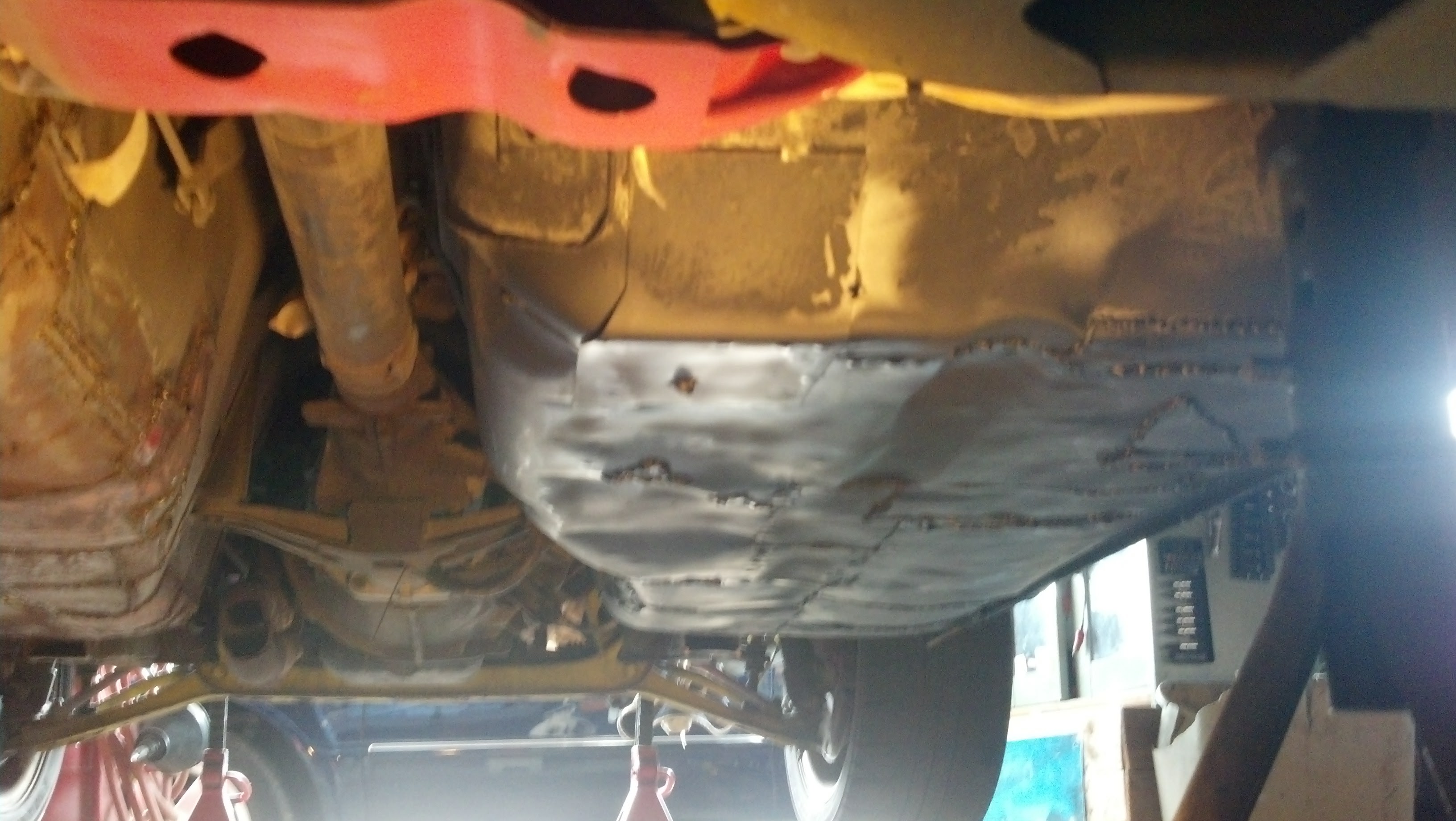

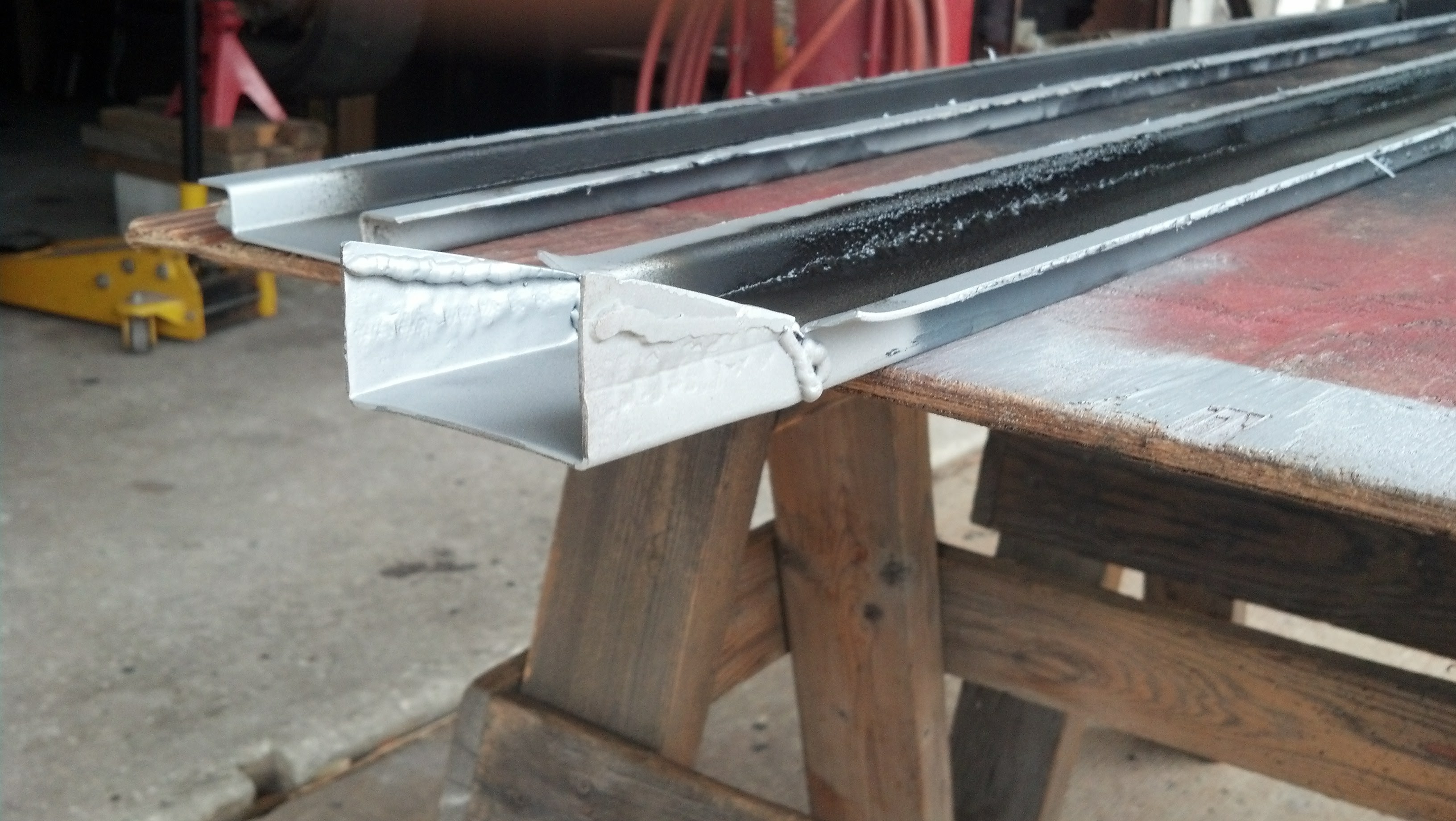

Ok RCB time for me to chime in. If you don't have welding skills already, DO NOT TRY THIS AT HOME. No one hear, least of all me, is trying to discourage you but no one wants to see you hurt, frustrated, or even worse end up with a pink elephant. Welding is a learned skill that is not picked up in a matter of hours. Welding above your head is even more tricky. My Father taught me how to when I was 16, now I am 59 and I actually held a job being paid as one, even still after so many years of not doing it I had to re-teach myself the technique when I began my restoration. The floor stiffeners on both sides of mine had to be replaced. Repairing was not an option. About 24 hours of work per side considering fitting and trimming. (See pics below). If you plan to do a lot of work with a machine purchasing one is a good option even a used one. But just to patch it is not really worth the expense. I bought a Lincoln 190C about 4 years ago and it has proven to be a valuable tool for what I needed to do. It uses an argon gas mix. No BS flux core foolishness. I really wished you lived nearby I would do them for you. I was fortunate enough to have a friend with a sheet metal business and after I cut out a section I gave it to him because of the U shape I needed. He did a nice job of recreating them using a thicker gauge of metal. I cut them to desired length and formed the front half so they joined the footwell transition nicely. There must be a shop around your area that could help you out even with just a patch. But don't cut corners. The art of welding produces more heat than you can imagine so if you plan on doing this repair at least peel the carpet back to the seat pedestals. Also when you start cleaning off the undercoat don't be surprised to see much more rust than you anticipated. It looks as if there was more than likely some water intrusion and the under coat may be the only thing covering it. But don't give up. Be resourceful and plan on the car being off the road for at least a couple of weeks. GOOD LUCK!
