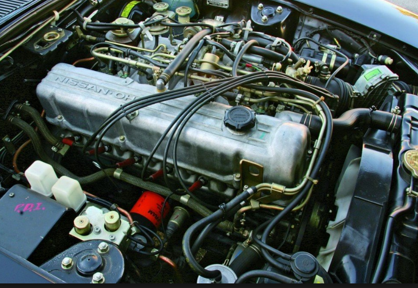

Removing the bolts would turn the engine in the normal direction.  Tightening will be backward.  Posted a picture I stole from Hemmings, showing fan direction.
