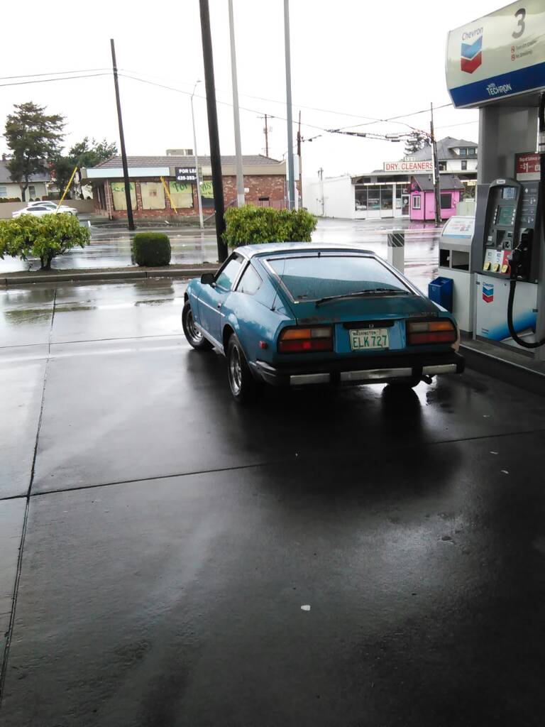

February 4, 20187 yr Author comment_541560 Replaced clutch/pilot/throwout with standard OEM spec Exedy kit, resurfaced flywheel, installed new OEM rear main oil seal/side seals/oil pan gasket along with transmission mount and engine mounts. I forgot to order some Redline MT-90, and put some dinosaur 80W90 GL4 because I just couldn't wait any longer to go test drive the work. I forgot what a difference that stuff makes. It'll be going back in it soon. Thanks for all the tips,pointers, and advice. That knowledge is worth more than any shop manual. Of course, manuals help. Now its on to eating more $3 per gallon fuel. Sent from my [device_name] using http://Classic Zcar Club mobile Link to comment https://www.classiczcars.com/forums/topic/59424-flywheel-removal/?&page=2#findComment-541560 Share on other sites More sharing options...
