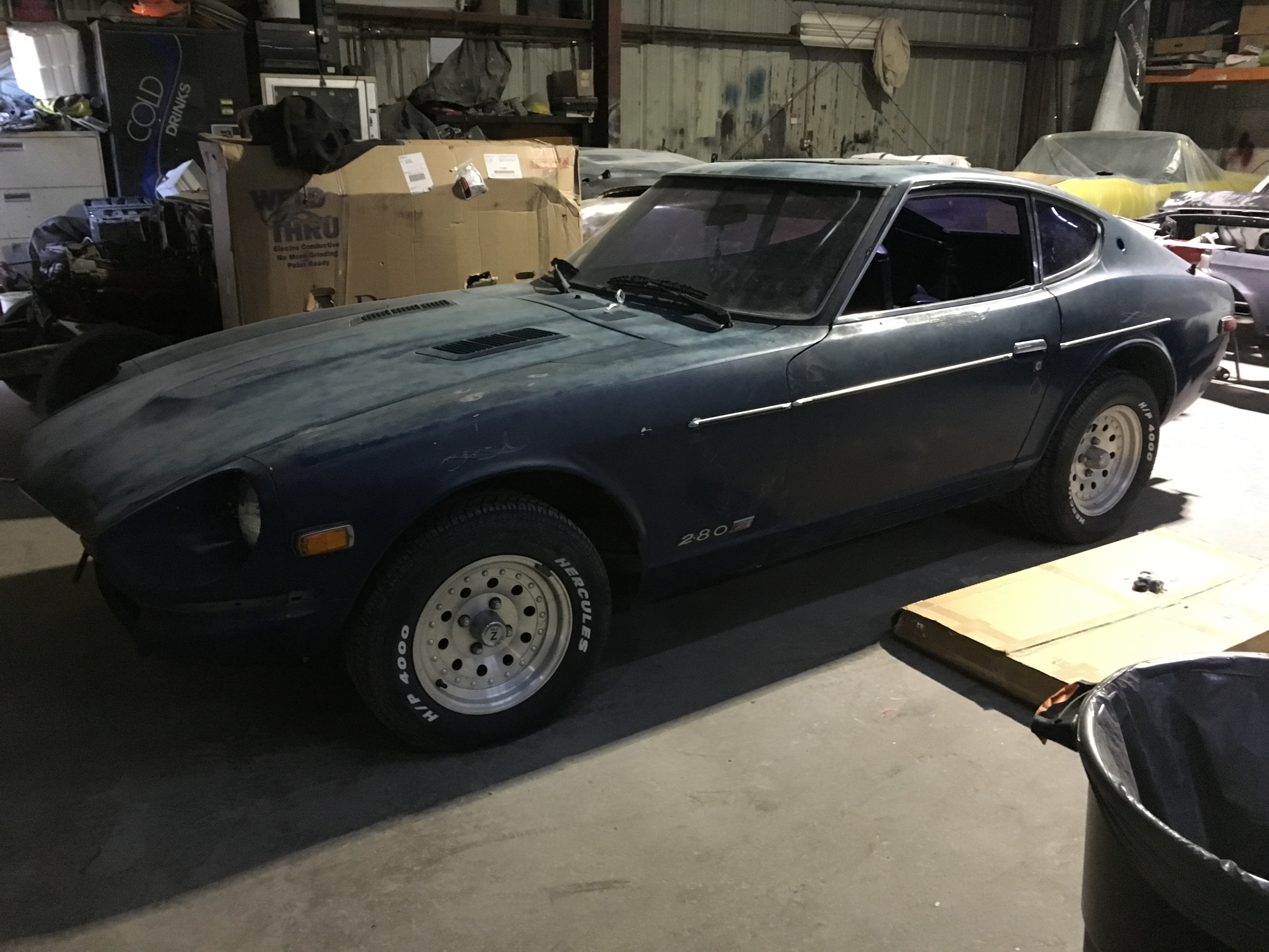

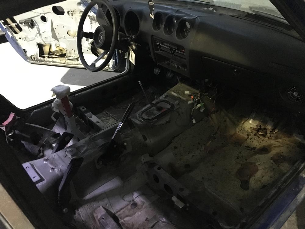

Posted January 30, 20187 yr comment_541082 So I'm getting started of the restoration work of my 1978 280z. The chassis repair and rust removal (replacement of floor pans and frame rails) and undercoating should be complete in a week or so. I am wondering what my best option is for the interior (top side) of the new floor pans. I am not planning on painting for a few months and I do not want to risk the floors rusting again. Should I apply undercoat (POR-15) to the interior as well? Also, I have access to a lot of Dynamat Xtreme and Superlite. Should I consider applying this to the interior while it is stripped? Basically I am a little confused as to the sequence of work on the interior now that the rust issue has (for the most part) been taken care of. This is my first real restoration.  When I do come to paint the car, I guess it would be wise to paint the interior as it is already stripped? Also – looking for suggestions for color. The car was originally silver but has been badly repainted blue at some point (engine bay and interior are still silver). I’m thinking of a gunmetal gray with bronze wheels and all trim powder coated black. Any thoughts?  At the moment I do not have the time or space for a frame up restoration (I am very aware that it would be a better way to do it but it’s not an option at this point so I don’t see the point in talking about it). So the order in which I am planning to do things is:  ·        Frame/Rust removal ·        Brakes ·        Suspension ·        Exhaust ·        Bodywork ·        Paint ·        Engine (L28 is running well but at some point I may consider a rebuild)  Apologies, this post is very messy, I tried my best to organize my questions but I want to do things in a logical order and avoid repeating or missing steps in the restoration. Any help would be appreciated. Link to comment https://www.classiczcars.com/forums/topic/59449-looking-for-advice-on-sequencing-of-restoration-work/ Share on other sites More sharing options...
January 30, 20187 yr comment_541106 In the current state (pictures above) I would pull the motor and transmission now. Â Pretty easy to get all that out of the way now. Your going to paint the engine bay and the steering rack will be accessible. Â Front suspension would be easier without the weight too. My $.02. Link to comment https://www.classiczcars.com/forums/topic/59449-looking-for-advice-on-sequencing-of-restoration-work/#findComment-541106 Share on other sites More sharing options...

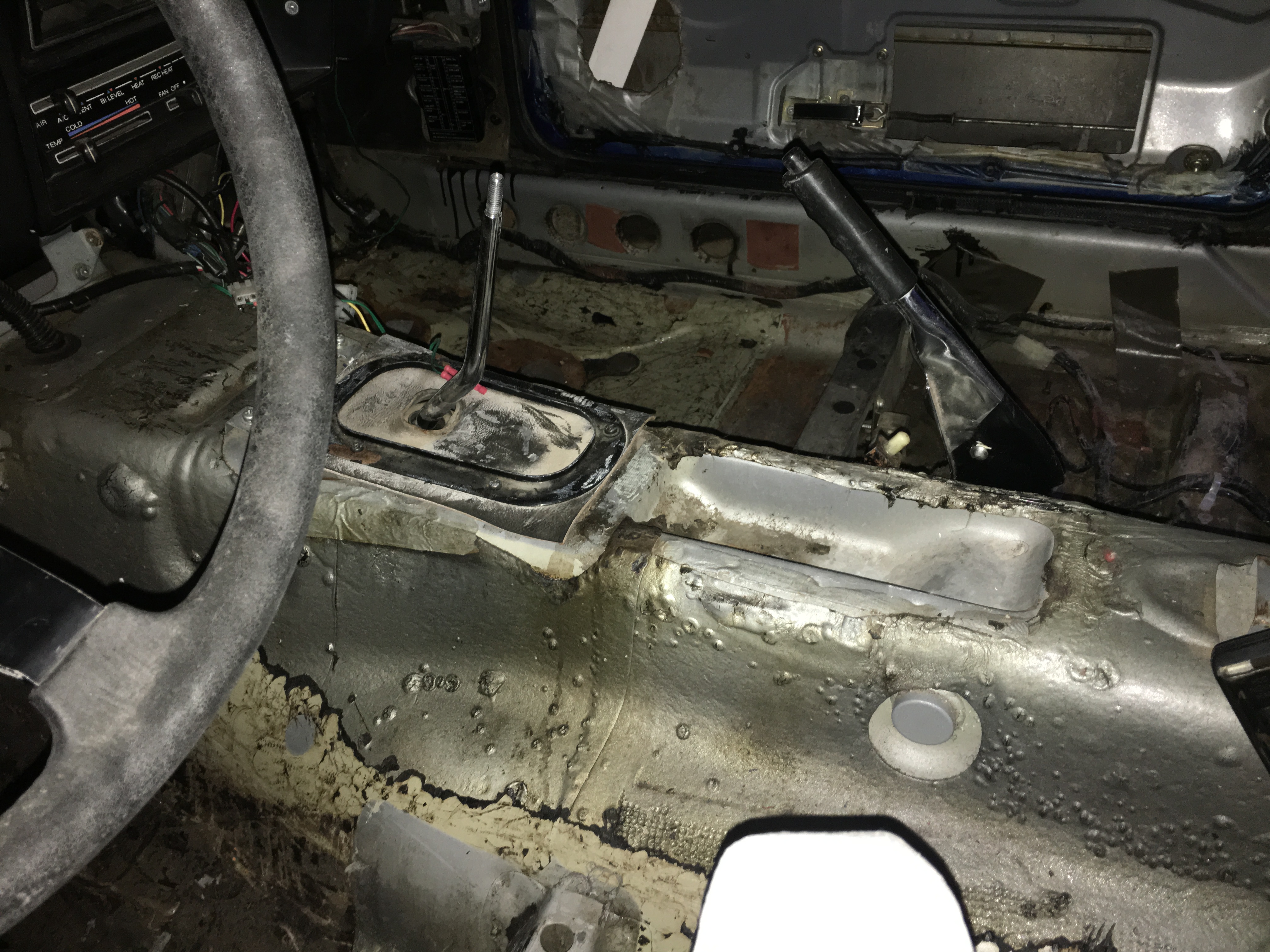

January 30, 20187 yr comment_541112 There's lots of ways you can tackle it but if your interior has been removed then that's as good as any place to start. Remove all the sound deadening tar that originally came on the car, it was installed over bare metal and sometimes you'll find big patches of rust under it. Clean all the interior surfaces with wax&grease remover, scuff it up well with 80 grit and clean it again before priming, Por15 can work well if you follow the instruction exactly but for my money you can't do better than 2 part epoxy primmer. By the way, that's a good choice on colour and wheels Link to comment https://www.classiczcars.com/forums/topic/59449-looking-for-advice-on-sequencing-of-restoration-work/#findComment-541112 Share on other sites More sharing options...
January 30, 20187 yr Author comment_541130 Thanks for the replies.  Ok, so does this make sense as a rough plan moving forward: - Once floor pan and frame rail work is done, undercoat using POR-15 (A specialist is doing this, not me, so I believe POR-15 is a good way to go). - I'll clean up the interior and get it ready for primer. Dynamat Xtreme on top of primer. - Take care of some bodywork such as shaving and filling, fix any dents, etc. - Pull motor and transmission and send body for media blasting. - This would be a good time to do brake and suspension work. - Paint exterior and engine bay. - Assembly.  Couple of questions: 1. grannyknot - what epoxy primer do you recommend for interior application? 2. grannyknot - Beautiful car, is that an original color? If so what's the code/name? 3. After media blasting, am I right in saying I need to get the car to primer straight away? (In my experience after sandblasting, steel rusts extremely fast as it is so exposed) 4. Is the interior typically installed over primer, or is there a finish coat applied on the interior aswell? I normally see cars being painted with the interior taped and covered so only the exterior and engine bay receive color?  Again apologies if some of these questions are pretty obvious to some, as I said, it's my first restoration and I'm keen to learn the process. Link to comment https://www.classiczcars.com/forums/topic/59449-looking-for-advice-on-sequencing-of-restoration-work/#findComment-541130 Share on other sites More sharing options...

January 31, 20187 yr comment_541209 20 hours ago, Kevin McSweeney said: Couple of questions: 1. grannyknot - what epoxy primer do you recommend for interior application? 2. grannyknot - Beautiful car, is that an original color? If so what's the code/name? 3. After media blasting, am I right in saying I need to get the car to primer straight away? (In my experience after sandblasting, steel rusts extremely fast as it is so exposed) 4. Is the interior typically installed over primer, or is there a finish coat applied on the interior aswell? I normally see cars being painted with the interior taped and covered so only the exterior and engine bay receive color? There are quite a few 2k epoxy primers brands, any good paint shop can put you on to them. But once you have picked a brand stay with it for all the different coats, don't mix and match different companies, it's just safer. Thanks, not original, Jeep colour, anvil grey. If you are going to media blast then I would say do it all at once, interior and exterior, then prime the inside and outside at the same time.  Personally I would skip the POR15, it won't work well with standard primers and paint and won't offer more protection than a properly prepared body with standard products Link to comment https://www.classiczcars.com/forums/topic/59449-looking-for-advice-on-sequencing-of-restoration-work/#findComment-541209 Share on other sites More sharing options...
