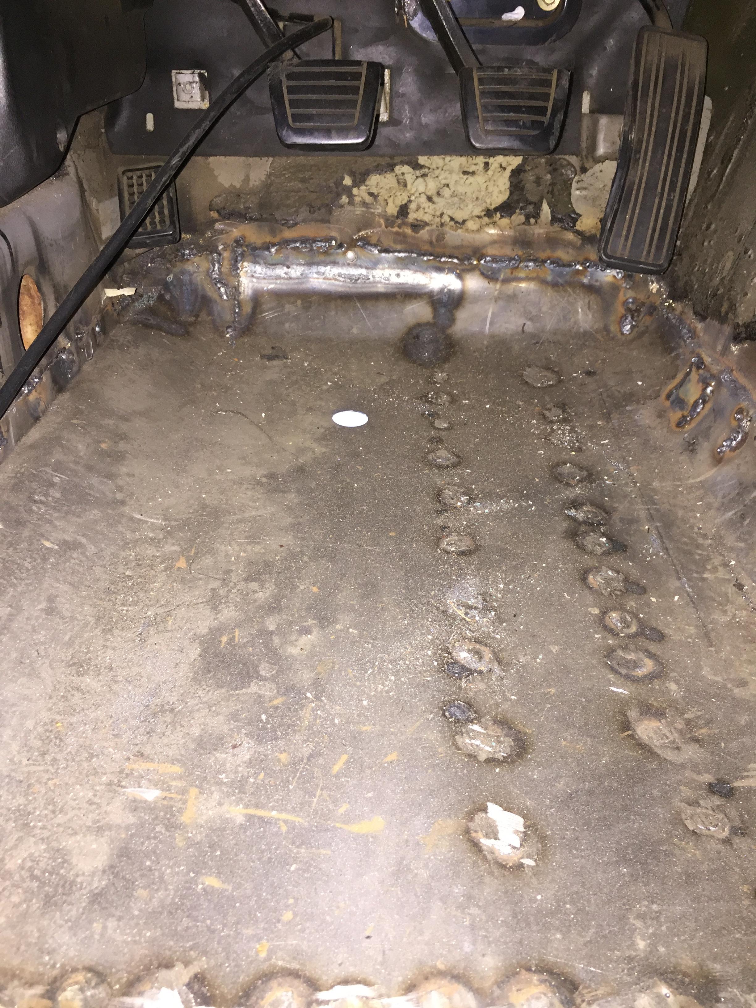

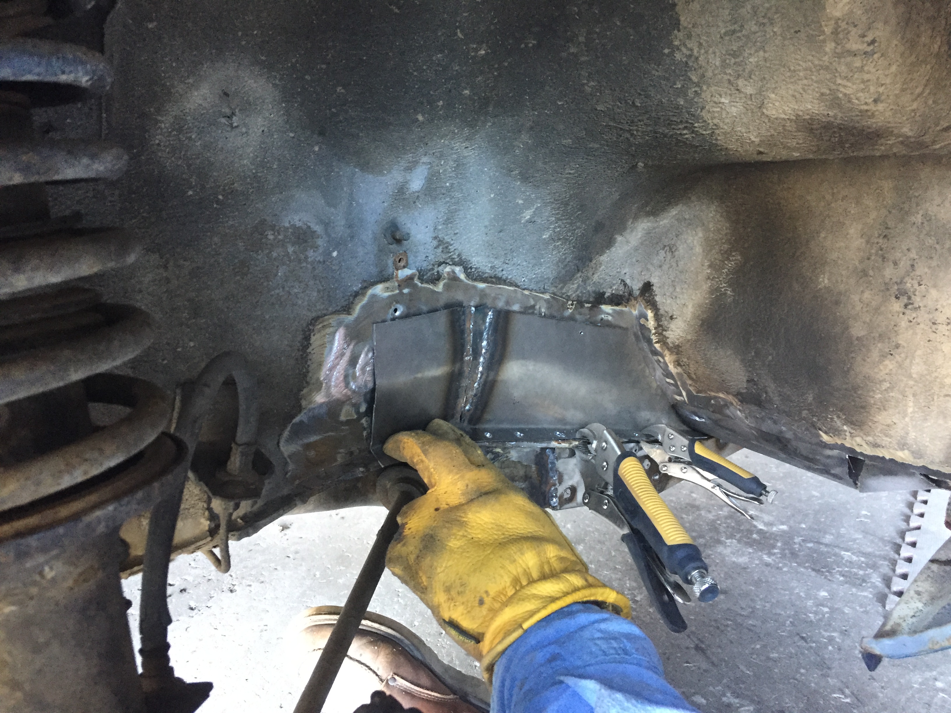

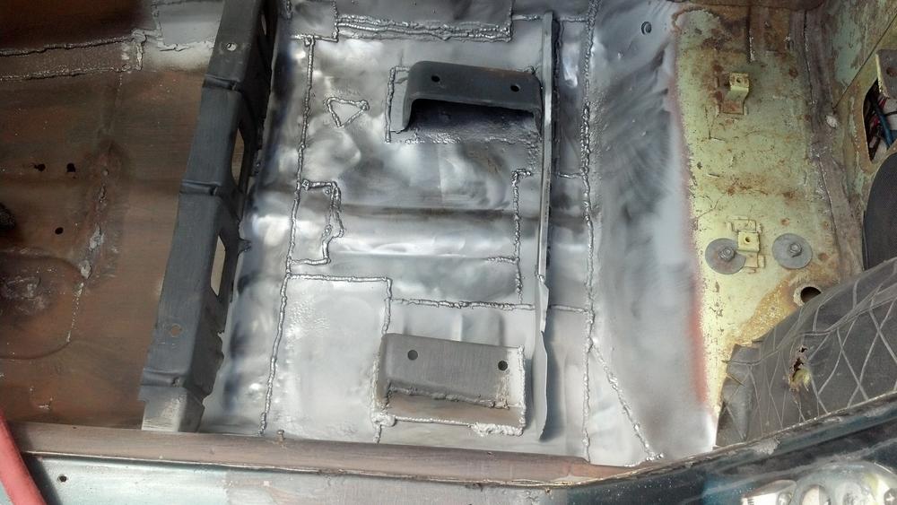

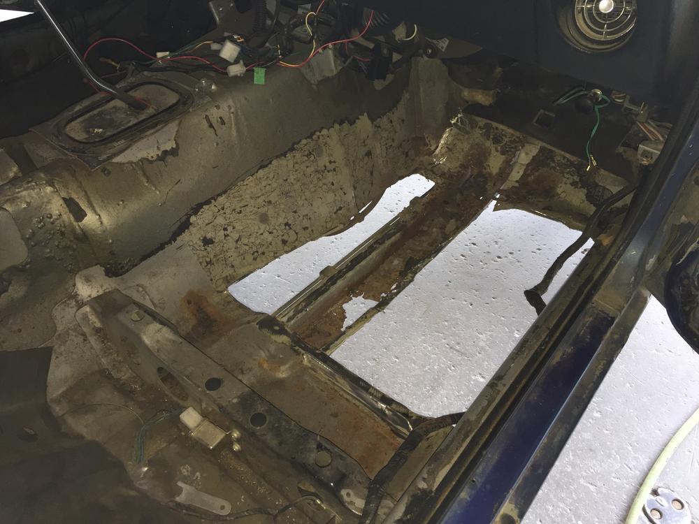

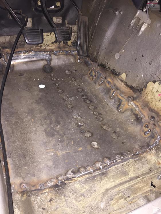

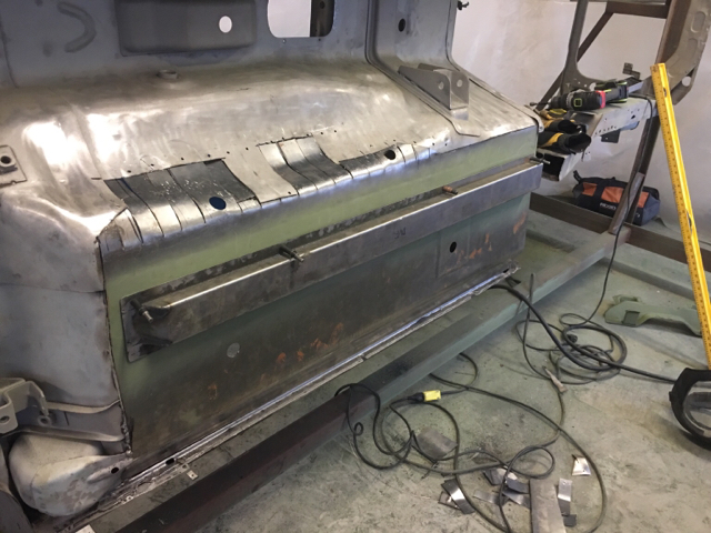

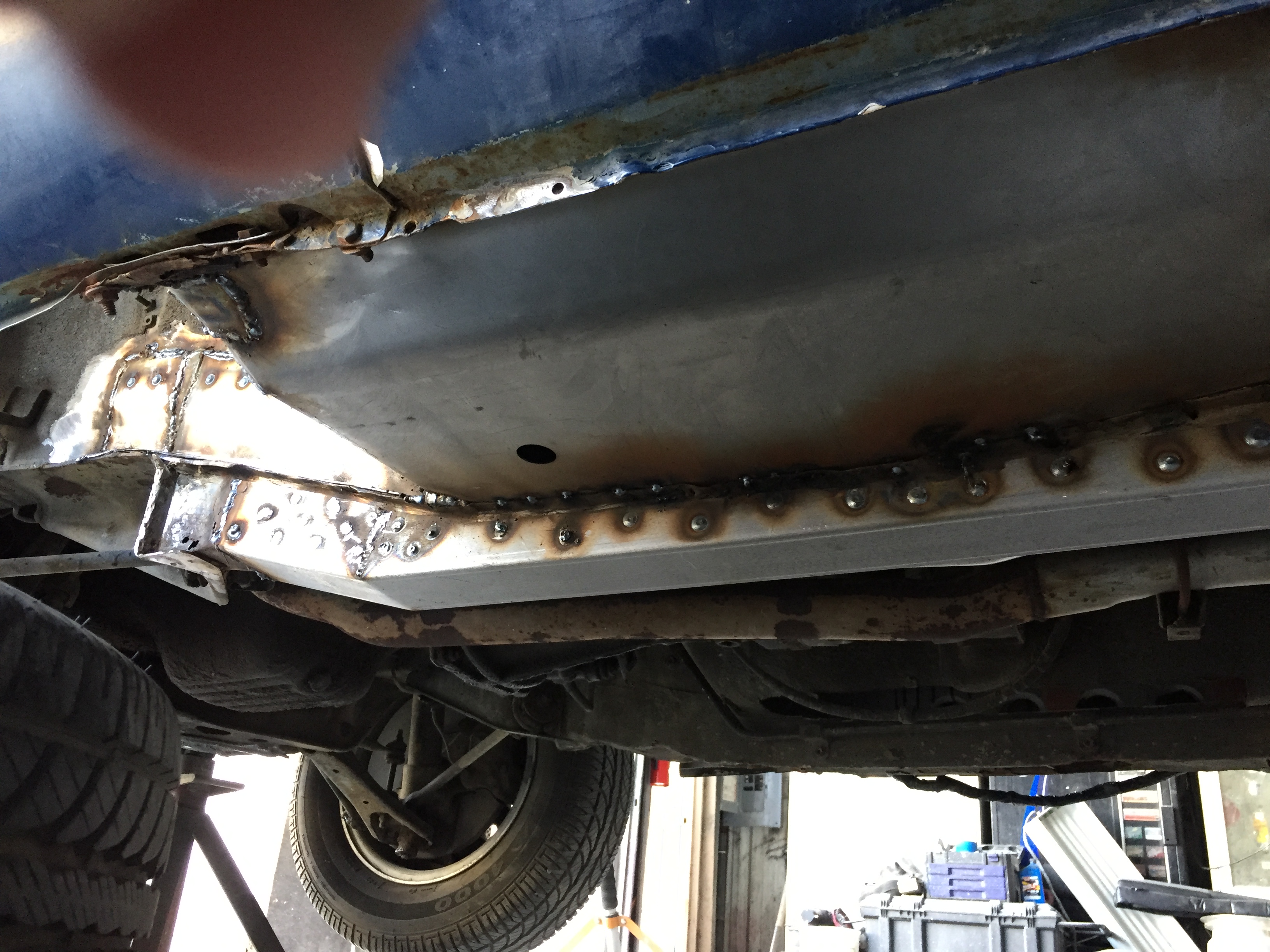

February 1, 20187 yr Author comment_541324 Bit of an update: Drivers side floor pan and frame rail (along with some additional work to the front rail and firewall) is almost done. Just need to grind smooth and tidy up. Working on the passenger side now as you can see from the last photograph. There have been bad repairs done to this previously, including what looks like some aluminum and fiberglass work on the floors. Hopefully I've got the worst of the rust!  Not sure whether I was sent the wrong year floor pans or whether it's just the way they are, but they needed a lot of work to fit and I still needed to do additional metal fabrication. Link to comment https://www.classiczcars.com/forums/topic/59449-looking-for-advice-on-sequencing-of-restoration-work/?&page=2#findComment-541324 Share on other sites More sharing options...
February 1, 20187 yr comment_541331 Looks about right.... my floor pans required extensive mods too. You at least avoided the "bump" for the catalytic converter in the floor. http://www.classiczcars.com/forums/topic/50908-1976-280z-restoration-project/?do=findComment&comment=489753 Edited February 2, 20187 yr by wheee! Link to comment https://www.classiczcars.com/forums/topic/59449-looking-for-advice-on-sequencing-of-restoration-work/?&page=2#findComment-541331 Share on other sites More sharing options...
February 2, 20187 yr comment_541334 1 hour ago, wheee! said: You at least avoided the "bump" for the catalytic converter in the floor. Lucky! What I'm going to have to deal with soon. The "bump" Good progress man, keep it up. Link to comment https://www.classiczcars.com/forums/topic/59449-looking-for-advice-on-sequencing-of-restoration-work/?&page=2#findComment-541334 Share on other sites More sharing options...
February 2, 20187 yr comment_541336 Nice work KEV. There is something to be said about someone that knows kow to use a MIG on paper thin sheet metal. Although I must say that the areas you are working on are a tad thicker but nonetheless tricky. Looks like my floors a few years ago. STAY ON IT! Link to comment https://www.classiczcars.com/forums/topic/59449-looking-for-advice-on-sequencing-of-restoration-work/?&page=2#findComment-541336 Share on other sites More sharing options...
February 2, 20187 yr comment_541337 Nice work KEV. There is something to be said about someone that knows kow to use a MIG on paper thin sheet metal. Although I must say that the areas you are working on are a tad thicker but nonetheless tricky. Looks like my floors a few years ago. STAY ON IT! Link to comment https://www.classiczcars.com/forums/topic/59449-looking-for-advice-on-sequencing-of-restoration-work/?&page=2#findComment-541337 Share on other sites More sharing options...

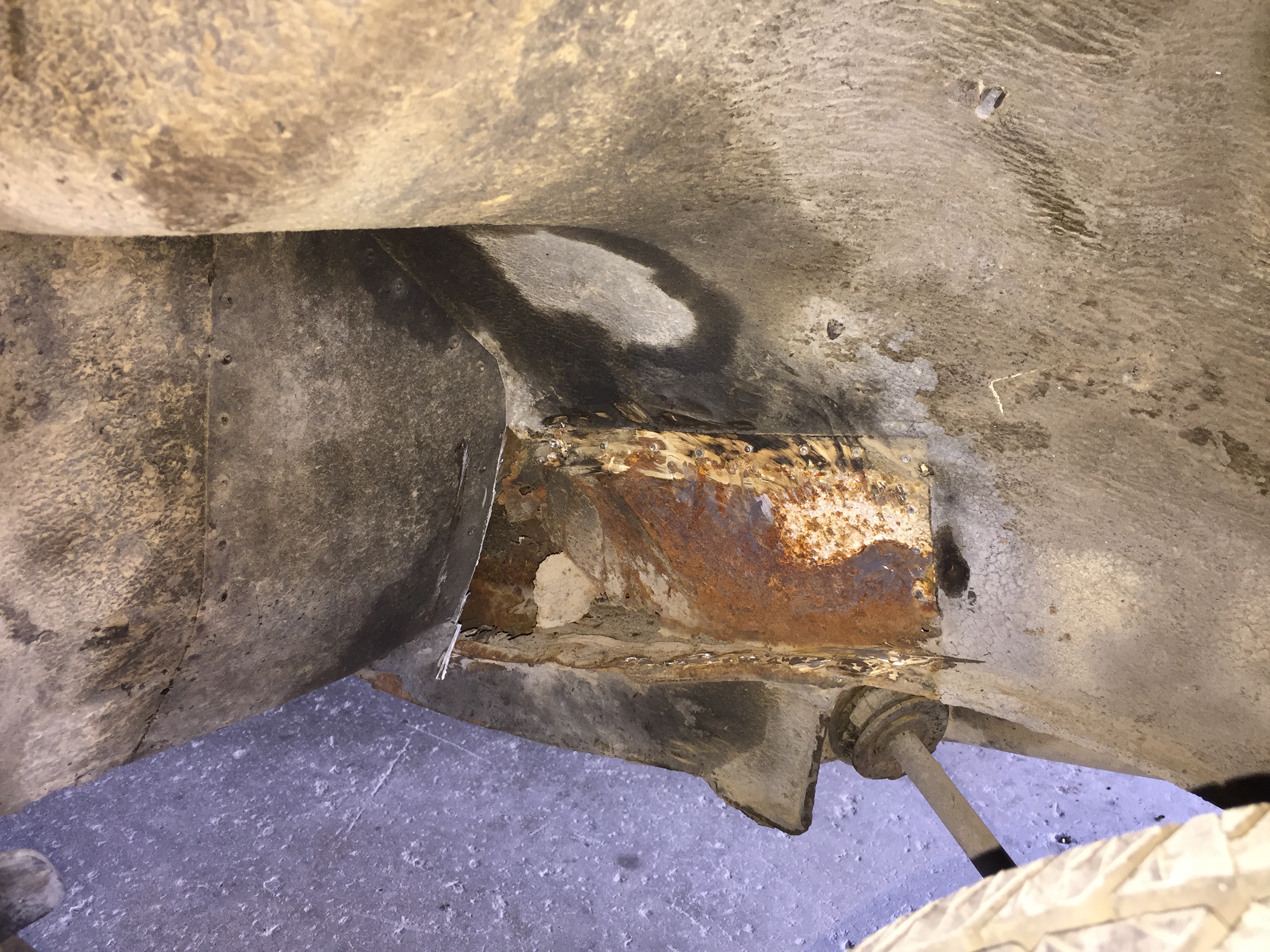

February 2, 20187 yr comment_541371 Kev: Looking good. You might consider taking that front fender off. I think that you will find the front of the rocker is rusted out too. You can get new rockers from tabco. I cut the front off of these and used them for a replacement. It's a pretty common trouble spot. Link to comment https://www.classiczcars.com/forums/topic/59449-looking-for-advice-on-sequencing-of-restoration-work/?&page=2#findComment-541371 Share on other sites More sharing options...
February 3, 20187 yr Author comment_541436 22 hours ago, ksechler said: Kev: Looking good. You might consider taking that front fender off. I think that you will find the front of the rocker is rusted out too. You can get new rockers from tabco. I cut the front off of these and used them for a replacement. It's a pretty common trouble spot. Currently home in Ireland for a few days, I’m planning on taking the fenders and hood off next week as I have a bit of work to do on them. I’ll definitely look at the front of the rockers. The back portion, and actually the back of the car in general looks largely rust free which is nice! Link to comment https://www.classiczcars.com/forums/topic/59449-looking-for-advice-on-sequencing-of-restoration-work/?&page=2#findComment-541436 Share on other sites More sharing options...
