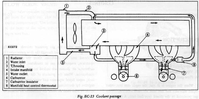

February 2, 20187 yr comment_541372 14 hours ago, Halvernaz said: I'm going back to the original SU's from Webber's and though it was a good time to remove the carb lines. The original thermostat also no longer works. I live in San Diego and only drive the car in nice weather so really don't need the heat. I only mention it because there are some applications where the coolant is used to heat a spot at the bottom of the manifold to mitigate any fuel pooling from throttle changes. It doesn't matter what the ambient conditions are. Maybe just carbs with accelerator pumps? It's been 35 years since I've wrenched on a Z so I've forgotten most of the details. I haven't dug into my cooling system yet to see if this is the case with a Z. Edit: I just looked at the cartoon at the top of the page and it looks like this is the case, there seems to be heating spots in the manifold. Anybody know for sure? Edited February 2, 20187 yr by BDJeff Link to comment https://www.classiczcars.com/forums/topic/59465-removing-the-carburetor-water-cooling-lines/#findComment-541372 Share on other sites More sharing options...
