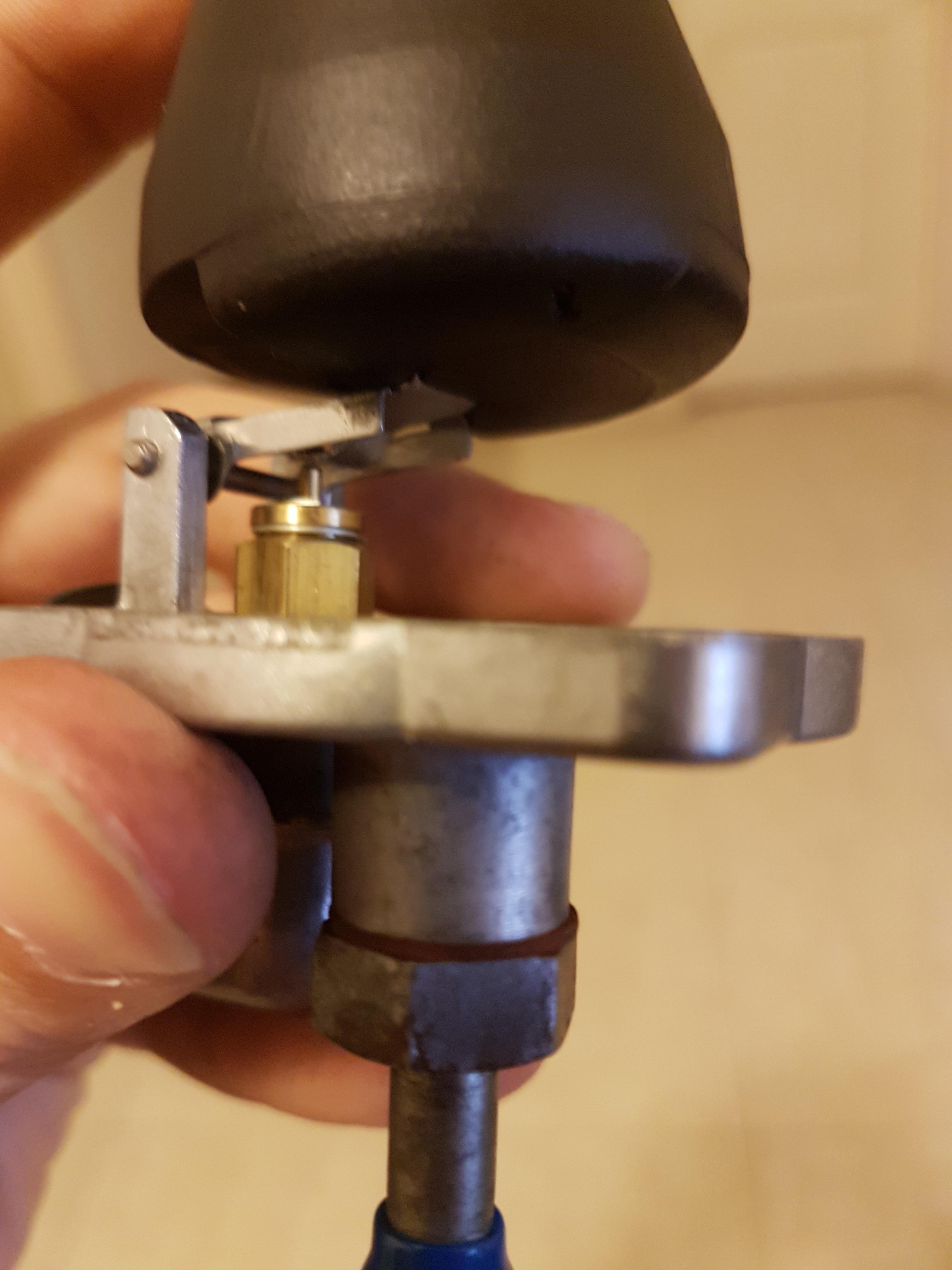

Come man. Its really difficult to get the .55 inch gap from the bottom of the lid to the top of the float without pressing the needle valve stem. Am i doing something wrong. The su carb dvd is for su carbs with gross jets not needle and valve. 2 hours trying to adjust without any success.

Two hours isn't enough. It can be an all day job unless you're lucky and get them both right the first few tries.  I don't think that method is the most accurate anyway. If your tang adjustment is off by 1/32" it's going to be wrong. Make the smallest possible adjustments and test with sightglass or by seeing fuel levels in the nozzles each time.

The best thing to do is get them opening and closing right side up not upside down like the Just SUs DVD shows.
You are so right. I talked with Bruce at ZTherapy and he specifically told me that NOT UPSIDE DOWN ... regardless of what your version of "Just SUs" you have. (Mine is by the original owner. In VHS with a 1996 date!)
He said, as you do, to hold the lid and float assembly just as it is oriented when installed. That means RIGHT SIDE UP. Blow into the gas line and slowly raise the float. When the flow stops, that's what you need to measure. On/Off. The distance from the top to the top of the float should be 0.55 inches. But, he also said this is not rocket science, close is good enough until you really start fine tuning. (Living in a digital world it kind of hard to think of "good enough" working. At least I do.)

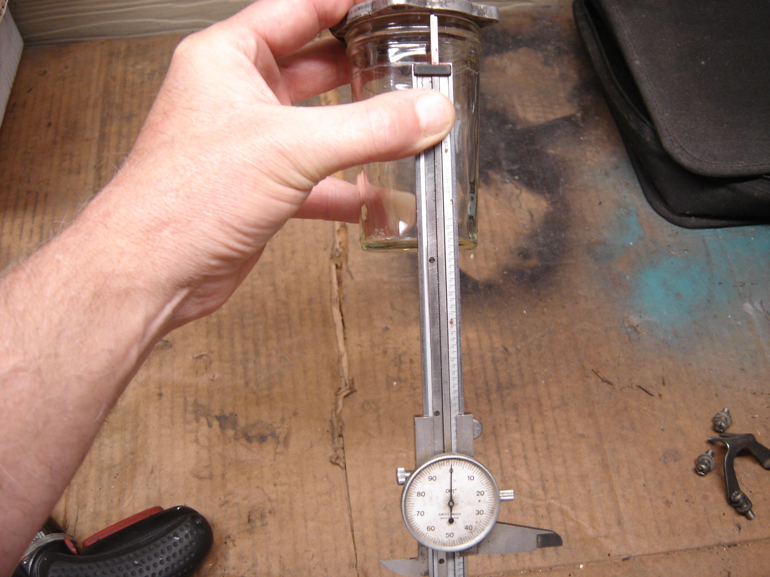

Can you explain this rig?
I did this a year or two ago so things get fuzzy but here goes.
After much reading I took a small glass jar that my floats could move up and down without hitting the sides, made a mark 23mm down from the roof of the float chamber lid.
Then I hooked up a low pressure fuel pump, running out of a gas jug to the float lid bung.  Hooked the pump to a battery and after a few tries I got the float tangs bent just right so the valves shut off at the line.  23mm down from the roof.  It was the dead of winter and I had nothing else to do and after doing this my 240 runs better than ever.  Plenty of fuel where before they were starved.  I found this out going up a steep mountain one day and the car started running so poorly it wouldn't pull anymore.  I was running off the back carb only, 3 cylinders.  I rolled the car backwards and cut the steering wheel so it was perpendicular to the road.  The bowls filled up and I could go about another quarter mile up the mountain.  Took about three or four times to reach the top. :rolleyes:
Here's my setup.  Click on "siteunseen replied to a topic" and you'll see all the pictures.  If you need more info maybe can help, let me know.  Cliff
