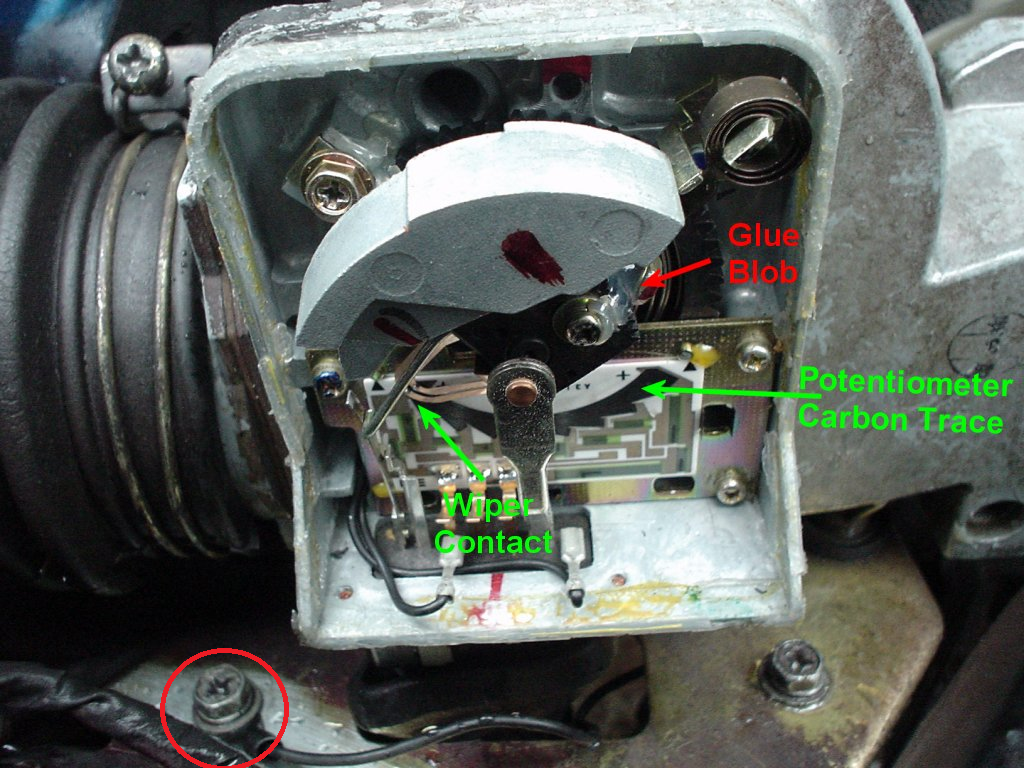

February 15, 20187 yr comment_542399 Make sure the vane is moving easily behind the black plastic cover and the wipe path is clean and dry. On the AFM. Link to comment https://www.classiczcars.com/forums/topic/59547-runs-rich-wont-rev-past-2-3k/#findComment-542399 Share on other sites More sharing options...

February 15, 20187 yr Author comment_542420 The only test I can find for the vain itself is a voltage test. Is it possible to check simply with resistance if it is functioning correctly? Link to comment https://www.classiczcars.com/forums/topic/59547-runs-rich-wont-rev-past-2-3k/#findComment-542420 Share on other sites More sharing options...
February 15, 20187 yr Author comment_542421 Sure would be upsetting to find that ground wire to be the issue. One AFM has a ground wire while the other does not? I will try the one with the wire grounded well but I doubt that is the issue as I recall checking that a while ago Link to comment https://www.classiczcars.com/forums/topic/59547-runs-rich-wont-rev-past-2-3k/#findComment-542421 Share on other sites More sharing options...
