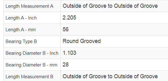

Check the dimensions against the specs. in this link - https://www.opticatonline.com/part/moog-driveline-products-393-universal-joint
Looks like 56mm from outer groove edge to outer groove edge.  Maybe you got the right box/wrong product.
