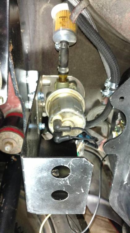

February 20, 20187 yr comment_542838 Hopefully useful reference: 17033-E4200 Electric Fuel Pump Bracket, as used on S20-powered cars from 1969: Mine, with NISMO-branded, Jidosha Kiki-made, Bendix-licensed pump: Â Â Edited February 20, 20187 yr by HS30-H Swapped photos Link to comment https://www.classiczcars.com/forums/topic/59571-bracket-for-1972-electric-fuel-pump-upgrade/#findComment-542838 Share on other sites More sharing options...
February 20, 20187 yr comment_542839 There are actually a couple of these for sale on eBay. One with the same part number that HS30-H mentions in his post: https://www.ebay.com/itm/Datsun-Z-fuel-pump-mount-mounting-bracket-17033-E4200-USED/382363930288?hash=item5906aa8eb0:g:zwQAAOSwkLhaG5cd&vxp=mtr And another that is identical to the one on my late manufacture 260Z: https://www.ebay.com/itm/77-78-Datsun-280Z-fuel-pump-bracket-OEM-used-painted-clean/382374963056?hash=item590752e770:g:RAEAAOSwHNxaTa88&vxp=mtr Ironically both from the same seller. Looks like Nissan changed the design of this over the years. Mike. Link to comment https://www.classiczcars.com/forums/topic/59571-bracket-for-1972-electric-fuel-pump-upgrade/#findComment-542839 Share on other sites More sharing options...
