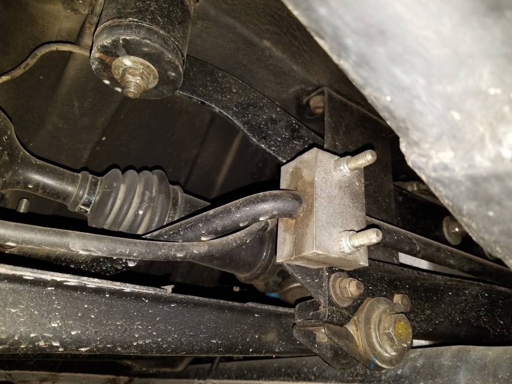

This is a BRE rear sway bar on my 71Z.
The aluminum blocks that I use eliminate any play. I use white lithium grease. There is no wear on the bar after all these years. 20180223_144544.jpg
