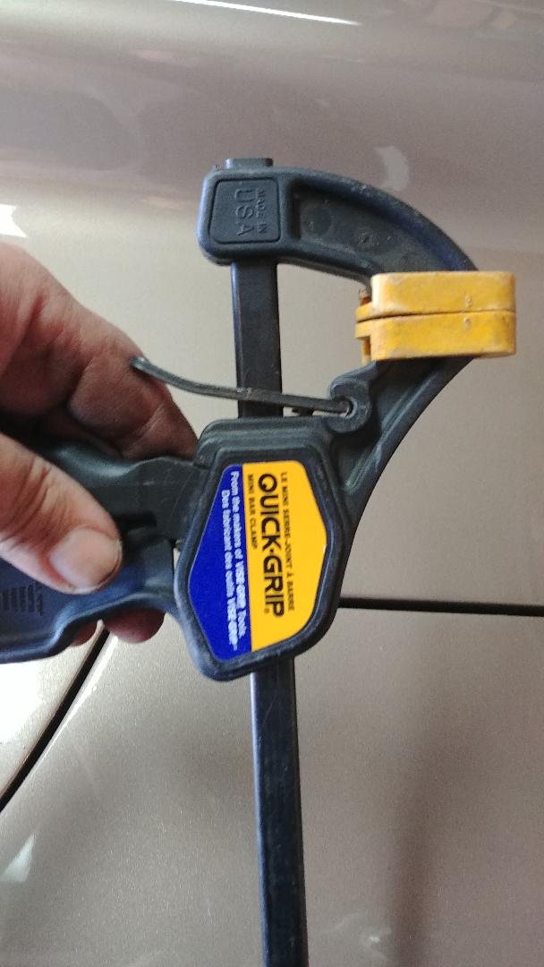

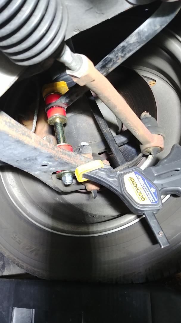

Posted February 26, 20187 yr comment_543300 Finally got around to installing my new end links from Zcardepot. Bought the kit from them. $20 + shipping. As you can see in the pics I had help. My handy dandy quick grip clamp from H.F. Worked perfect. Was able to do the install without adding any weight to the corners like you read in some of the forums. An hour job total time. While I was under there I took a look around and things sure are oily under there. I think most of it is coming from my front main! Oh well, guess I'll do that next. Link to comment https://www.classiczcars.com/forums/topic/59605-end-links/ Share on other sites More sharing options...

February 27, 20187 yr comment_543333 I have used a floor jack in the past to compress the suspension enough to get the end link. In that case, the car was on jackstands, and I used the floor jack under the tire to do the trick. Link to comment https://www.classiczcars.com/forums/topic/59605-end-links/#findComment-543333 Share on other sites More sharing options...

February 27, 20187 yr Author comment_543351 I actually had mine on ramps. Worked pretty well until I needed to compress the suspension just a little. That clamp made quick work of it. 3 hours ago, gwri8 said: Fat fingers in narrow places Haha! That's my problem as well. Besides the front seal leaking I also discovered that my aluminum rad has a leak A tiny one though. Going to call around and see who can fix aluminum rad's. It's only 5 years old. Really doesn't have many miles on it either. Edited February 27, 20187 yr by rcb280z Link to comment https://www.classiczcars.com/forums/topic/59605-end-links/#findComment-543351 Share on other sites More sharing options...
