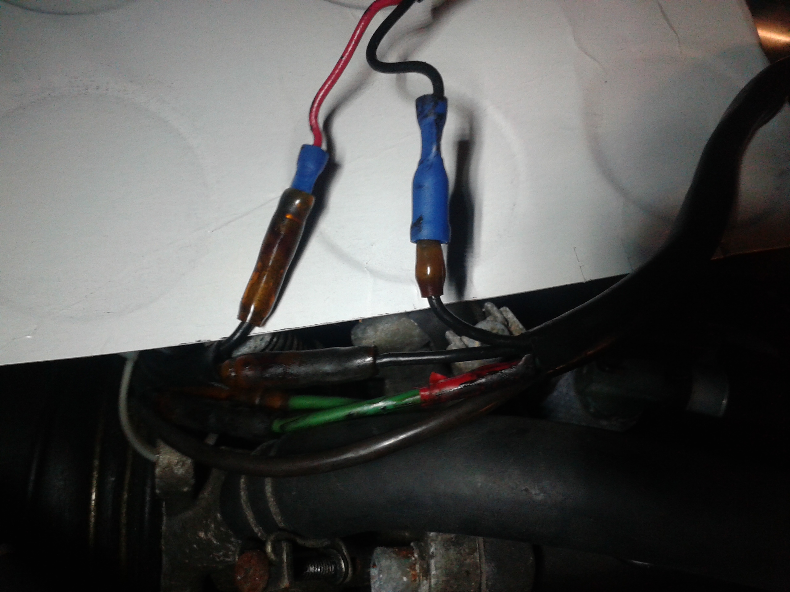

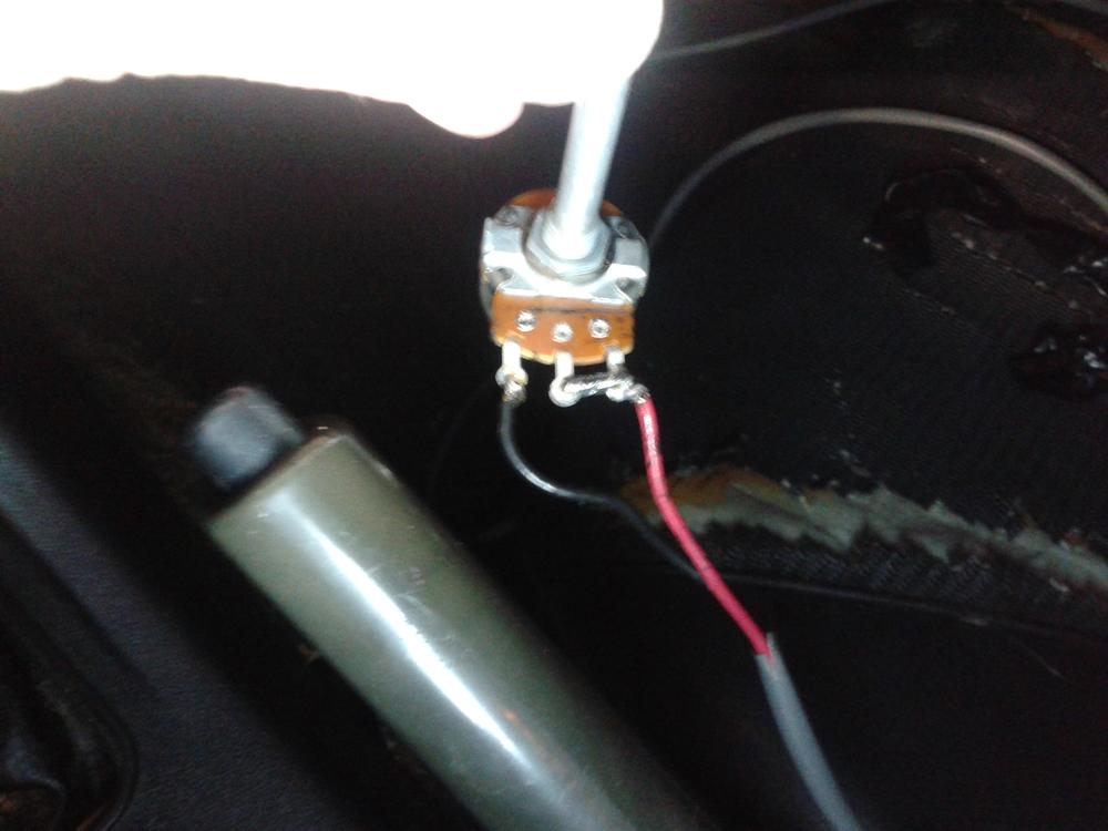

February 27, 20187 yr comment_543327 10 hours ago, DC871F said: What symptoms are you trying to remedy with the added resistor on fuel injection? Running like crap up to 2,500 rpm for me. Mine would stumble and then pick up, almost like a bucking bull. Spilt beer all over crotch. Here's what I went by, cost about $5 from radio shack when I did it. I ran mine into the cabin to play with while driving. You put it in between the existing wiring bullet connectors behind the thermostat housing so no damage or splicing the original wiring if it doesn't help. http://atlanticz.ca/zclub/techtips/tempsensorpot/index.html Link to comment https://www.classiczcars.com/forums/topic/59607-resister-tweak-for-fuel-injection/#findComment-543327 Share on other sites More sharing options...
February 27, 20187 yr Author comment_543330 3 hours ago, Reptoid Overlords said: Although I've not done it myself, I believe one adds the resistor inline with the CHTS to remedy a lean/rich fuel condition. Sent from my [device_name] using http://Classic Zcar Club mobile I installed the resistor that you can get at ZCardepot when in was troubleshooting the car in the past. My question is what symptoms are some of you seeing whether a lean or rich condition exists. Link to comment https://www.classiczcars.com/forums/topic/59607-resister-tweak-for-fuel-injection/#findComment-543330 Share on other sites More sharing options...

February 27, 20187 yr Author comment_543361 3 hours ago, Zed Head said: Stumbling and popping back through the intake manifold at low to mid-range throttle openings. Ok. So mine is stumbling at low RPM when starting off from a a dead stop until about 1500-2000 RPM, smooth otherwise. I have adjusted the resistor many times, without much success. Does anyone have a resistance number that seems to work if measured? Link to comment https://www.classiczcars.com/forums/topic/59607-resister-tweak-for-fuel-injection/#findComment-543361 Share on other sites More sharing options...

February 28, 20187 yr comment_543413 6 hours ago, Dave WM said: building a circuit that uses an 02 sensor to approximate the function of this pot in the same circuit. Now there's a concept I've never seen mentioned anywhere ever before!!! Wonder how much market there would be for something like that! HAHA! One thing to keep in mind though, is that the resistor trick can only be used to supply additional fuel, not take any away. The leanest it's going to run is with the sensor connected directly with no extra auxiliary resistance. So if you're going to use a microprocessor to adjust a "resistor" based on O2 feedback, the first thing you'll have to do is adjust the original system so that it runs lean. That way, the processor can add in additional resistance to compensate. Yes, I think it could work. No, I'm not going to do it. Link to comment https://www.classiczcars.com/forums/topic/59607-resister-tweak-for-fuel-injection/#findComment-543413 Share on other sites More sharing options...
