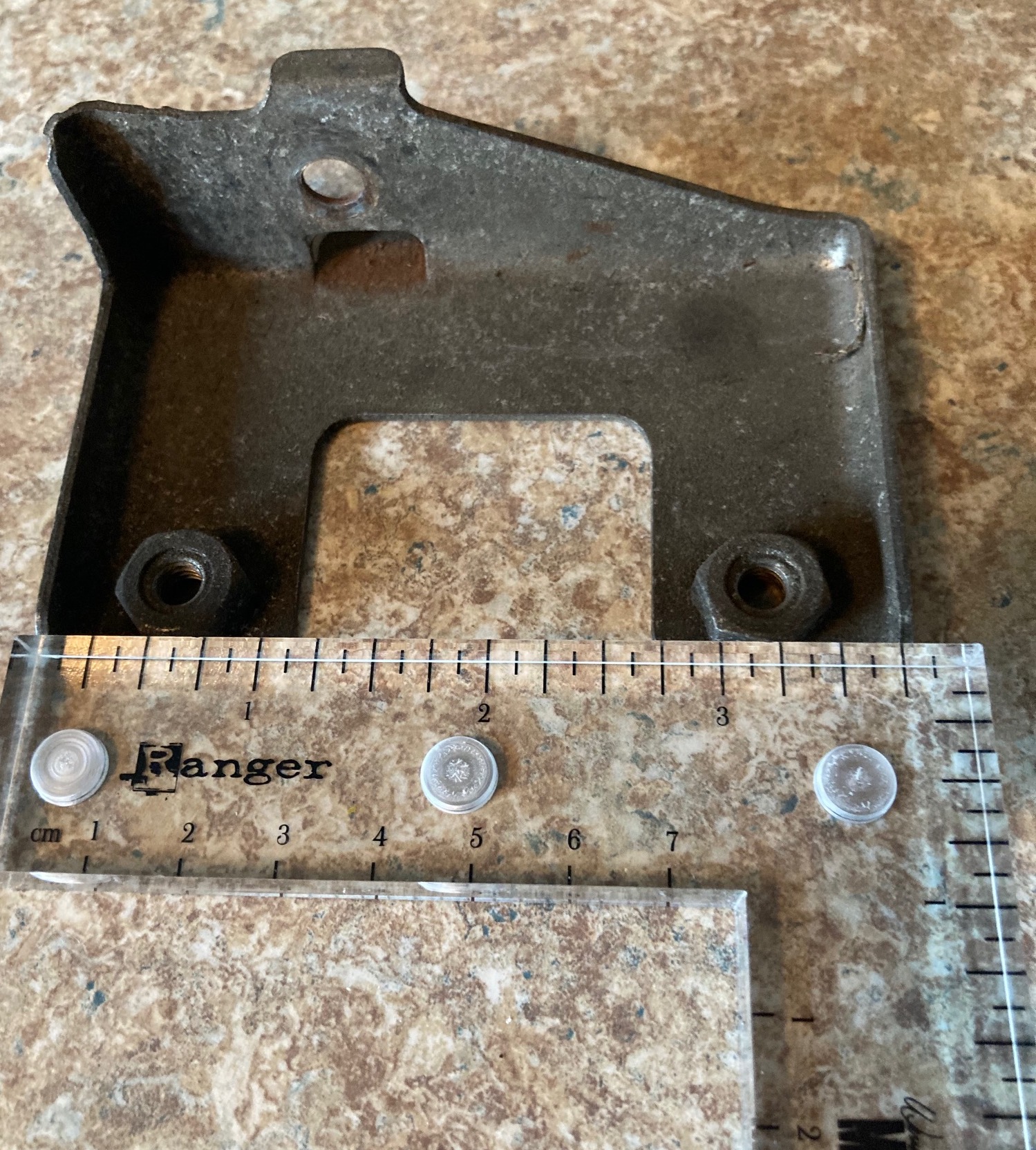

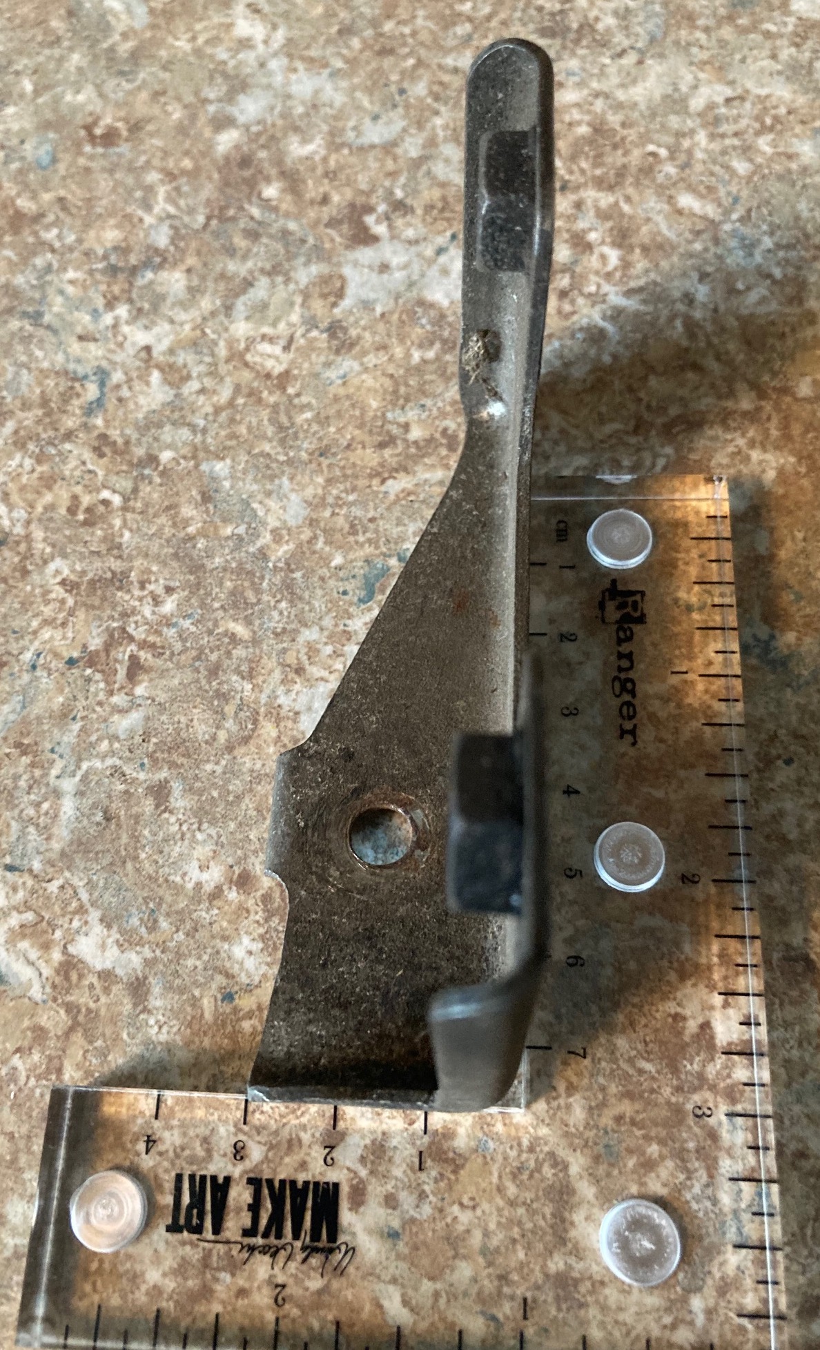

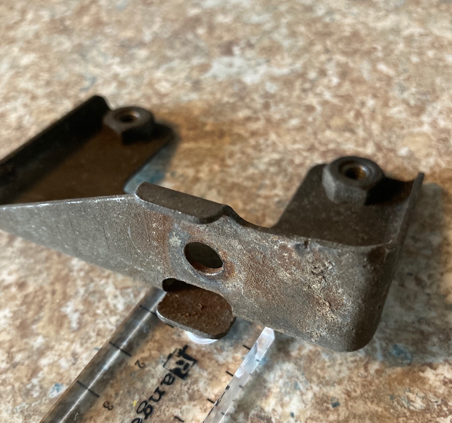

3 hours ago, gwri8 said:
I don't have a clear shot of the lower bracket but these should give you the idea.
Your pic's helped me Greg, At least I know what I am looking for in the bottoms of bins. lol
It had been bagged with the brake line clips and clamps.
22 hours ago, Terrapin Z said:
In these pic's it looks like my assumption was incorrect. The lower mount is much higher than those holes on the rail.
Perhaps it comes off the brake valve.
I made a bracket when I got home - I saw that the brake valve was in the location that made sense to mount to - confirmed by Gwri8's pics. I wish I had checked back here first & seen his & your pics above, that would have simplified things a little 😬
