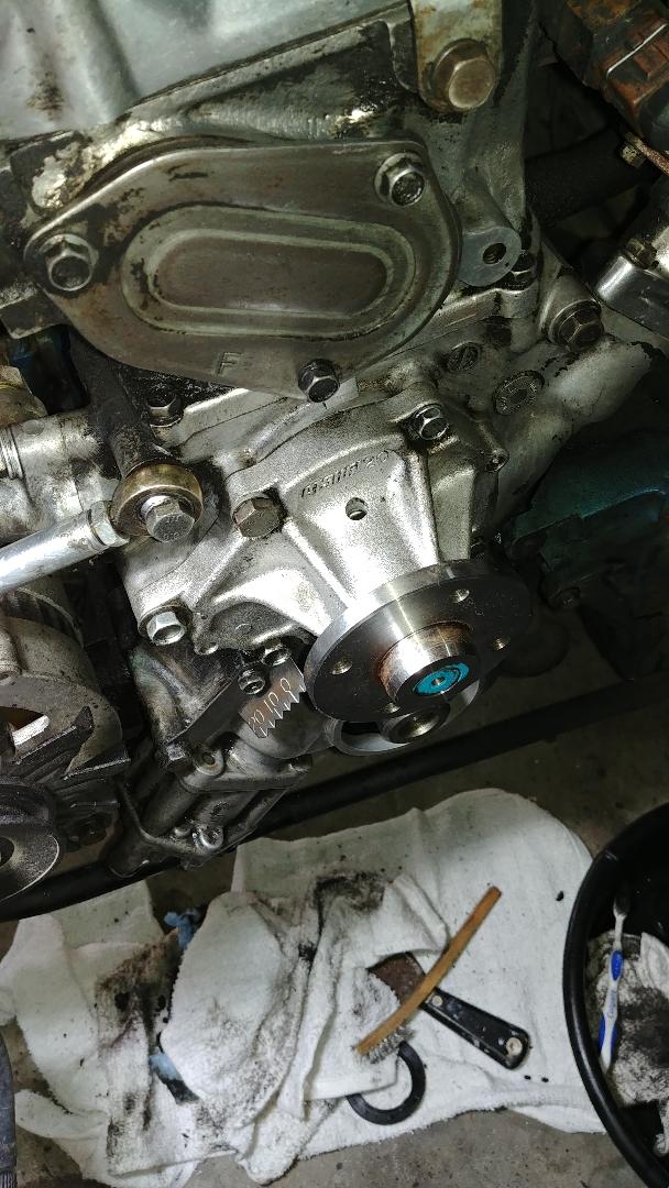

March 2, 20187 yr Author comment_543650 Decided to clean it up a little while I await the parts. Starting to look better. I can actually see my oil pump now. Edited March 2, 20187 yr by rcb280z Link to comment https://www.classiczcars.com/forums/topic/59619-tackling-2-leaks-rad-and-front-main/?&page=2#findComment-543650 Share on other sites More sharing options...
