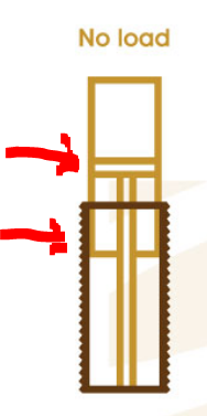

I have FINALLY finished just about everything for my coilover conversion in my 1978 280z with Stance coilovers. I also have TTT control arms. I am at the point of dialing-in the ride height. Stance gave me four 6" threaded sleeves. I had them welded right to the hubs in the front and 3" above the hubs in the back. I was hoping to maintain stock height or maybe 1" lower than stock.   Well after getting everything on and lowering the car, it looks like the front was lowered around 1" and
