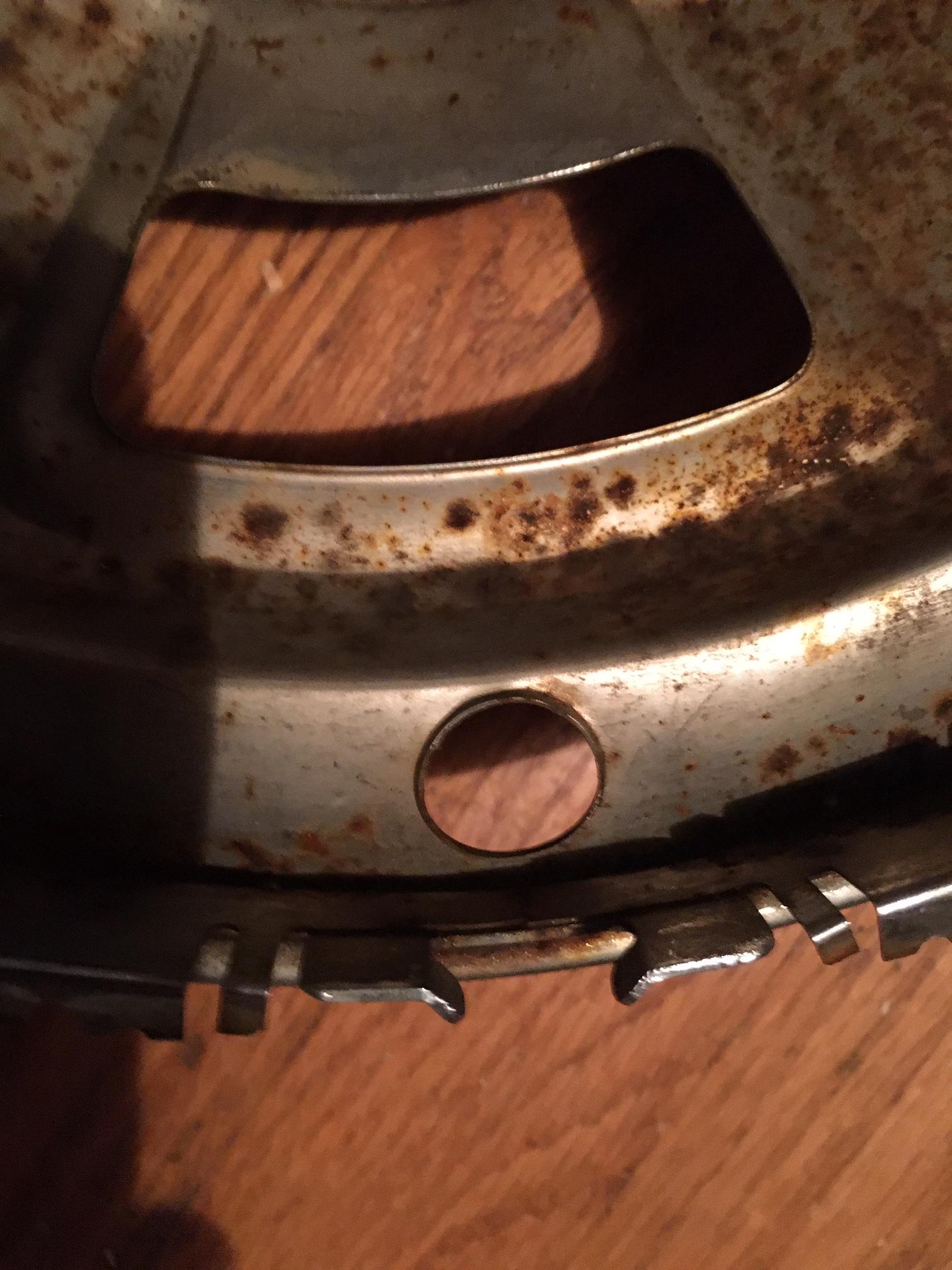

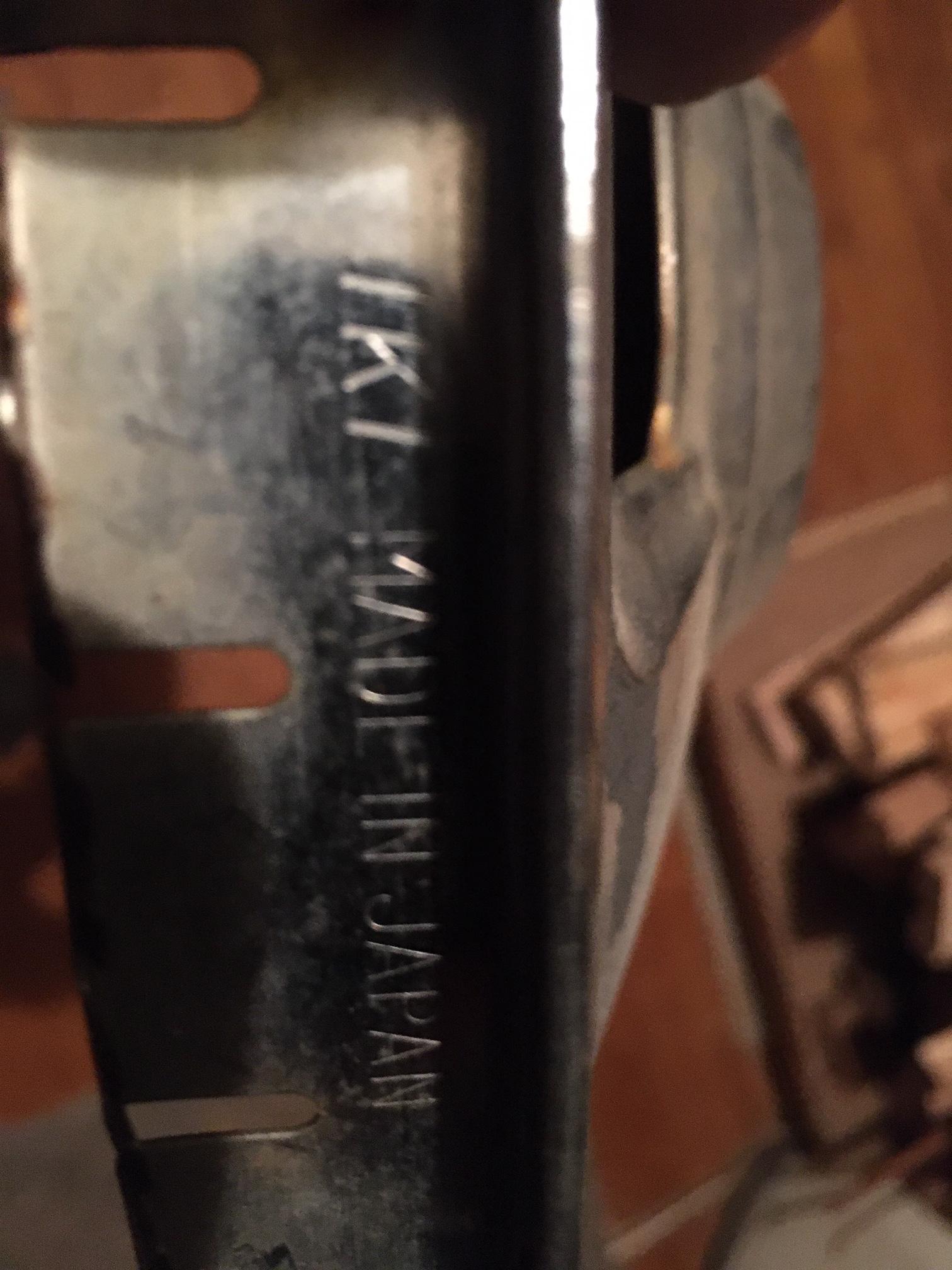

Terrapin Z Posted February 28, 2020 Share #98 Posted February 28, 2020 I have a couple I believe are original, The have the punched valve stem hole like Kats made note of. A makers country of orgin stamping on the side IKI MADE IN JAPAN. Inked markings inside. They are rough I know...... 2 Link to comment Share on other sites More sharing options...

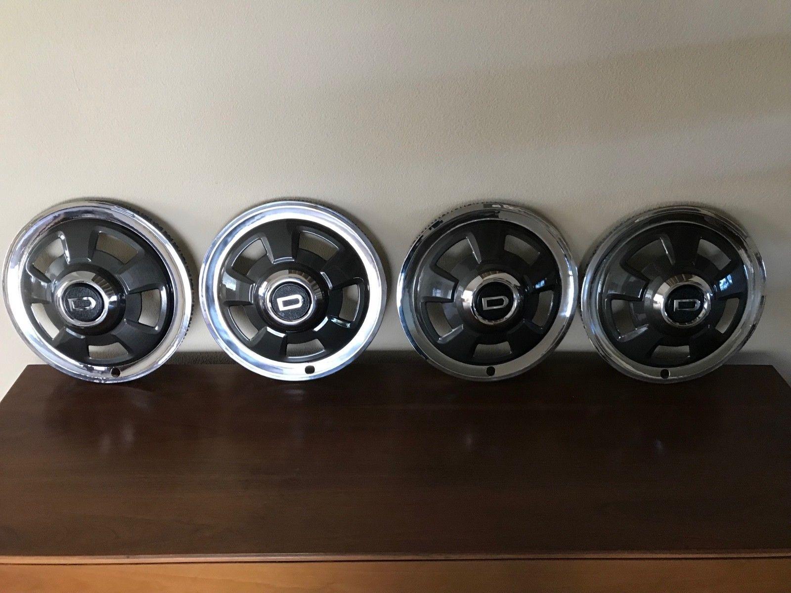

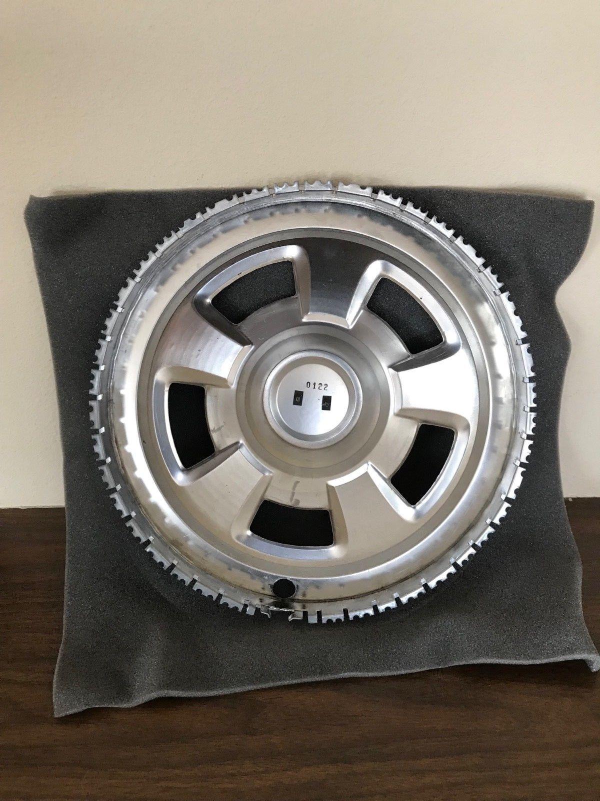

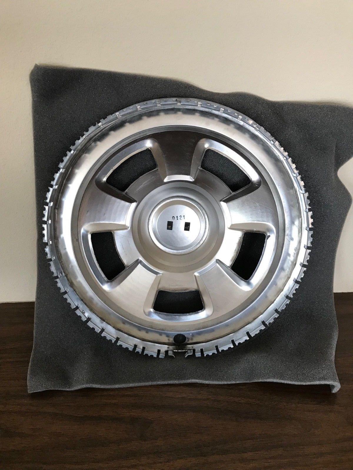

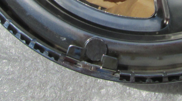

lonetreesteve Posted February 28, 2020 Share #99 Posted February 28, 2020 18 hours ago, 240260280 said: Are they claimed to be original or reproductions? Perhaps ask for a higher resolution photo of this area and we can tell. The photos above are too small to see details. It was like pulling teeth to get the seller to send me these last 3 pictures that are just a little more closer up. I don't see the "IKI Made In Japan" stamped anywhere that Terrapin Z mentioned. The seller also told me that the set of 4 are original. What do you think of these last 3 pictures? 1 Link to comment Share on other sites More sharing options...

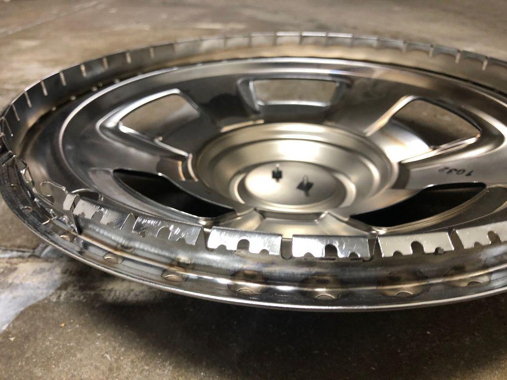

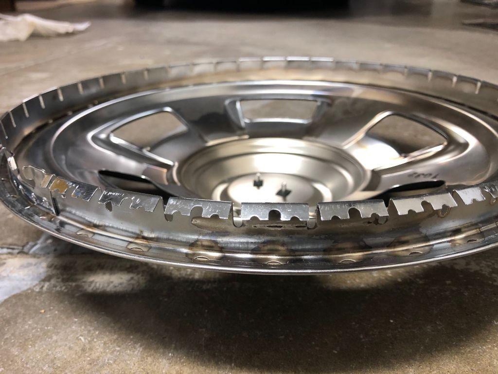

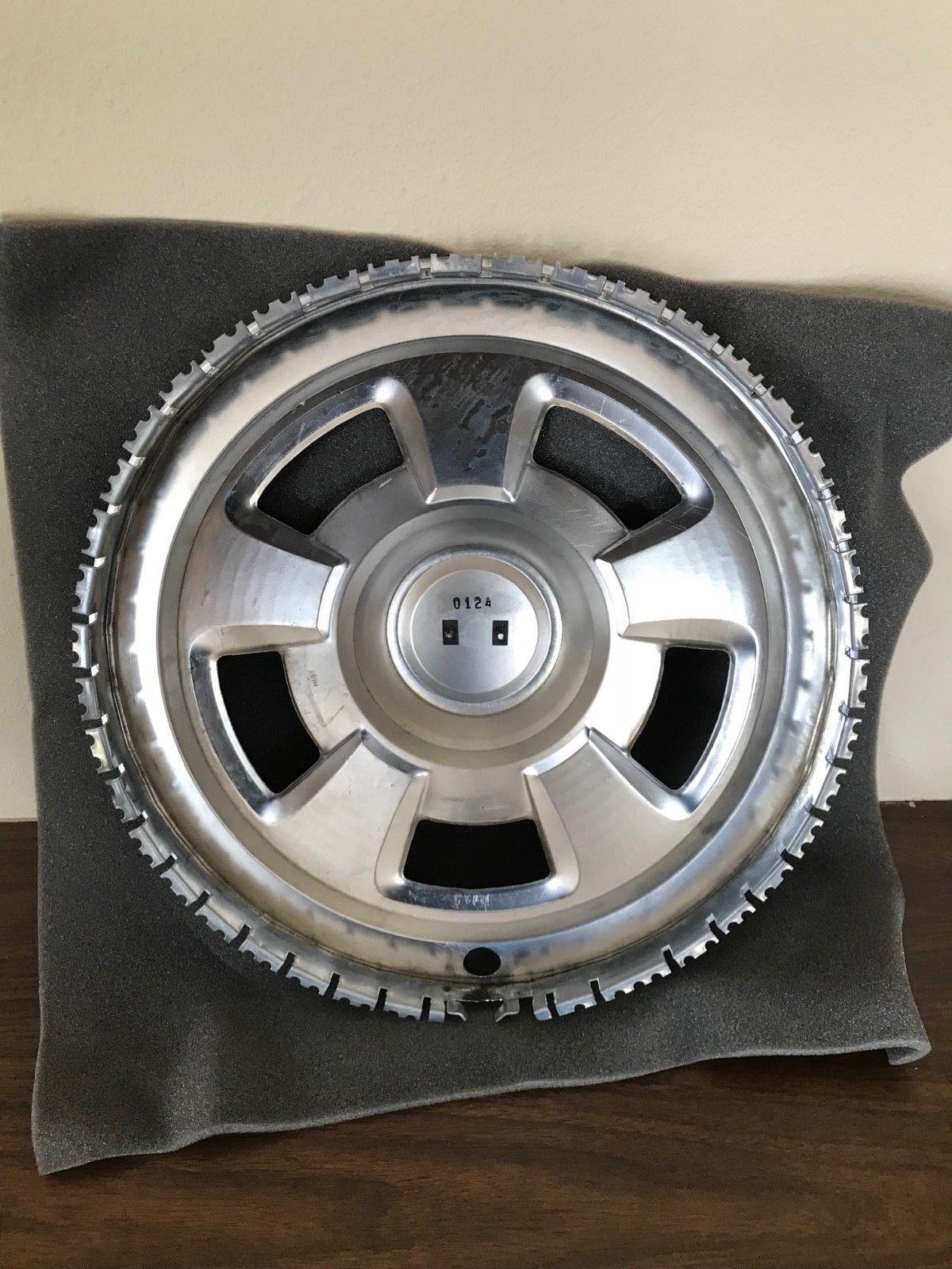

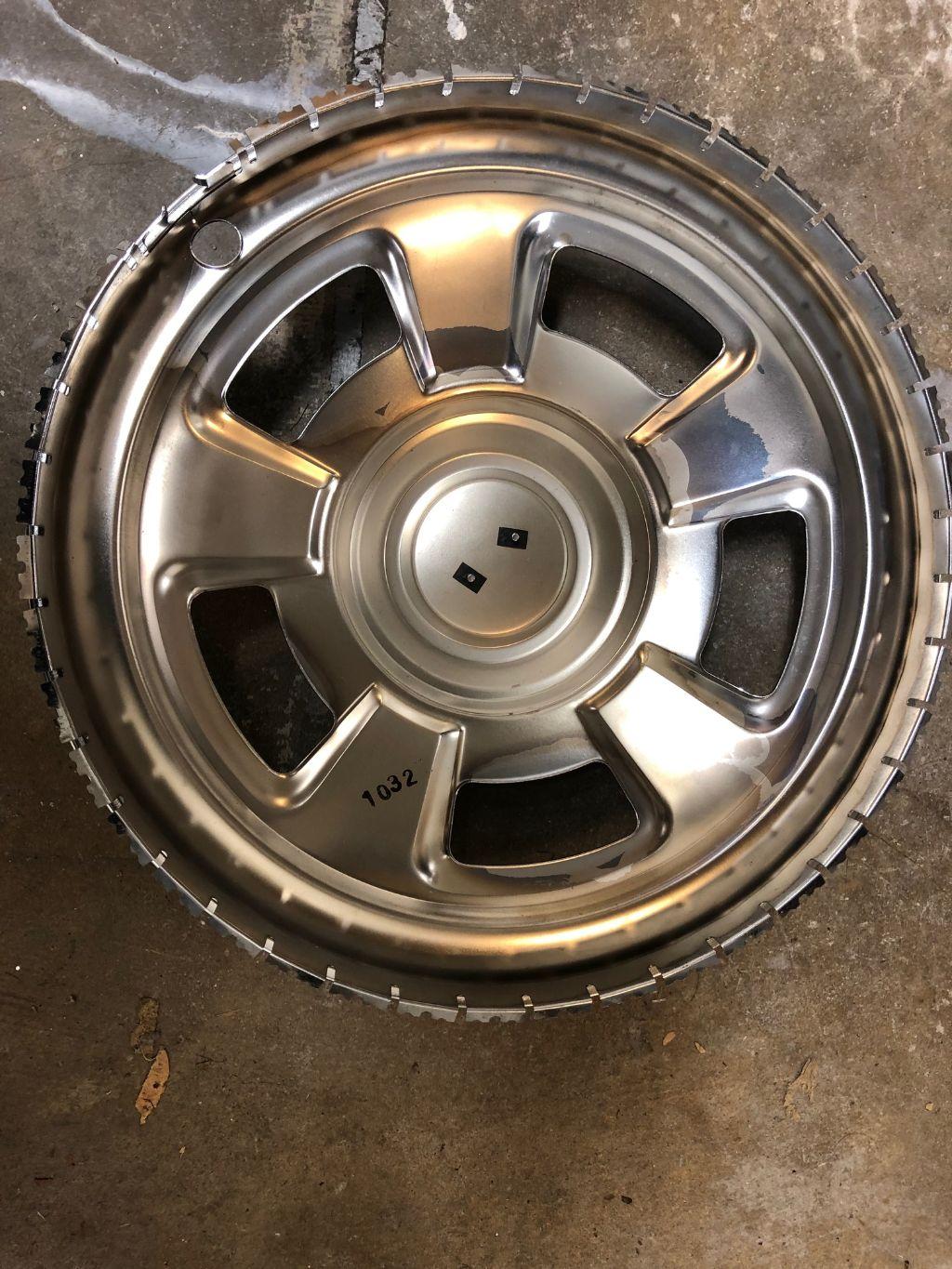

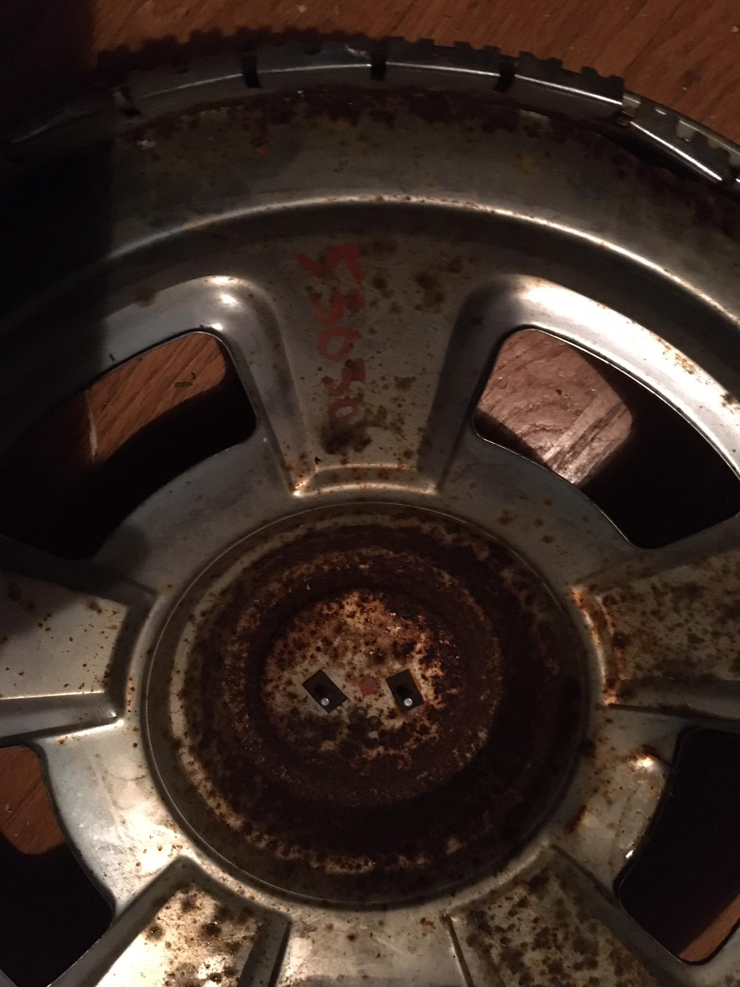

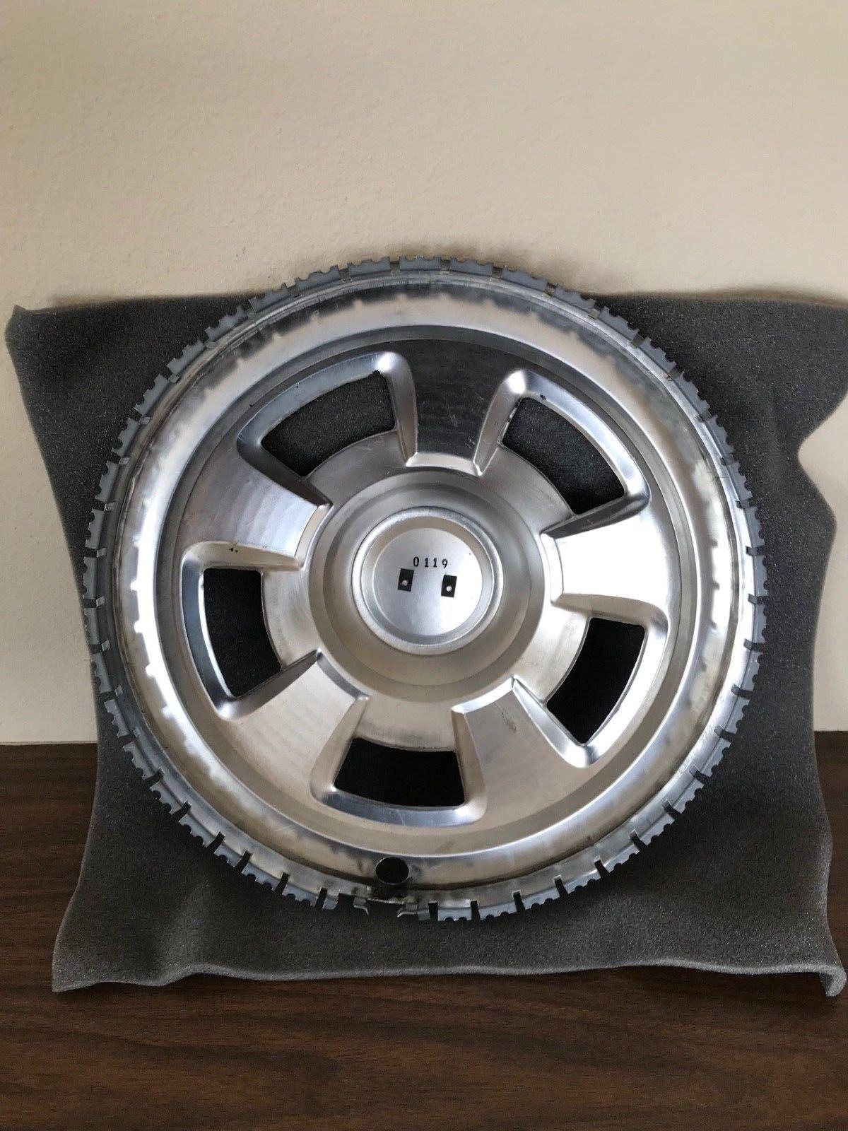

240260280 Posted February 28, 2020 Share #100 Posted February 28, 2020 (edited) The edge fingers at the hole are not like any of the original pictures I have but they do closely match the early poor-quality fakes from 2 years ago but they better match Terrapin originals. I think they are real or a very good reproduction. The IKI stamp and Made in Japan require further exploration. I'll check mine in the garage and get back. Circa 1970 version 1 Circa 1970 version 2 2020 2018 fake Edited February 28, 2020 by 240260280 2 Link to comment Share on other sites More sharing options...
240260280 Posted February 28, 2020 Share #101 Posted February 28, 2020 Feb 2018 fakes: 1 Link to comment Share on other sites More sharing options...
lonetreesteve Posted February 28, 2020 Share #102 Posted February 28, 2020 240260280, Kats and Terrapin Z, Thank you taking the time to post the pictures. After looking over all of the pictures, the D hubcaps that I'm considering look like an updated set of reproduction hubcaps to me. I am looking for an authentic set and this seller hasn't been very forthcoming when I asked him questions. He also has been difficult to work with when I ask him for additional pictures. My gut tells me to back off. 1 Link to comment Share on other sites More sharing options...
Captain Obvious Posted February 28, 2020 Share #103 Posted February 28, 2020 My BS detector goes off loud when I see those too although I don't have any specific tell to point to that is a clear indication they are repros. I do worry that it seems the people who are making these are simply getting better at fixing their mistakes and making the repros harder to distinguish from the original versions. I suspect the chatter here pointing out the differences is allowing them to monitor this thread (and maybe others like it) and use the info within to improve the parts. Double edge sword... Better repros that are virtually indistinguishable from the originals are a good thing. But if they are sold claiming to be NOS parts made by the original manufacturer, it's a lie and should not be allowed. 3 Link to comment Share on other sites More sharing options...
Terrapin Z Posted February 28, 2020 Share #104 Posted February 28, 2020 I agree with those above, I think they are really good reproductions based only on the pic's. "If it looks too good to be true....." Especially if the seller is being elusive. JMHO. 1 Link to comment Share on other sites More sharing options...
