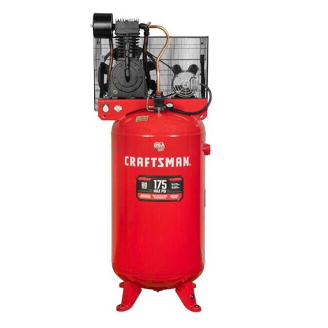

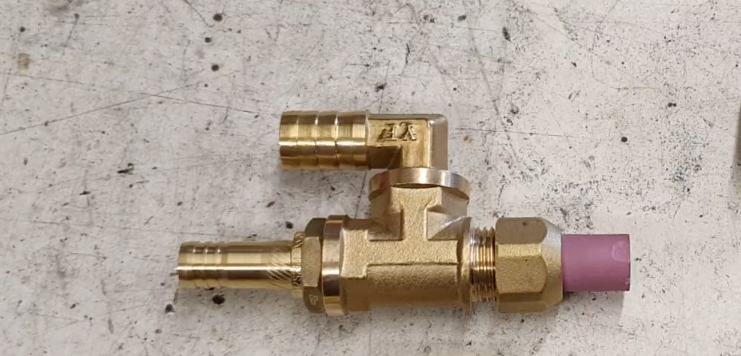

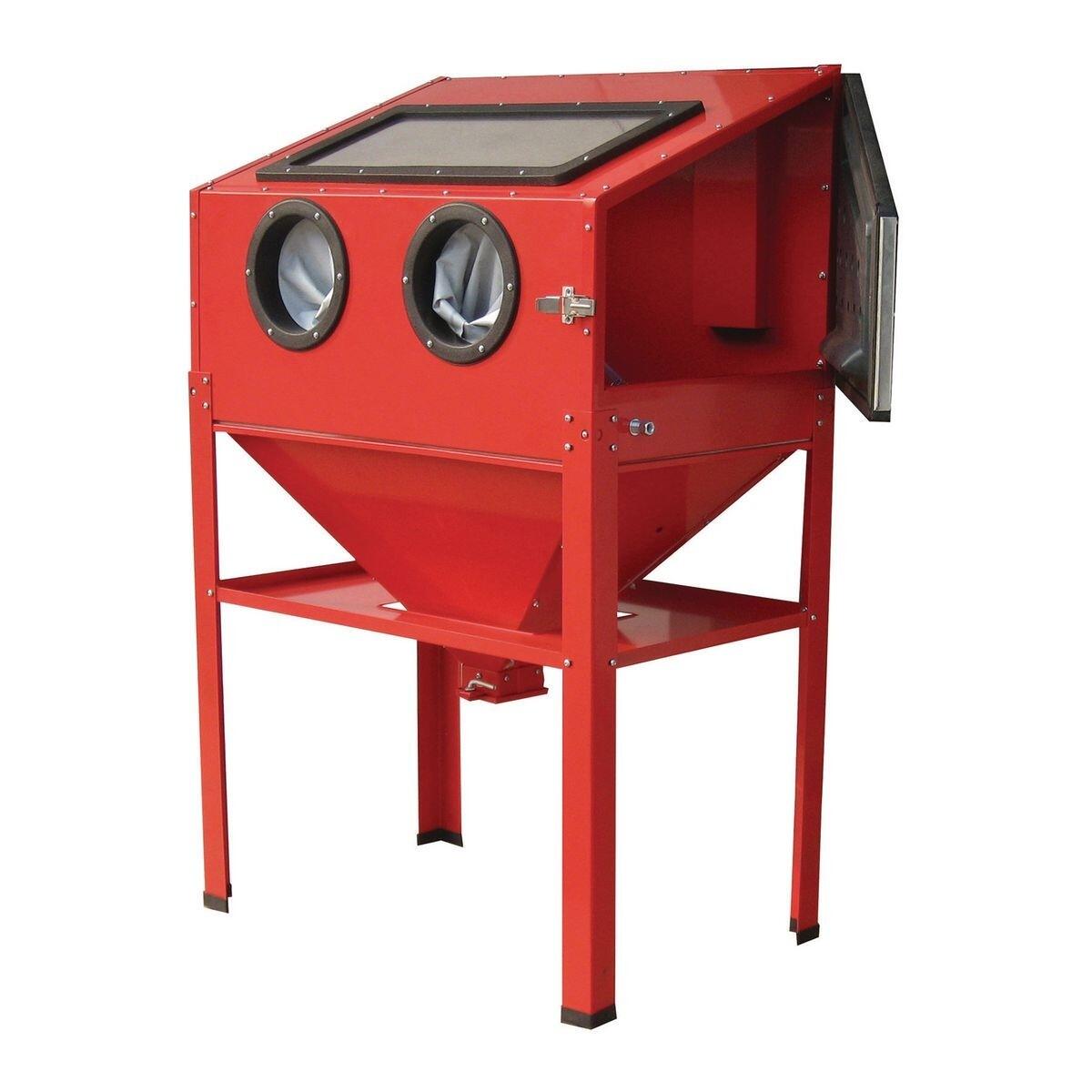

73str86 Posted January 4, 2022 Share #123 Posted January 4, 2022 I'm bringing this thread back from the dead! I've been researching hard for DIY vapor blasters and I am gathering components. I've watched hours and hours of videos and am currently searching for a trash pump. Parts sourced so far: - "Used once" Harbor Freight 40lb sandblasting cabinet - MSRP $199 - scored for $100 on Facebook Marketplace (I wanted to be able to fit an L6 head inside without any problems.) - Brand new, never used Craftsman 80-gallon two-stage air compressor - MSRP $1649 - scored for $700 on Facebook Marketplace - Custom brass vapor blast gun from Armoury Enterprises in New Zealand [3mm aluminum air jet, 8mm ceramic nozzle, 1/2" slurry inlet, 1/2" air inlet] - $70 Need to buy: - Lighting upgrade (Duffy I like your latest choice) - Flexzilla hose (most recommended hose to use by all the builders) / plumbing for air compressor / drier / pedal - Trash pump --------------------------------------------------------------------------- Some findings in my research: - Most youtubers recommend no more than 60psi for vapor blasting aluminum parts. I prefer that clean, polished look. Glass beads #13 Very Fine, not crushed glass. I watched a video where a guy said crushed glass is far more abrasive; he stripped a painted greasy rusty cast iron intake with it. - "Secret" I'm going to try: supposedly turning off air supply completely and letting trash pump push the slurry at ~25psi by itself as a final step will provide the greatest lustre. 2 Link to comment Share on other sites More sharing options...
