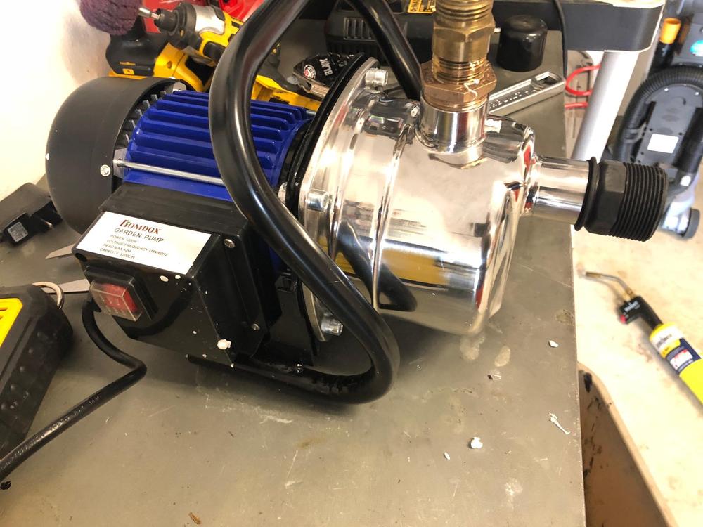

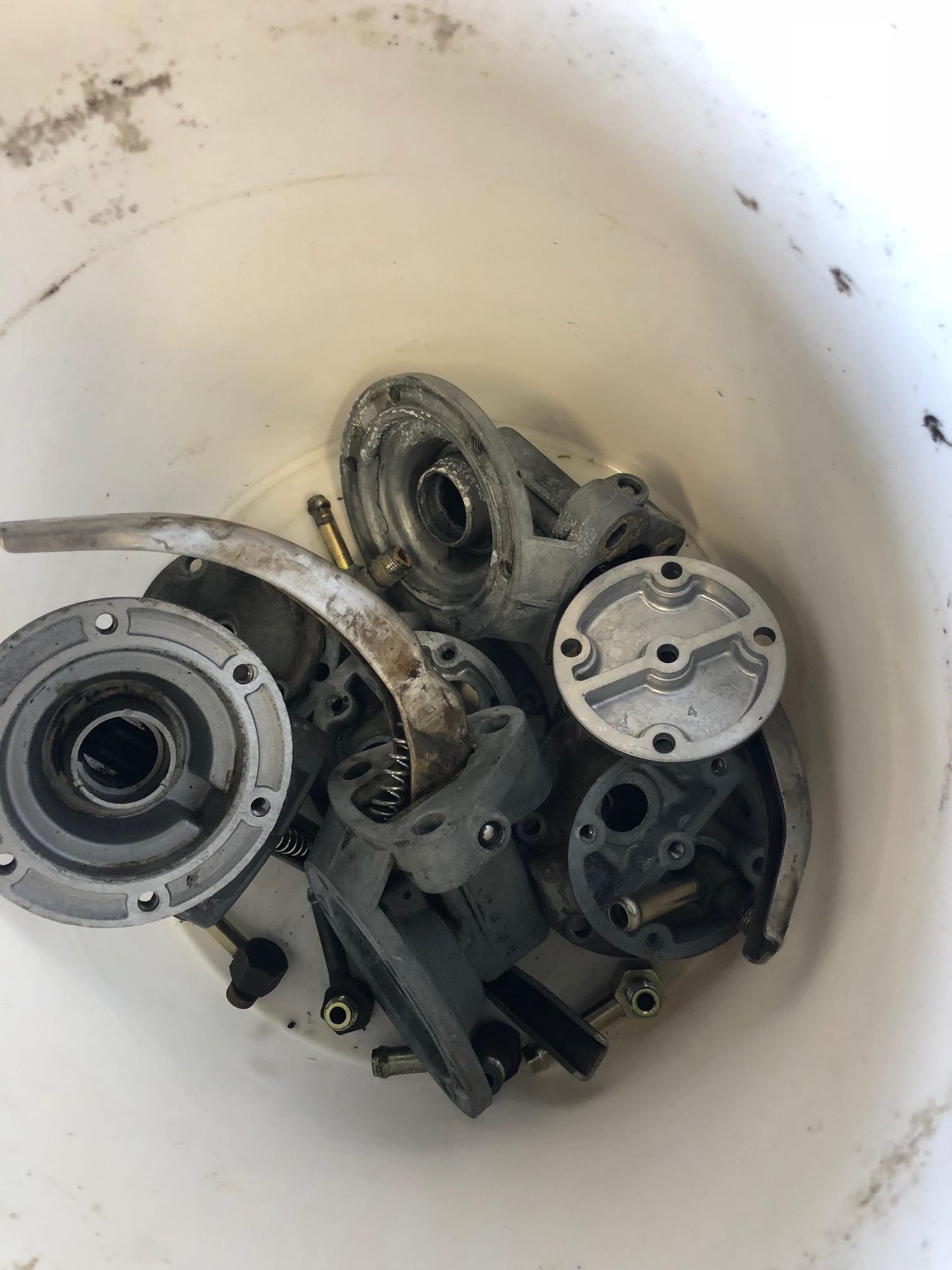

Well I killed my first slurry pump.  It was a 70$ amazon one that is no longer available.  This one looks indentical and has the same stats but I like how easy it is to take apart, I will try to take better care of it and flush it after every use.  I had about 20 hours on the first one.  Also I have 3 nikki fuel pumps to blast and a FET triple intake.  Should be fun!

I deal with pumps for a living. Any high end aerator style bump would be good.
The amazon one I got is about perfect. I have a super high end water one that I could use. It’s just a giant overkill.

Did you look through the link I posted earlier?
There are tons of websites for blasting stuff.  Very little actually has to do with vapor/ water honing or whatever people call it.  I got lucky and the vapor honing guy gave me some secrets.  That's why mine works so well.  Next best thing would be some sort of slurry pre mix machine.  You could go nicer on the pump, but all pumps wear out.  Something that could be rebuilt would be nice.  The reason I picked this pump, is because it's easier to pull apart then my last one.
