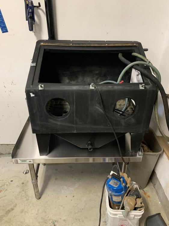

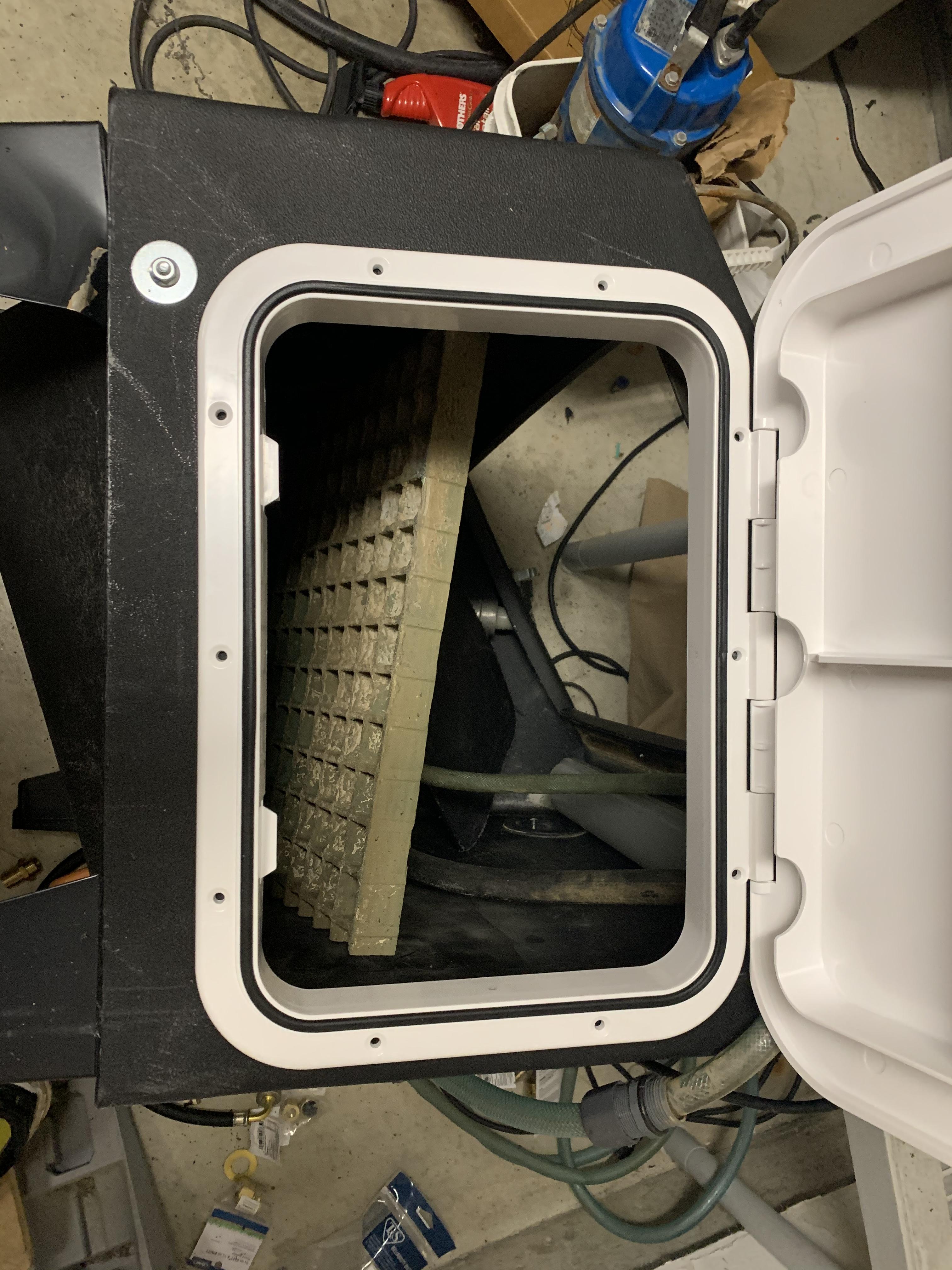

I have been working on some news mods for my rig. I also brought it home for the first time. It’s been at a buddy’s auto shop for a long time.
Mainly fresh water rinse and a access door that isn’t also the viewing. I got some new tempered glass and a stainless stand for it. Rinse is super important to keep media in the cabinet.

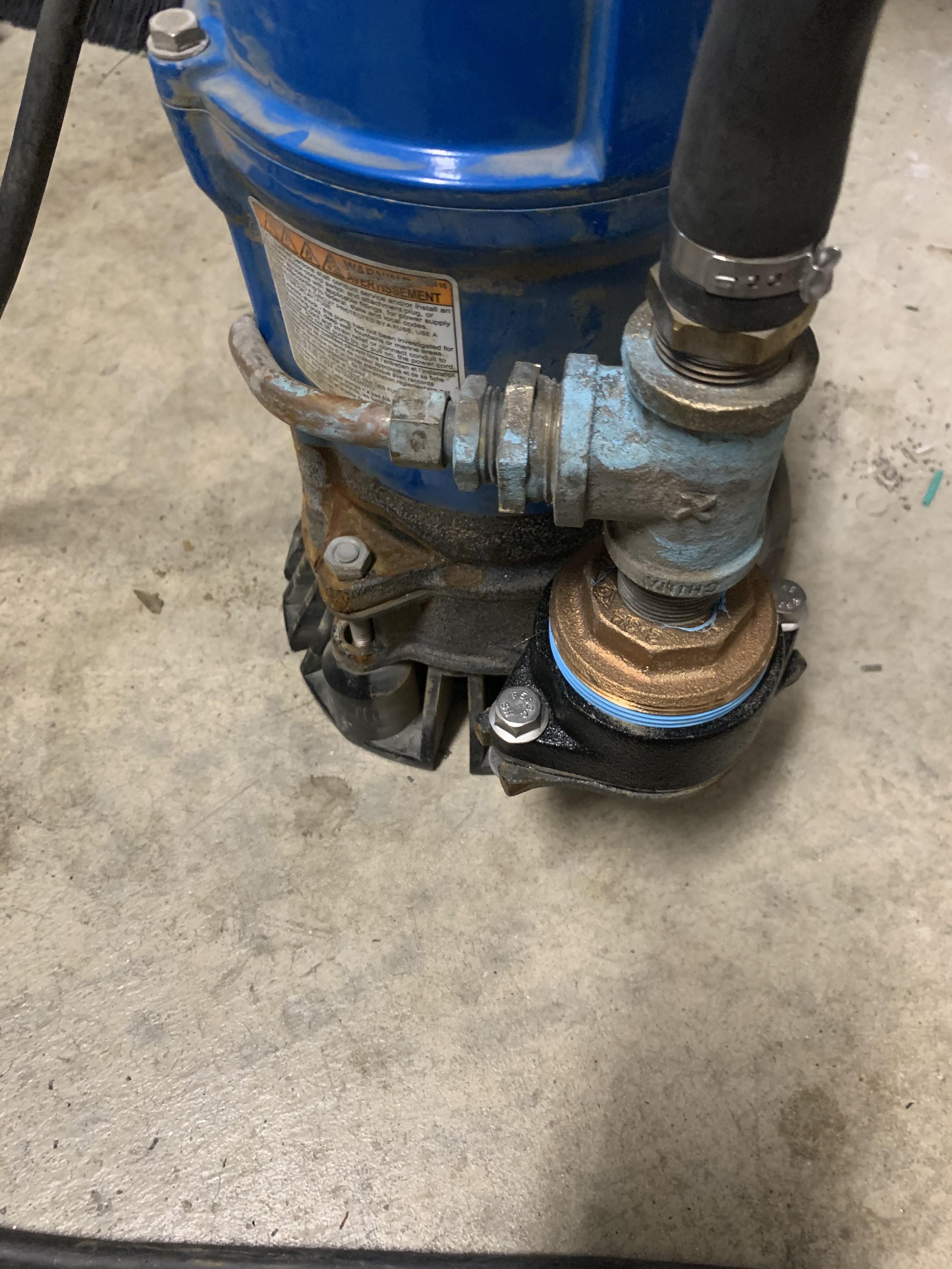

The pump comes stock with a odd 45 degree elbow, which makes it’s hard to fit in a container, so I got a new straight one off their webpage
