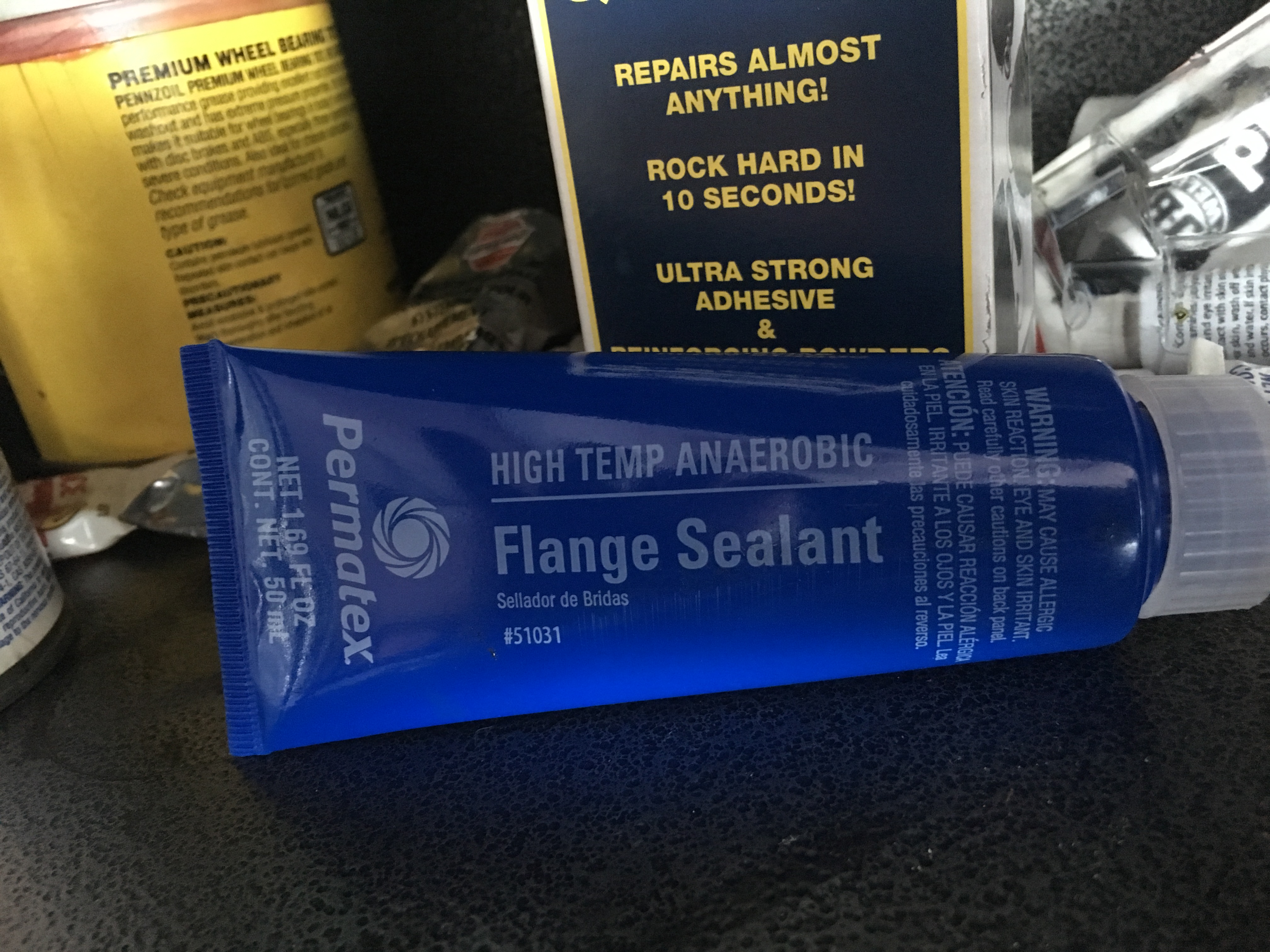

Two questions related to post #18.
Q1: What is a well tested sealant brand and type that you can recommend for sealing the back top corners of timing cover to the head, and for sealing the rear main bearing & side seals.
Q2: Any special way/locations for placing the sealant when doing the rear main (engine rebuild)?
Thanks
Permatex high temp anaerobic flange sealant. This stuff is made for those apps Blue.
