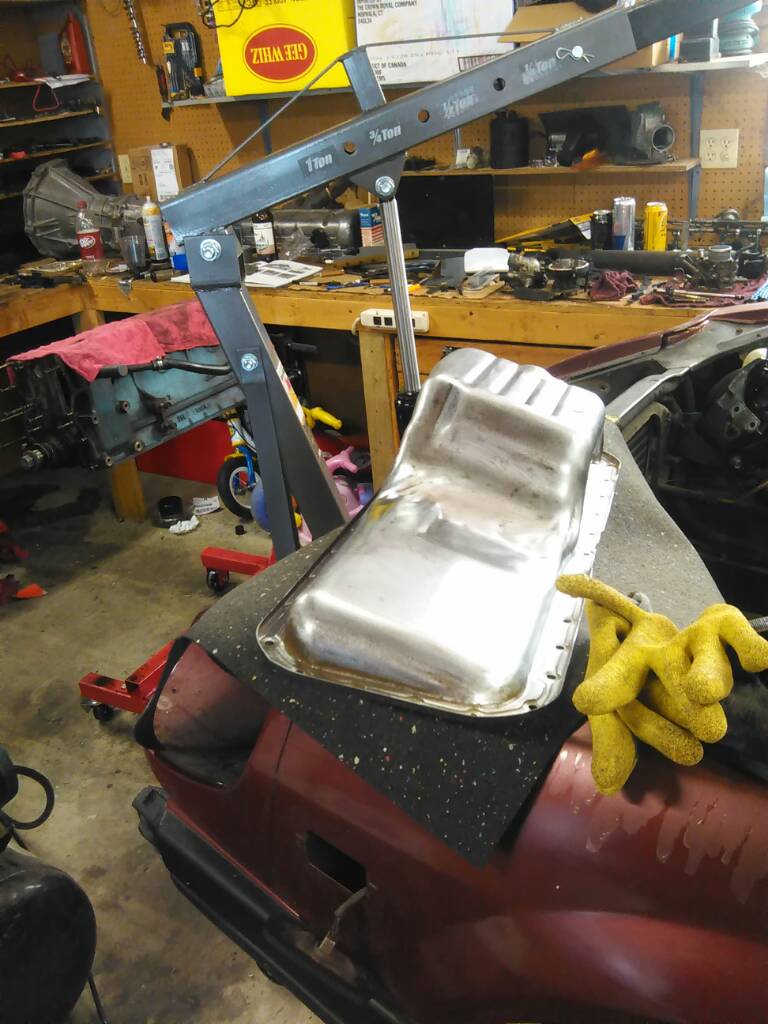

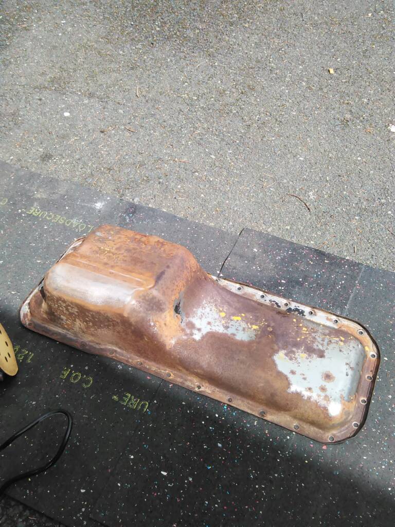

Spent some time cleaning the oil pan up. It was dirtier than shown, I guess I deleted the picture of when it first came off the car. Under a layer of grime was a bit of surface rust.
Its mostly off now. Time for some paint tomorrow-ish. IMG_20180417_114942.jpgIMG_20180418_163404.jpg
