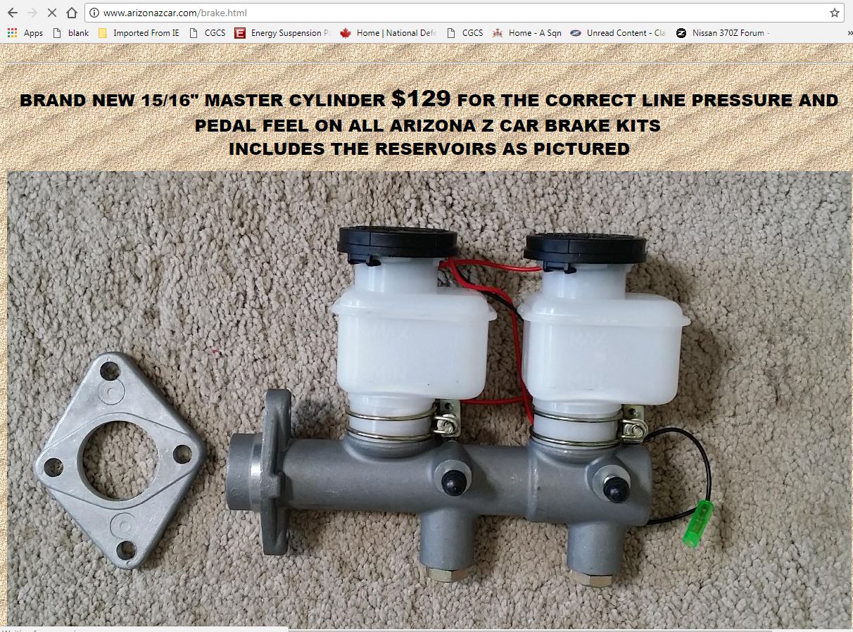

March 19, 20187 yr Author comment_544976 I was planning to buy the 15/16 master from silver mine motors - Seems that they removed it now from their shop. That thing is pretty hard to find. Do you have an address? Or is the one from a later ZX like 83 an one working with an adapter between the master and the booster as the mounting points are turned 90°? I mean the electronics should be changeable for the sensor. Link to comment https://www.classiczcars.com/forums/topic/59700-yes-another-brake-upgrade-thread-vented-front-drums/?&page=2#findComment-544976 Share on other sites More sharing options...
March 19, 20187 yr comment_544990 Buy the one from Arizona Z Car and it comes with caps and reservoirs for $129. I have one from them and it arrived perfect. Edited March 19, 20187 yr by wheee! Link to comment https://www.classiczcars.com/forums/topic/59700-yes-another-brake-upgrade-thread-vented-front-drums/?&page=2#findComment-544990 Share on other sites More sharing options...
March 19, 20187 yr Author comment_544993 Thanks a lot - haven`t seen that. Link to comment https://www.classiczcars.com/forums/topic/59700-yes-another-brake-upgrade-thread-vented-front-drums/?&page=2#findComment-544993 Share on other sites More sharing options...
March 19, 20187 yr comment_545004 34 minutes ago, PrincePaul said: Thanks a lot - haven`t seen that. bitte schön Link to comment https://www.classiczcars.com/forums/topic/59700-yes-another-brake-upgrade-thread-vented-front-drums/?&page=2#findComment-545004 Share on other sites More sharing options...
