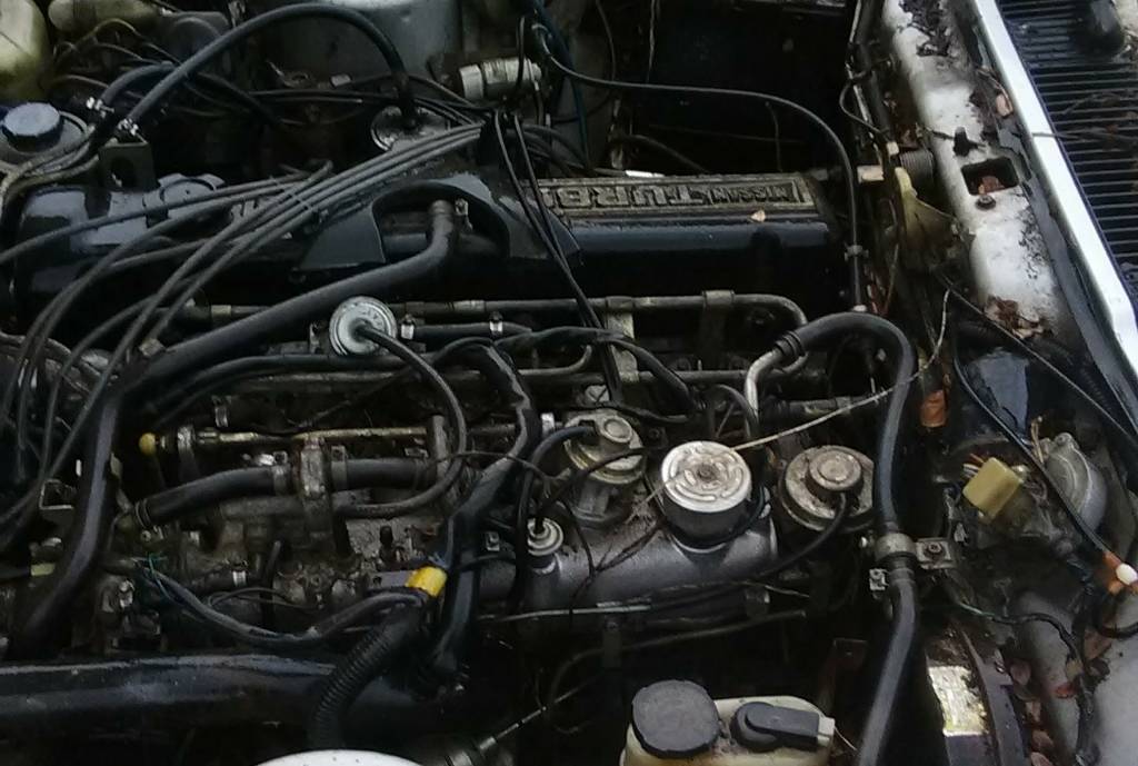

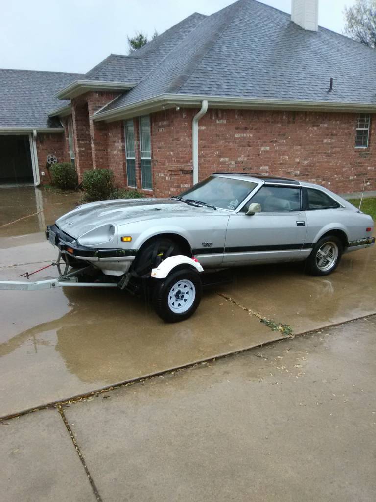

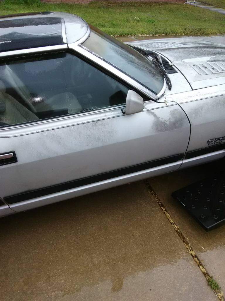

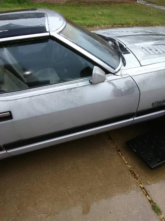

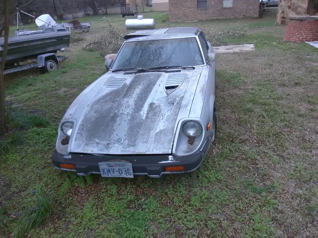

Posted March 22, 20187 yr comment_545380 Hi I just bought this 280zx. the owner let it sit for ten plus years. The interior is shot, the paint needs redone and I've yet to get it running. The fuel pump doesn't seem to be kicking in and the starter is out of there for sure. No oil or gas on plugs. So that's good. Definitely a project. I have no experience with EFI or turbos so I'm trying to learn as much as possible before I start tearing into it. So I have a few questions about suspension upgrades. EFI upgrades and so on. I have yet to find a EFI upgrade that's plug and play for the turbo L28 motor. This is going to be a tear down to chassis and rebuild project. I'm wanting to ad some modern touches to the interior as well. Any advice on parts dealers or pointers of things to be careful about would be greatly appreciated. Sent from my [device_name] using http://Classic Zcar Club mobile Link to comment https://www.classiczcars.com/forums/topic/59751-82-280zx-turbo-22/ Share on other sites More sharing options...
