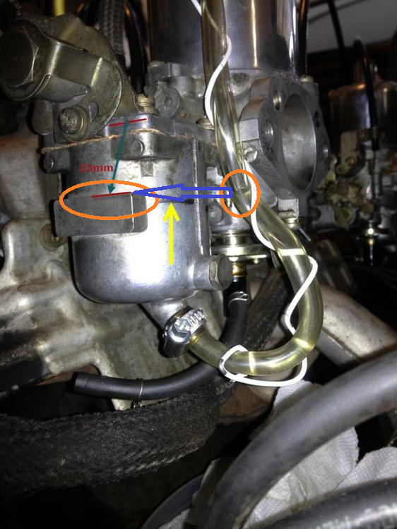

With respect to the carbs, both the SU book and the Haynes manual call for setting the float level by holding the top upside down and measuring the gap between the rim and the lever.  But all the comments here seem to concentrate on measuring the fuel depth in the bowl.  Any particular benefits one way or the other.
I'm no carb expert, but I believe that flipping the lid upside down and measuring the position of the float is to be used as a preliminary "ballpark" setting only. Just to get you "on scale". It only has a little bearing on exactly where the fuel level will end up because the final level is dependent on other factors such as the design of the needle valve.
A direct measurement of the dependent variable is always preferred when compared to an indirect "inferred" relationship. Put simply:
Q - How do you get the fuel level set correctly?
A - Check the fuel level and adjust the float tang accordingly.
So I suggest that the mechanical measurement of the float position with the lid upside down is a good way to start, but after you have done that (just once), you should always refer to a direct measurement using the clear tube method after that.
If you get lucky and happen to hit the target level on the first try using only that mechanical method, then that's excellent! But just don't count on it!
The newer needle valves won't support the weight of the float when you turn the lid upside down.  Find something .55" and blow through the fuel inlet on the lid pushing up on the float until it stops your breathe.  When it stops your breathe the top of the float should be .55" from the lid.
I do this with the lids upright, in front of a mirror.
Yes, this is a ballpark, first step thing.  I used the clear tube off the very bottom like in this picture.
Edited by siteunseen
