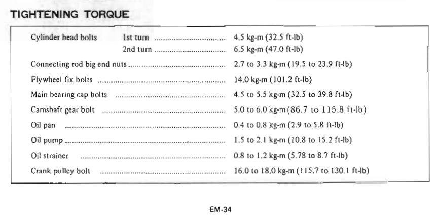

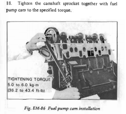

Going through the various on-line FSM pdf files for the various years this morning, and sure enough, at least the 71 and 72 manuals list the "camshaft gear bolt" torque as 36-43 ft-lbs. The 73 manual if finally correct at 86-116 ft/lb
Holy "engine destroyer" batman....
Edited by zKars
Confirmed by an alternate source:
Page 24 in How to Rebuild Your Nissan/Datsun OHC Engine by Tom Monroe states --
Torque the cam-sprocket bolt 86-116 ft-lb (12-16 kg-m).
