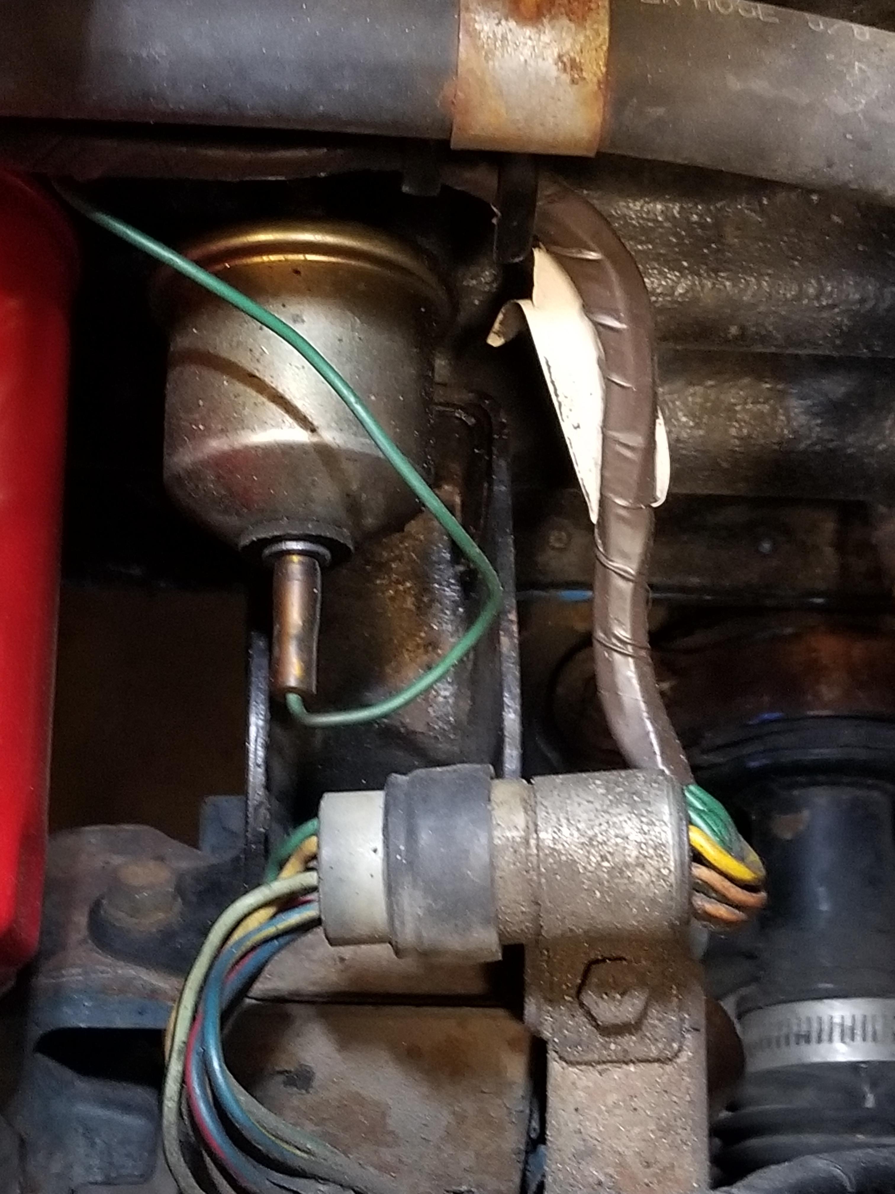

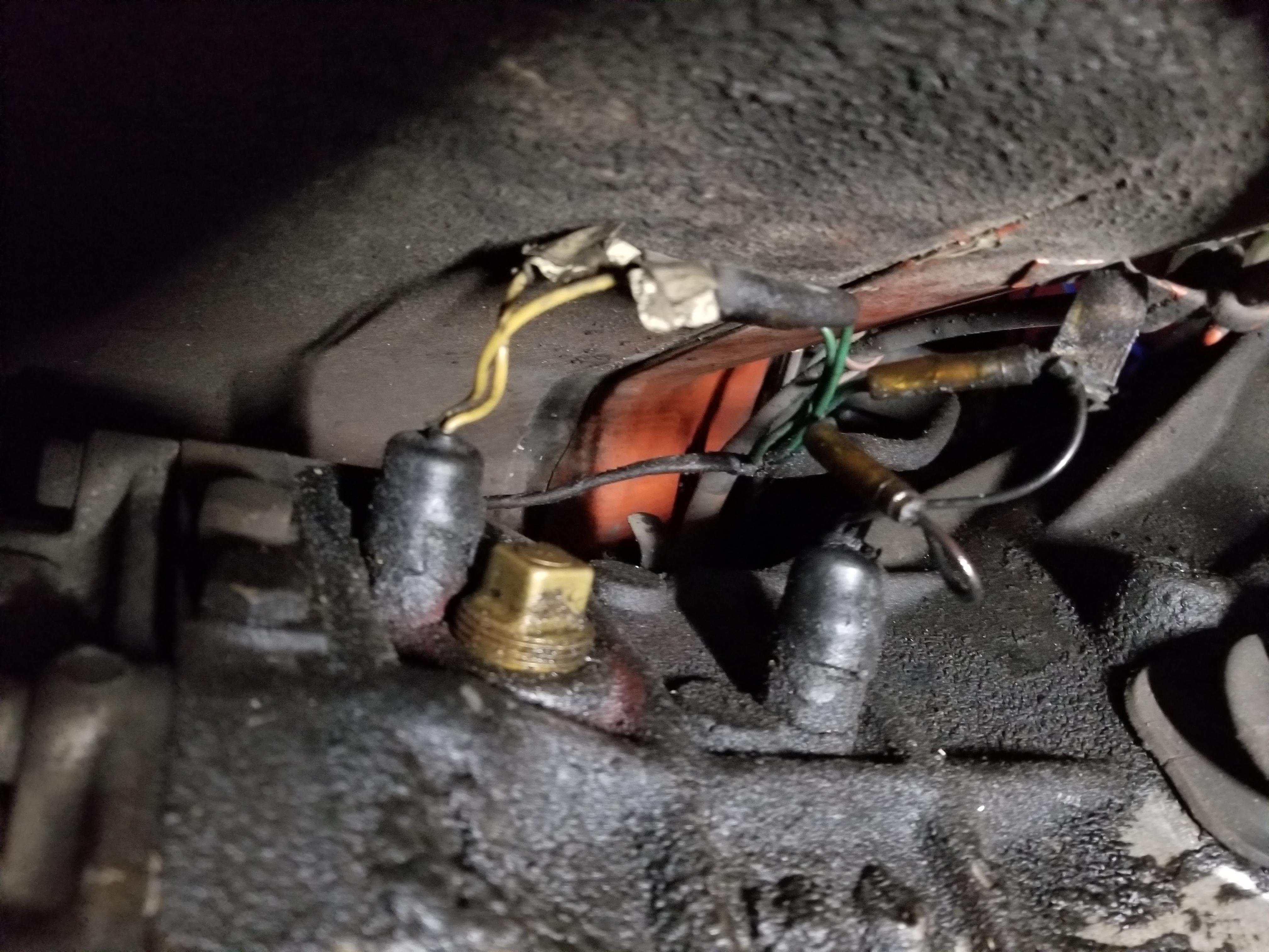

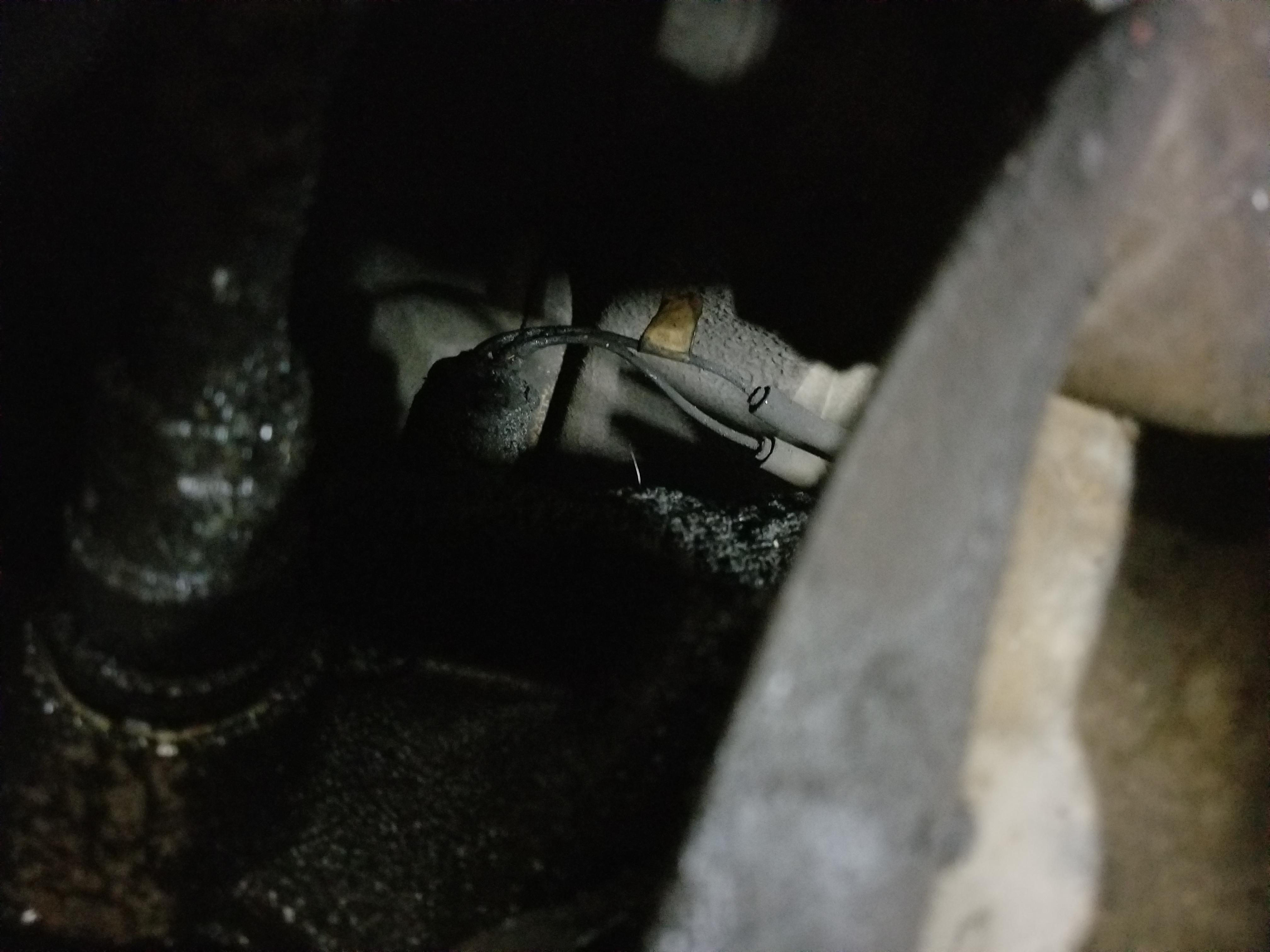

April 30, 20186 yr Author comment_548314 finally put the 280z on jack stands for the swap now that the trans and differential have been sealed with new gaskets, seals and O-rings. I noticed that the 4 speed has 3 electrical connectors were the 5 speed only has one? I assume backup lights, maybe reverse lockout, not sure the other. Since I only have one connector on the 5 speed what should be done with the others? Thanks. Link to comment https://www.classiczcars.com/forums/topic/59810-5-speed-swap/?&page=3#findComment-548314 Share on other sites More sharing options...
April 30, 20186 yr comment_548315 On my 4 speed I only had the reverse light switch. I can't recall any other electrical connectors. Maybe an auto would have a neutral but you are going from a 4speed. Maybe a pic of the old 4 speed would be a clue. Are you seeing maybe a wire that goes to a cat converter? that is in the area of the trans. Edited April 30, 20186 yr by Dave WM Link to comment https://www.classiczcars.com/forums/topic/59810-5-speed-swap/?&page=3#findComment-548315 Share on other sites More sharing options...

April 30, 20186 yr Author comment_548318 One connector by the speedo and the second pic has 2. Link to comment https://www.classiczcars.com/forums/topic/59810-5-speed-swap/?&page=3#findComment-548318 Share on other sites More sharing options...
April 30, 20186 yr Author comment_548320 And they all run to this connector under the hood. Link to comment https://www.classiczcars.com/forums/topic/59810-5-speed-swap/?&page=3#findComment-548320 Share on other sites More sharing options...
