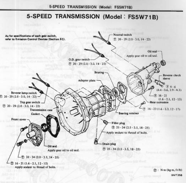

May 1, 20186 yr comment_548435 Neutral/4th gear/reverse light. Its detailed in the FSM, the only one you need is the reverse light switch. I am pretty sure the neutral is for the interlock mech that keeps the car from starting unless everyone is seated and buckled up. I got tired of reading it. the 4th gear switch maybe something with the ign advance. did not see it on 1st pass of the FSM. I did not see it in my online copy but was in the hard copy book I have. Edited May 1, 20186 yr by Dave WM Link to comment https://www.classiczcars.com/forums/topic/59810-5-speed-swap/?&page=6#findComment-548435 Share on other sites More sharing options...
May 1, 20186 yr comment_548438 Nobody wants to look at the picture?Ā It's a big one.Ā Or just set their meter up to beep and put the transmission in reverse? Just curious what's going on here.Ā Am I missing something? Link to comment https://www.classiczcars.com/forums/topic/59810-5-speed-swap/?&page=6#findComment-548438 Share on other sites More sharing options...
May 1, 20186 yr comment_548439 I looked for it on the on line fsm, talk about it in the BE-104 but no pic, I could see it on my hard copy FSM. Link to comment https://www.classiczcars.com/forums/topic/59810-5-speed-swap/?&page=6#findComment-548439 Share on other sites More sharing options...
May 1, 20186 yr comment_548440 found it figure BE154 in the body electrical section under discussion about the interlock. pretty sure a "buck up" is supposed to read "back up". Ā trans.pdf Edited May 1, 20186 yr by Dave WM Link to comment https://www.classiczcars.com/forums/topic/59810-5-speed-swap/?&page=6#findComment-548440 Share on other sites More sharing options...
May 1, 20186 yr comment_548442 It's in the 1983 MT chapter.Ā Word. Link to comment https://www.classiczcars.com/forums/topic/59810-5-speed-swap/?&page=6#findComment-548442 Share on other sites More sharing options...
May 1, 20186 yr comment_548444 4 minutes ago, Zed Head said: It's in the 1983 MT chapter.Ā Word. wow top gear AND OD gear switch. lots of switches on some of those. Doc1.docx Doc1.docx Link to comment https://www.classiczcars.com/forums/topic/59810-5-speed-swap/?&page=6#findComment-548444 Share on other sites More sharing options...
May 1, 20186 yr comment_548450 I was thinking this one might be enough. Link to comment https://www.classiczcars.com/forums/topic/59810-5-speed-swap/?&page=6#findComment-548450 Share on other sites More sharing options...
May 1, 20186 yr Author comment_548456 Yep the 83 5 speed only has the backup light switch. Not like the 4 speed with 3. I'm only going to hook up the backup light switch during installation as that all the new trans has. Ā Link to comment https://www.classiczcars.com/forums/topic/59810-5-speed-swap/?&page=6#findComment-548456 Share on other sites More sharing options...
