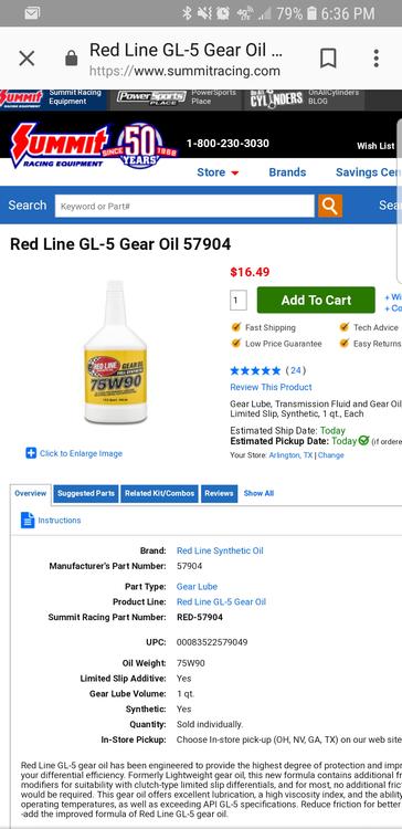

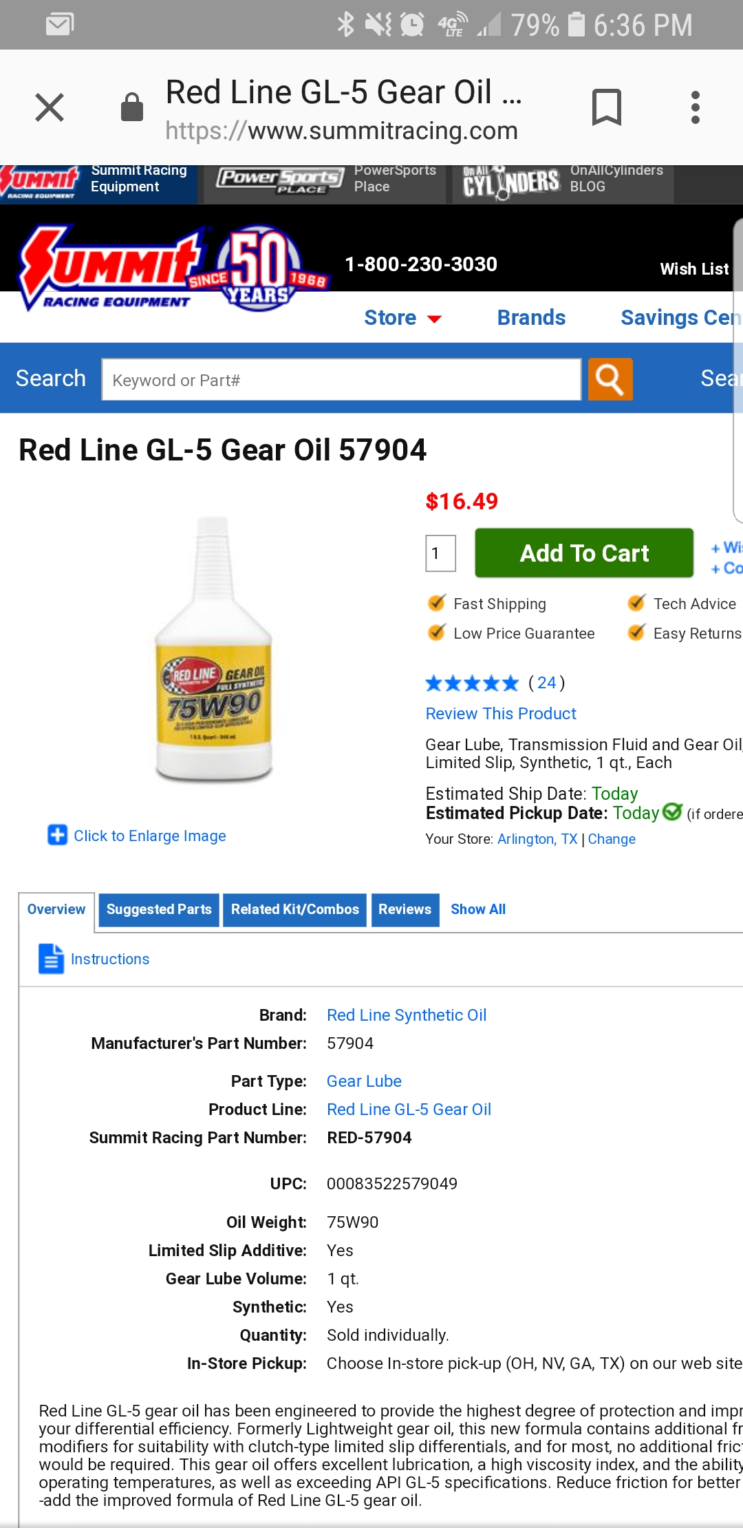

I'll get the redline GL5 (57904)

Darn it.  I got your diff confused with your transmission.  Diff fluid is easy.  GL-5 is fine, just make sure it's for differentials.
This is for your transmission:
(Edit - I wrote all of this because I'm using a GL-5 in my transmission and it's been fine.  Swepco 201).  But that's a whole other story)  There is a ton of stuff out on the internet about "GL-5" and "yellow metals" and mass destruction.  Probably all derived from one guy whose transmission had problems after he changed transmission fluids.  I've only seen one story from the person who actually had problems, and he was in the middle of a race.  I think that the real bad actors are the extreme pressure (EP) additives used in differential fluids.  The GL-5 spec. is just a specification and tells nothing about what's in the fluid.  It's a red herring.
Just get this MT-90.  It's the one everyone uses.  It's GL-4 and it works great.

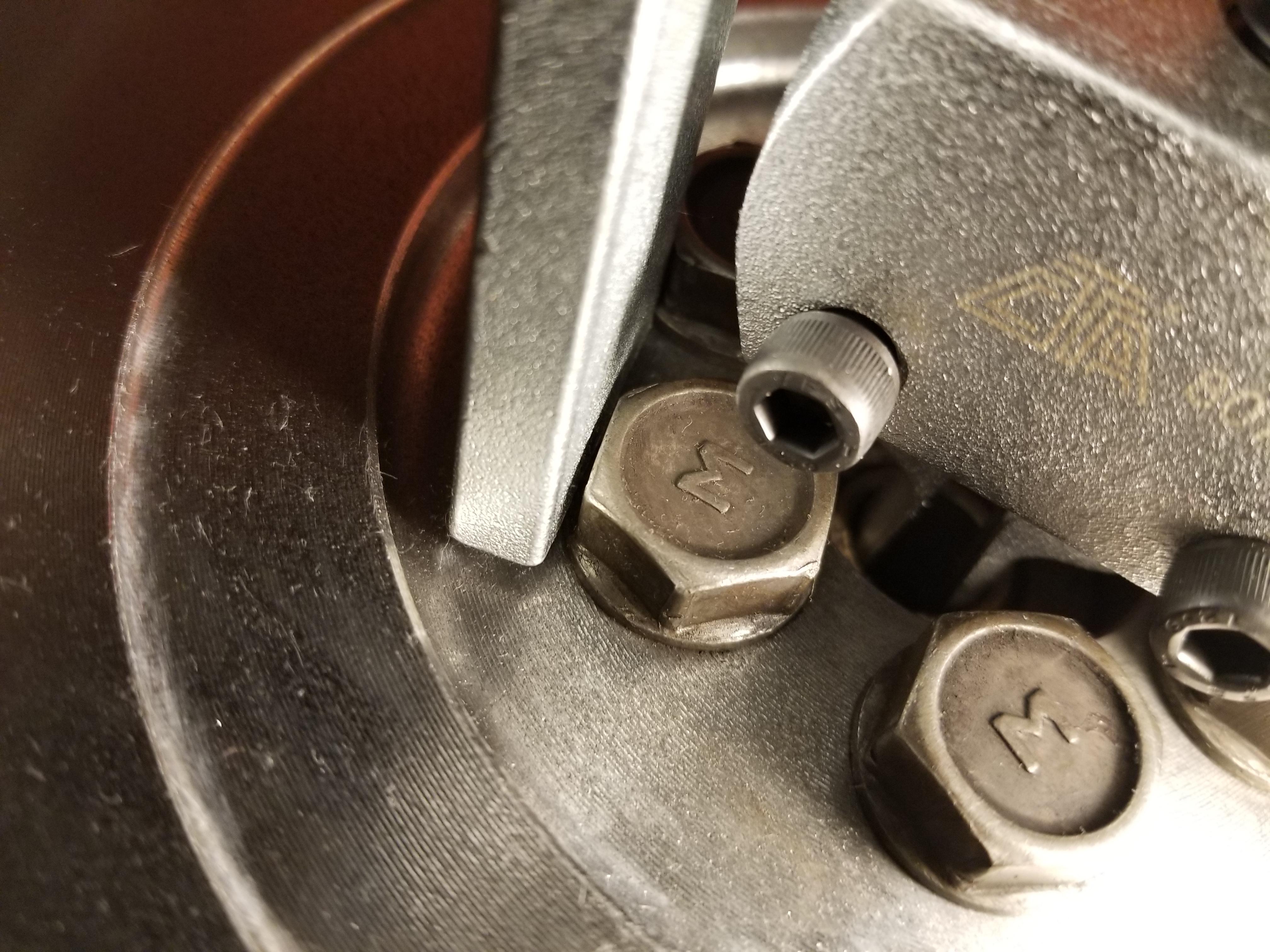

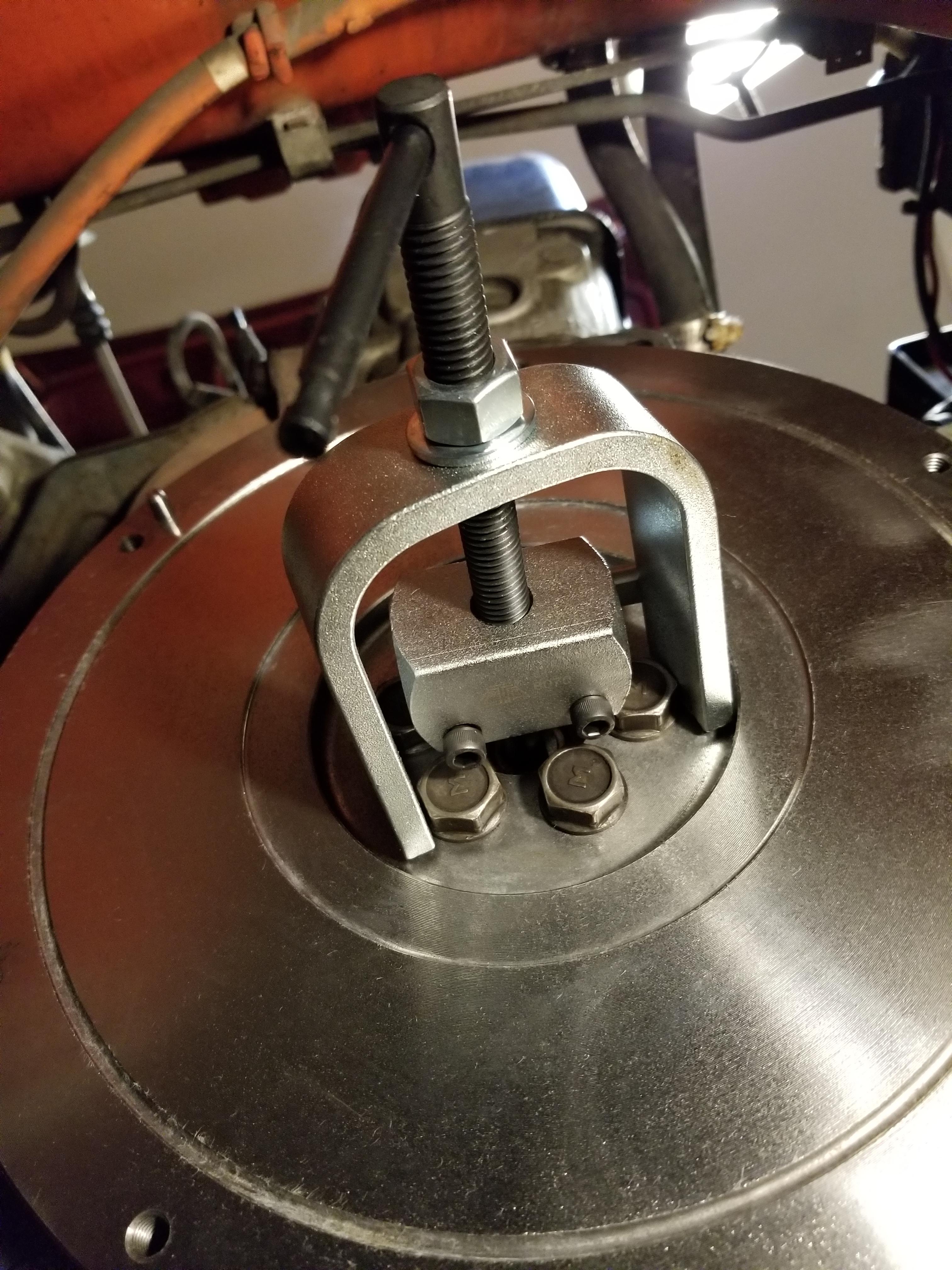

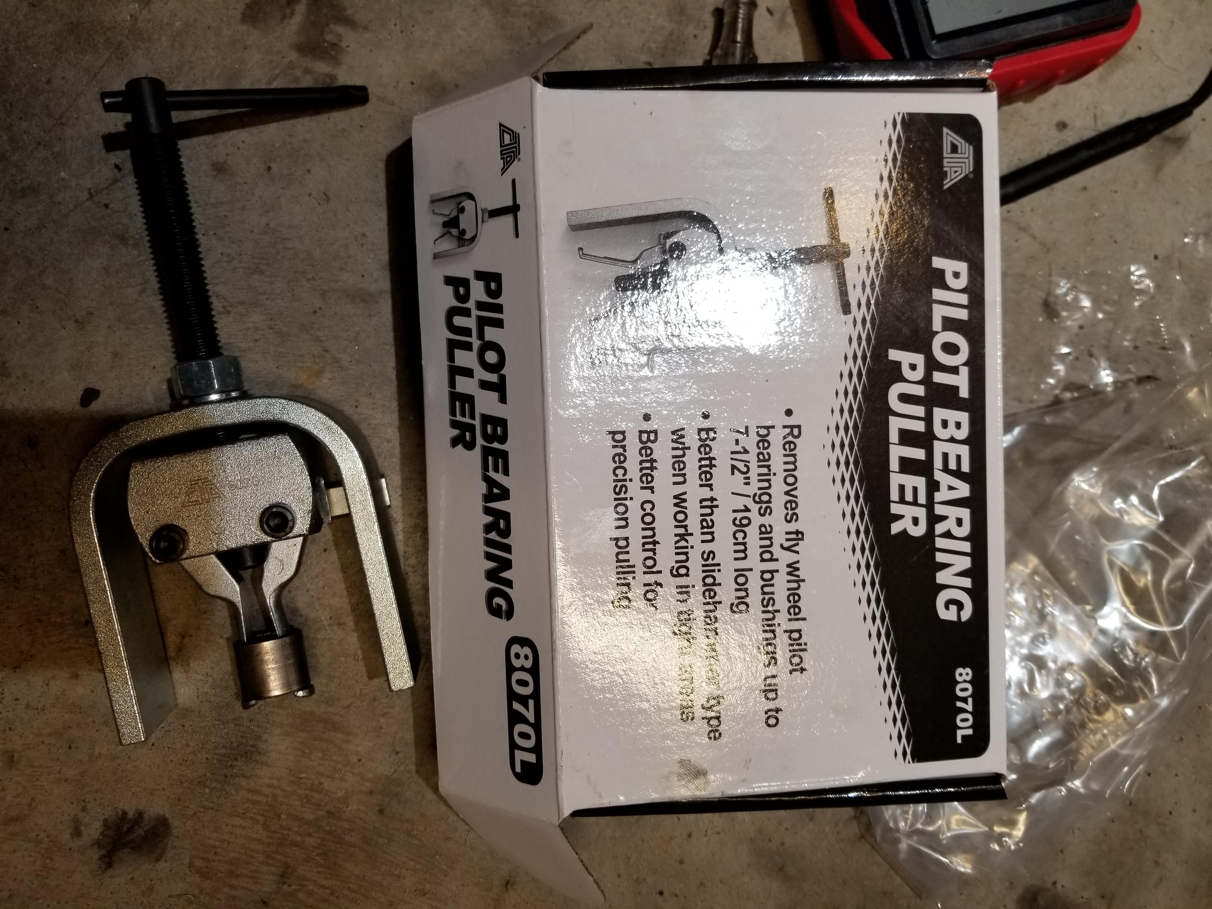

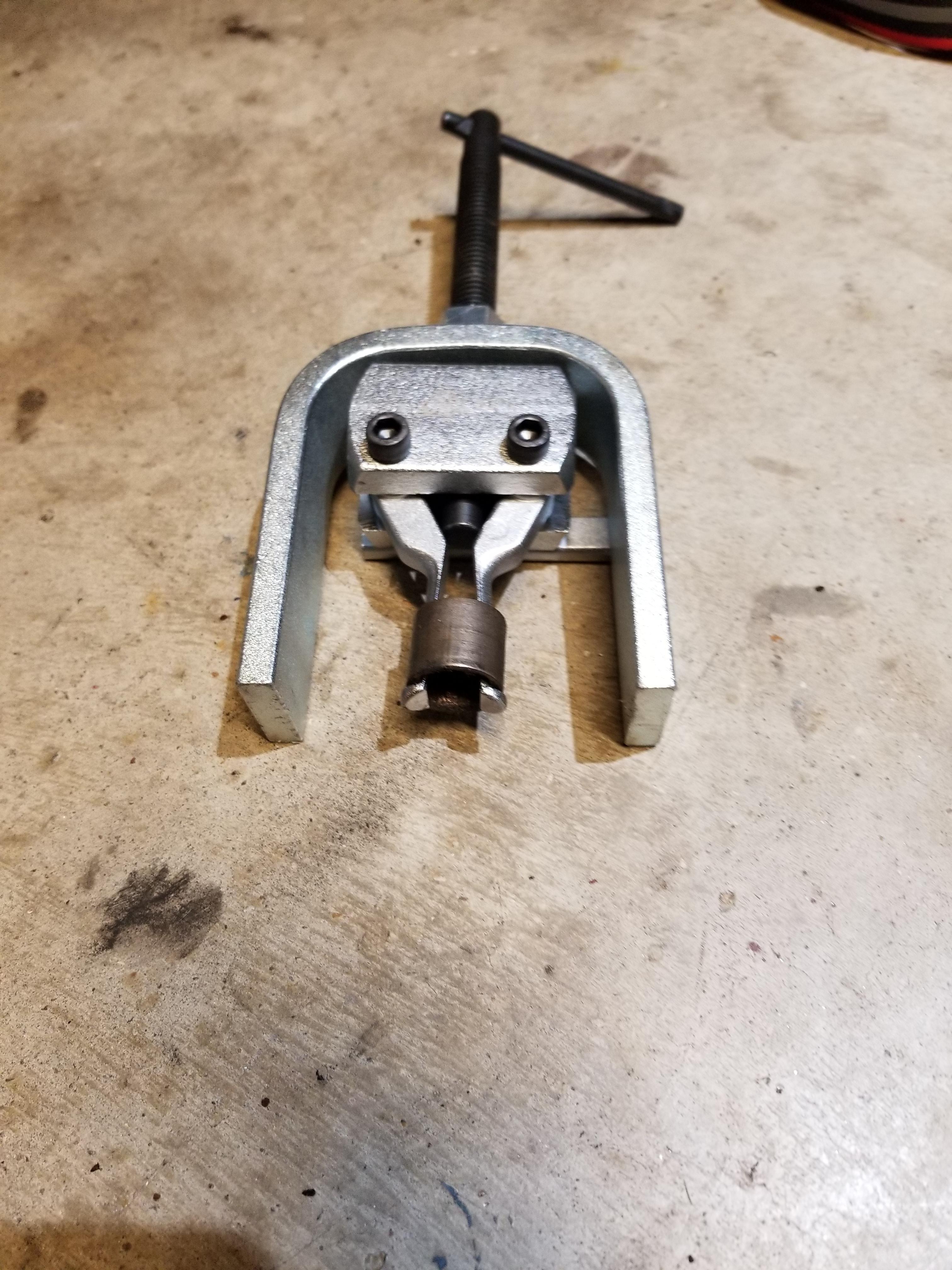

I thought I'd mention the removal of my pilot bearing.
Tried the grease and dowel method but after 43 years it wasn't coming out.
Ended up renting a puller from autozone.
The pics of the puller on the flywheel are for reference only. When I made the actual pull it was against the crank only.
